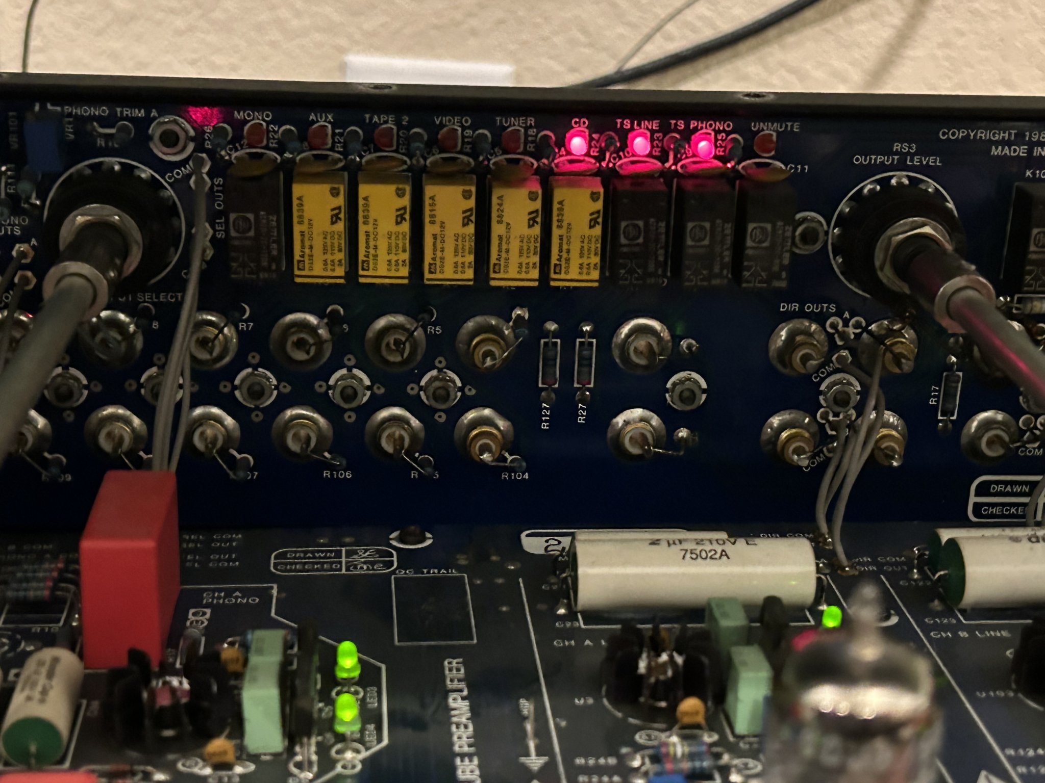

I could not find a K6 LED with my own eyes or in the Service & Owner's manuals. Not sure if it has a different number. That said, I did hear a relay click for all the input stage settings and the tape send settings. The phono/input/Tape 1 selection knob is seperate and goes thru a long shaft to a pot on the back PCB board and does not seem to have an associated relays or if it does have them I can't find it.

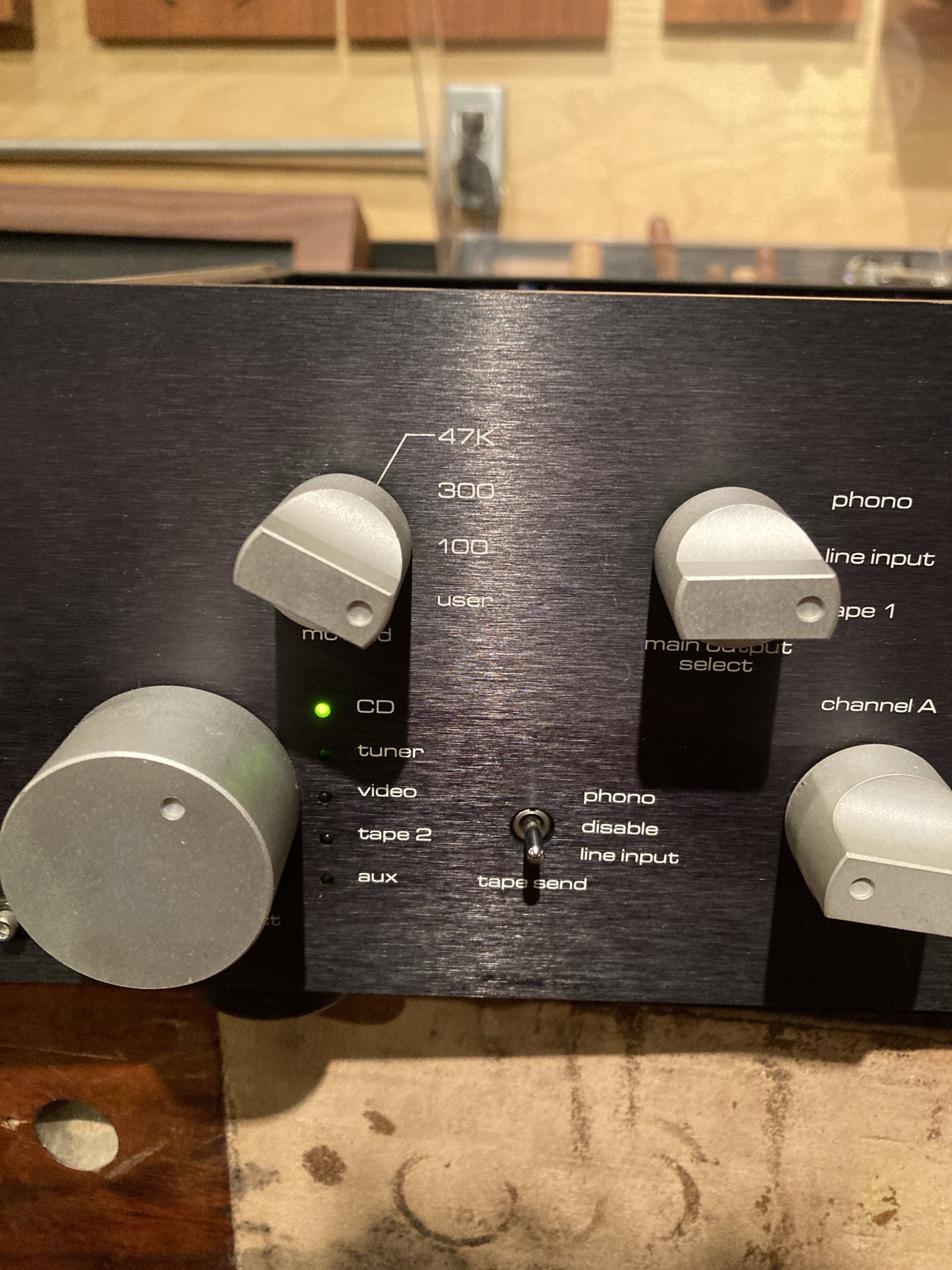

I purchased this piece from JXLstudio and I can confirm that I cannot get any signal from the phono input.
I set both internal switches to MC and inserted the shorting plugs to the MM inputs.
The jumpers for the buffered outputs were both set to disable.
I inserted all the tubes in the correct tube sockets per the board and the manual.
I set the main output switch to phono.
Tape Send was set to Disable.
Turned the preamp on and it initialized and then the LED went solid amber.

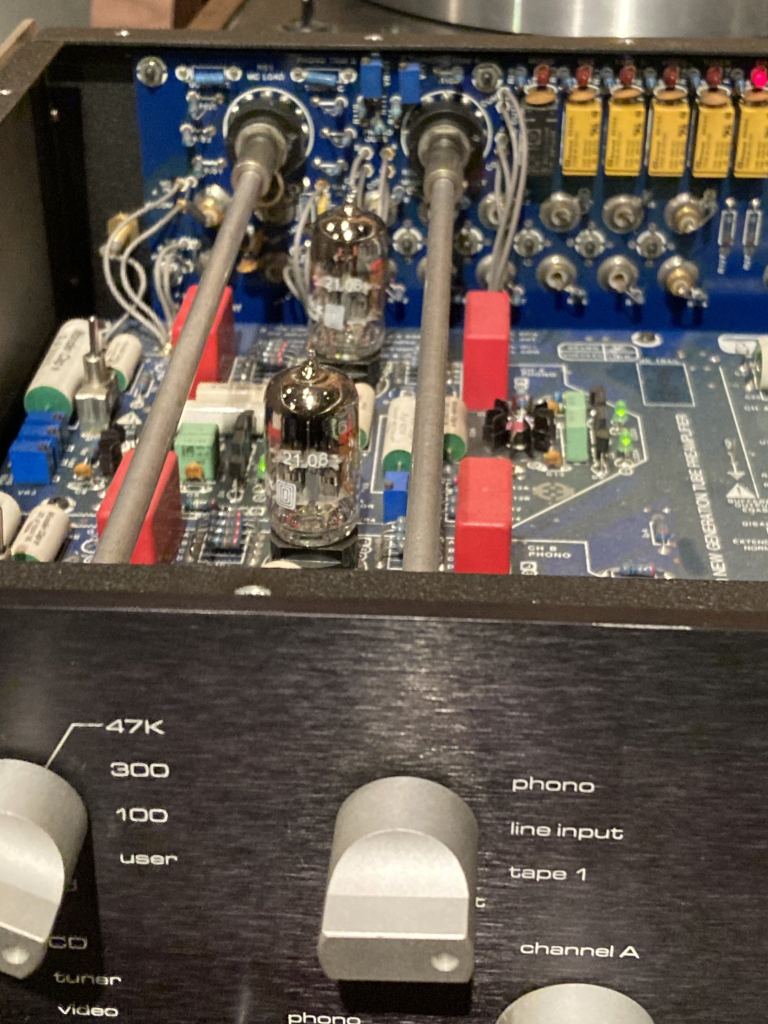

All of the green LEDs on the board were lit per the photo previously posted.
I unmuted the preamp and the Ready LED lit up and the red “UNMUTE” LED on the input board came on.
No signal heard as I turned the volume across the full range.
I switched the main output to Line and set the selector to CD and the preamp passed a signal in both channels.
I switched the main output to Tape and the preamp passed signal in both channels.
I don’t know where the K6 LED is located, but above the row of relays on the input board, the corresponding LEDs all seemed to work as I changed the input selector.
When I set the Tape Send switch to phono, TS Phono lit up. When I set it to Line, both the TS Line and TS Phono lit up.
That’s the only strange behavior I could see inside the preamp.
So where can I find the K6 LED?

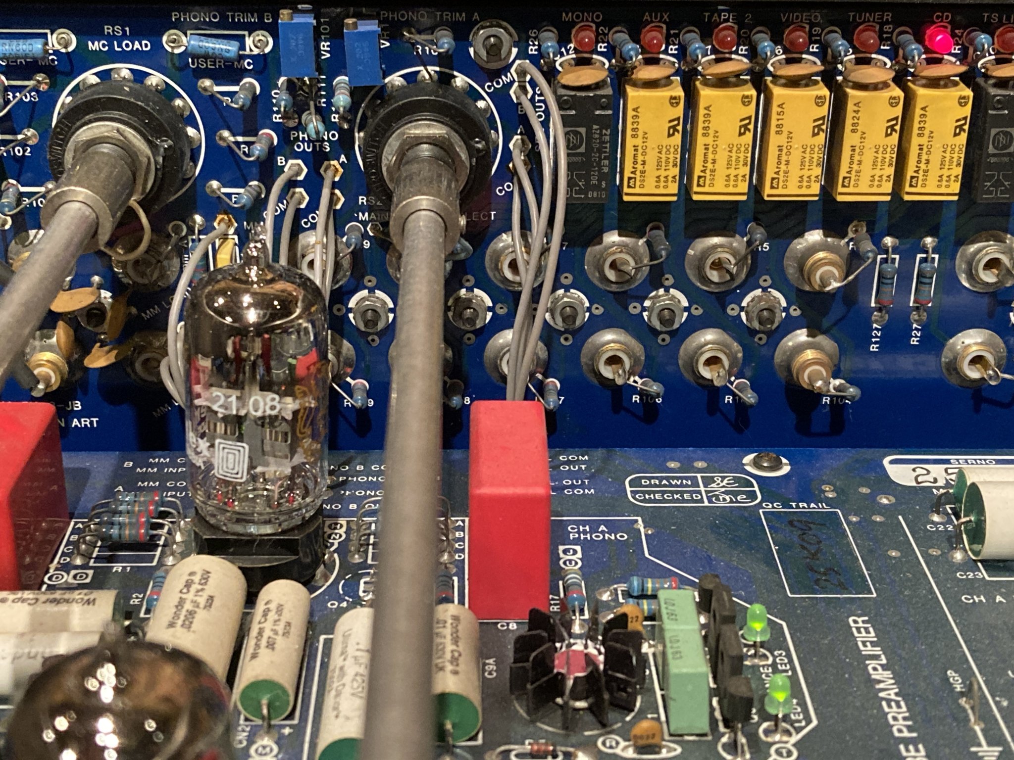

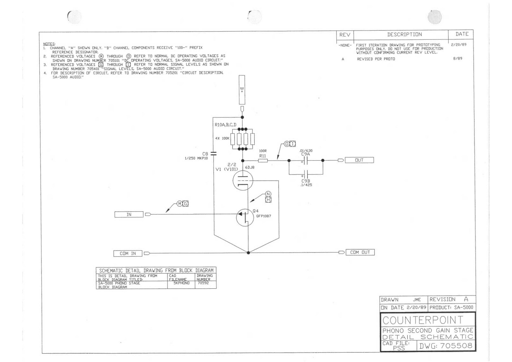

Of course it can't work without , was visible in the pictures but nobody noticed ...
That is the input in the second stage of RIAA gain
I did mention about him checking the RIAA Test point and if he had signal there in post #27. Never got an answer. If he would have checked that and depending on what he saw we would have gotten our answer if the signal was even making it there.

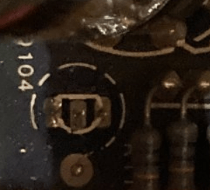

While looking at those jacks, I noticed that Q4 and Q104 are both missing. Could this be the root cause?
View attachment 1239624View attachment 1239625
Nice find! well if you can get the parts to put in there you will have a very nice Phono section with a nice linestage. 🙂 I can't remember if Mike Elliott had a mod for these transistor inputs. I know he did remove the Mosfet on the output of the Tubes in his SA-1000 preamp. Most likely it would be the same as on the SA-3000 preamp since the SA-3000 and SA-5000 phono section are very close in design and input stages.

Not that JFET is missing , it's the one in the second stage. And are not the same
Anyway I would not modify the circuit so easily , only after much listening and thinking . Even if you remove one JFET the whole thing is full of transistors and buffers because it is what it is - hybrid

I wonder if something like a 2SK170 would work in place of the QP1087. I did find a P1087 that Fairchild made. If you can get some info on the SA-3000 preamp service manual, I bet these Jfet's are the same since they are used the same way in both the SA-3000 and SA-5000.
