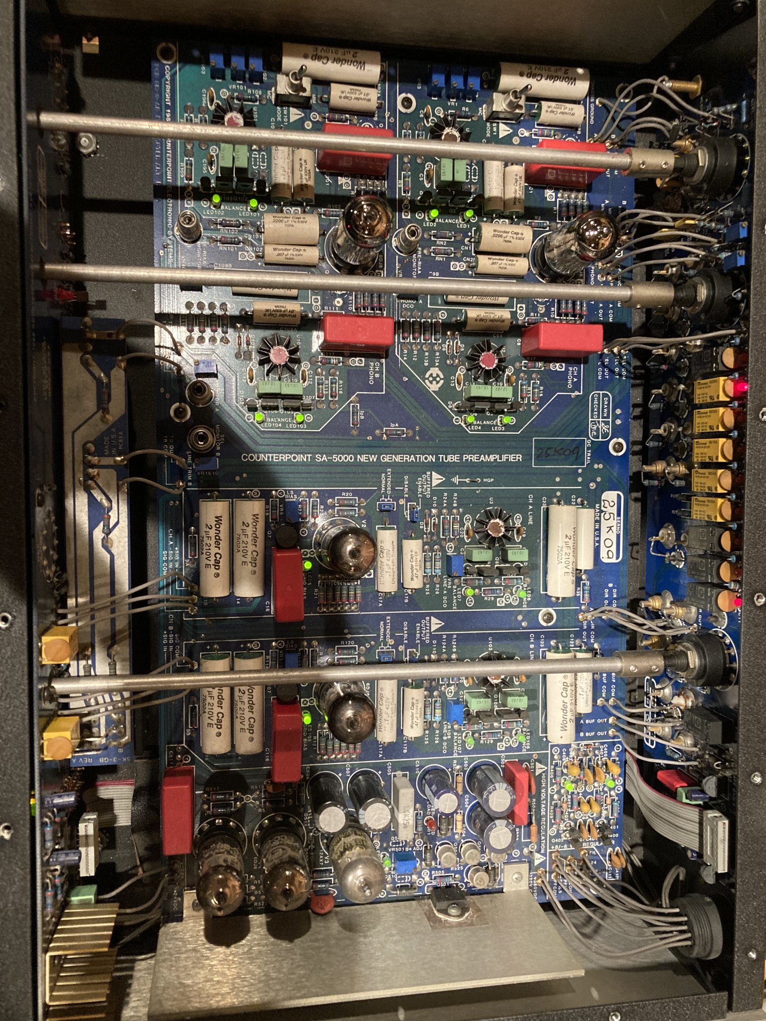

. BUT I can't seem to get anything from the phono inputs. I tried changing the phono and rectifier tubes but still nothing- just inky black nothing. All the leds on the board are green except red led 210 on the contorl board which isn't described in either the owners manual or service manual. Any ideas?

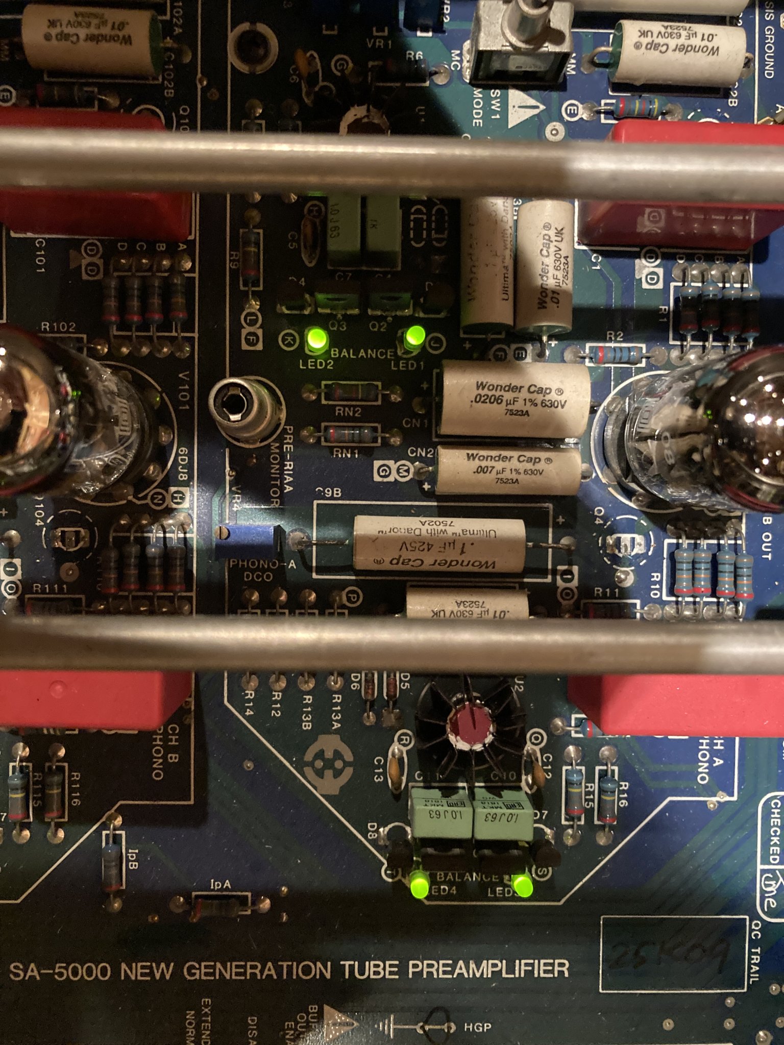

Now turn it on, and using the silkscreen legends, hunt down the following LEDs in the phono section
LED1 'BALANCE'
LED2 'BALANCE'
LED3 'BALANCE'
LED4 'BALANCE'
A photo would likely help
Yes the leds light up when I change the input selection. on my unit they are red. The tubes all are seated and the LED 1-4 are green.

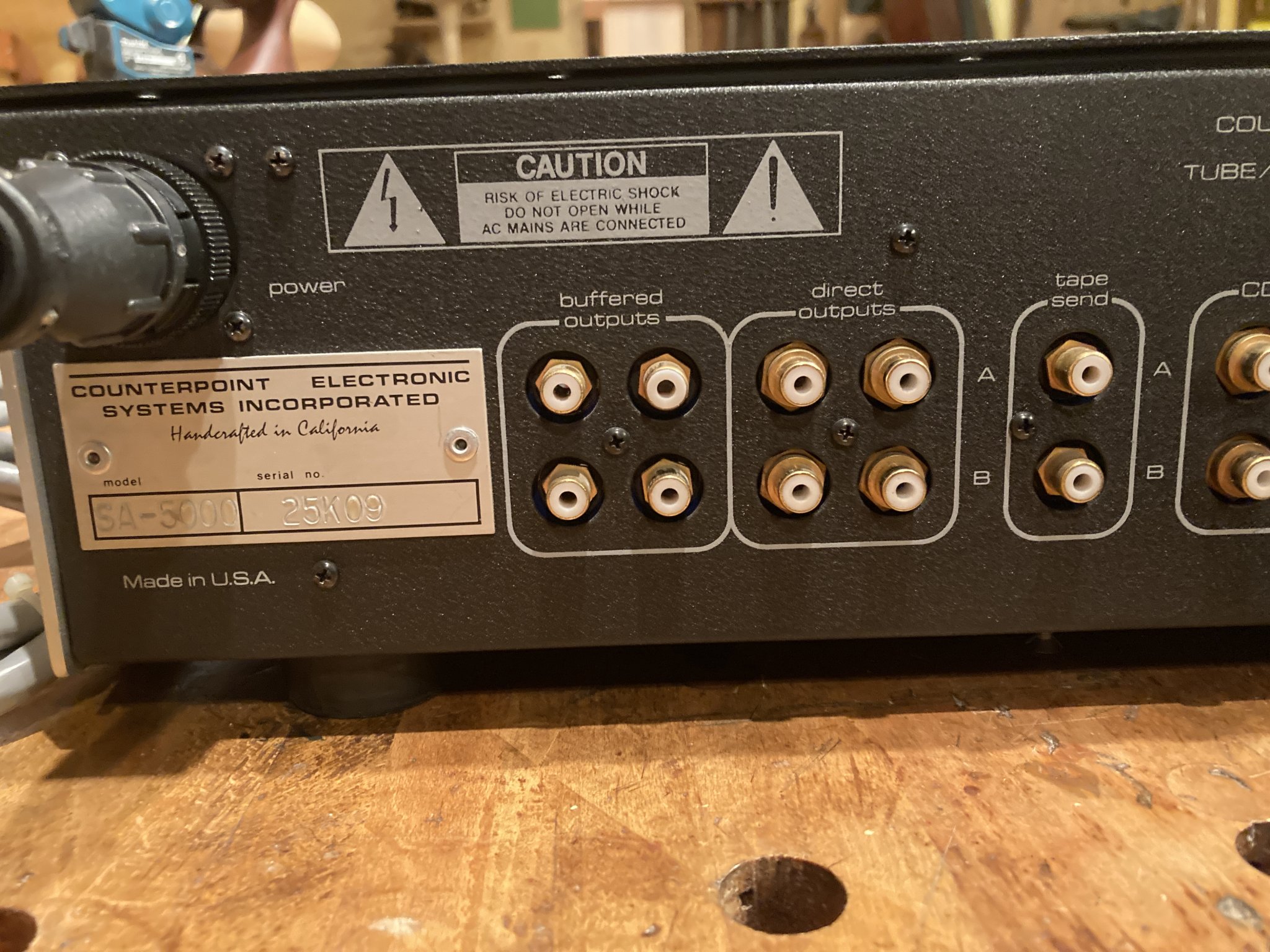

Cool. Based on visible date codes (1975) this guy shouldn't be too weird or esoteric. Even Audio Research's didn't stray far from classical forms in the 1970s. Any chance you could find a schematic? It'll be tough for folks trying to advise troubleshooting without one. Perhaps strangely, a pix of the whole back panel, showing jacks and their labels, might be useful.

The 1975 date codes on the WonderCaps fooled me. This actually is from the era of super complicated American preamp designs. Even more complicated than a contemporary Audio Research. The back panel shows no required external looping or other common Gotchas. VivaVee's advice about MM/MC switching in post #4 seems especially appropriate.
