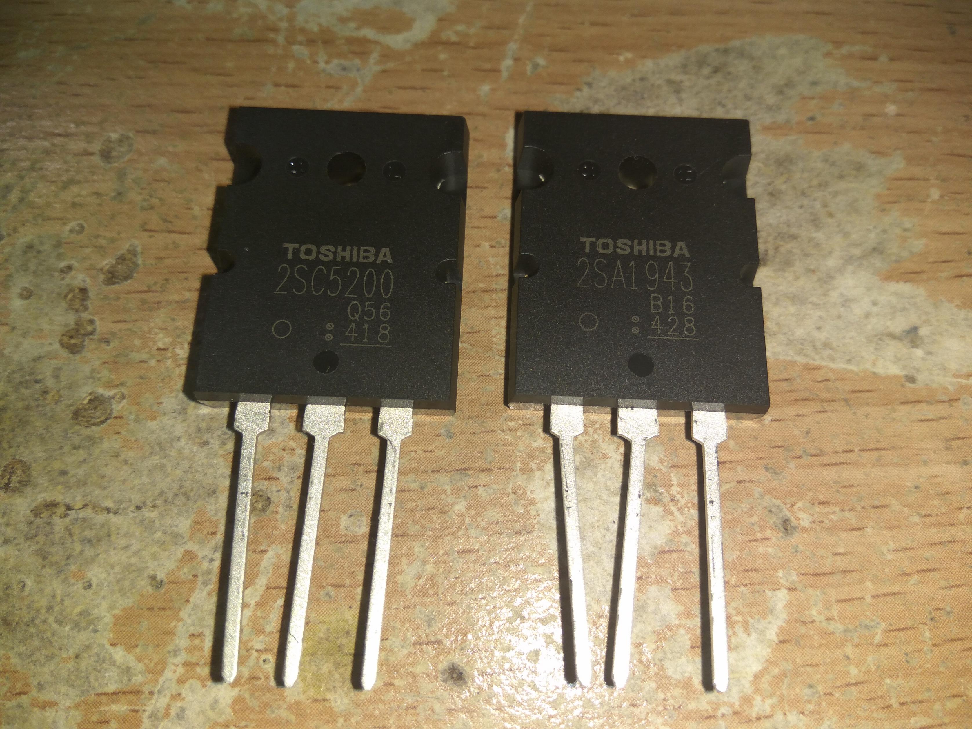

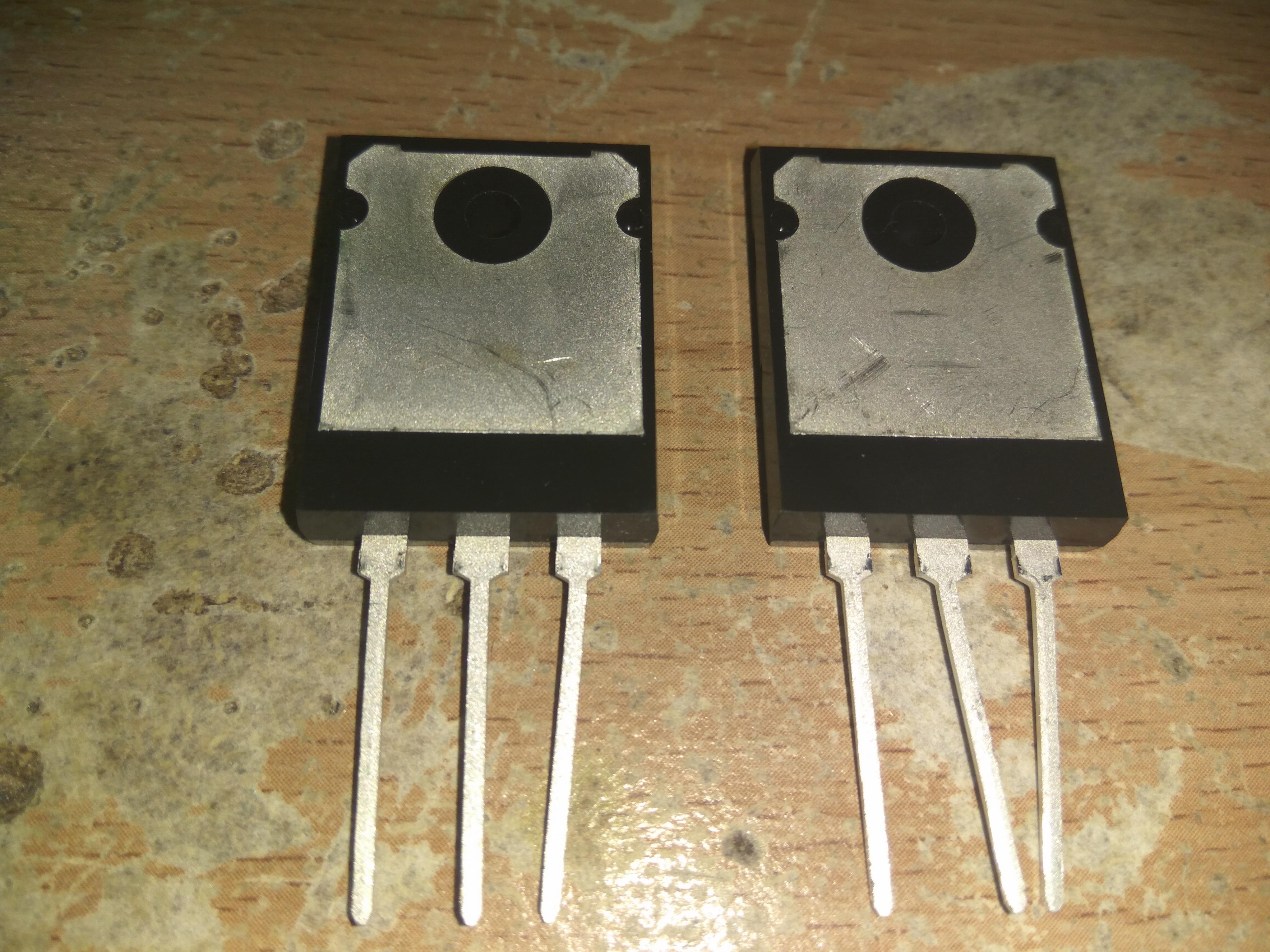

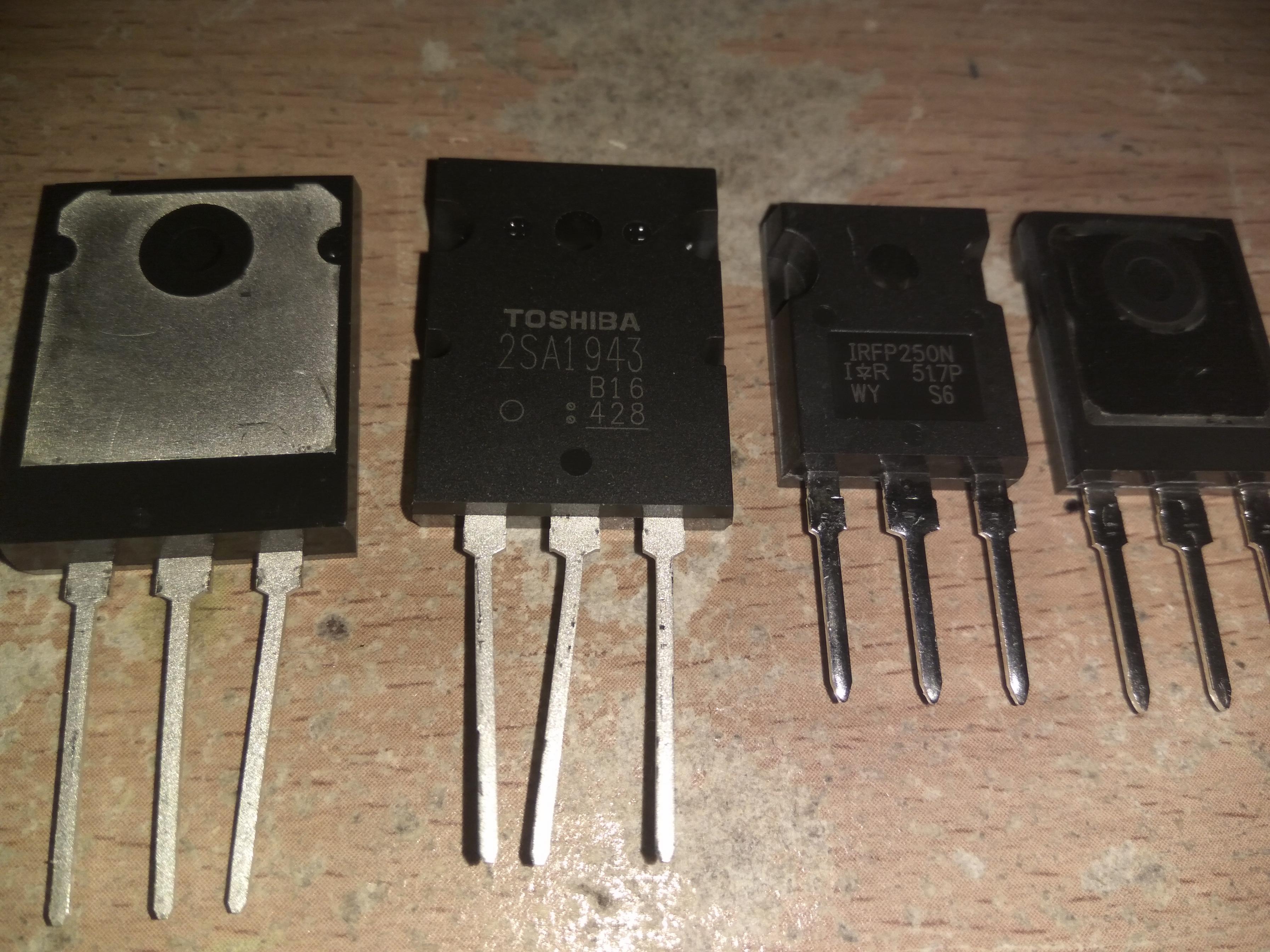

Speaking of fakes i have some 2sc5200-2sa1943,irfp250n from tayda electronics.
Are they original and good to be used to audio amps or fakes?

Toshiba
mine are bought any years back here schuro shop.
- they have glossy backplate
- toshiba is same print in thick of lines like 1943/5200
- only the O than one point above and only 3 number code
(not extra letter+2numbers)
- at last JAPAN
this one not sure real ones.
With IRFP is a great dilemma newer days- you can buy this one you have-
also here reichelt, digikey has newer- not tinned legs.
I have bought IRFP 250-M Mouser older I- heart- O-R types- silky legs- good
ones- in Circlotron and ACA.
But it's a Challange!
In TME i became IOR(heart) 9140- now needed some 240.
Tayda generally sells good stuff. Only way to know for sure is take it to a vise and crack it open. Real Toshibas have a big square silicon die perfectly centered on tab. Fakes have a small die crooked mounted and covered with white silicone RTV.
You can also measure capacitance of base to collector. A small die has small capacitance relative to real one which is larger.

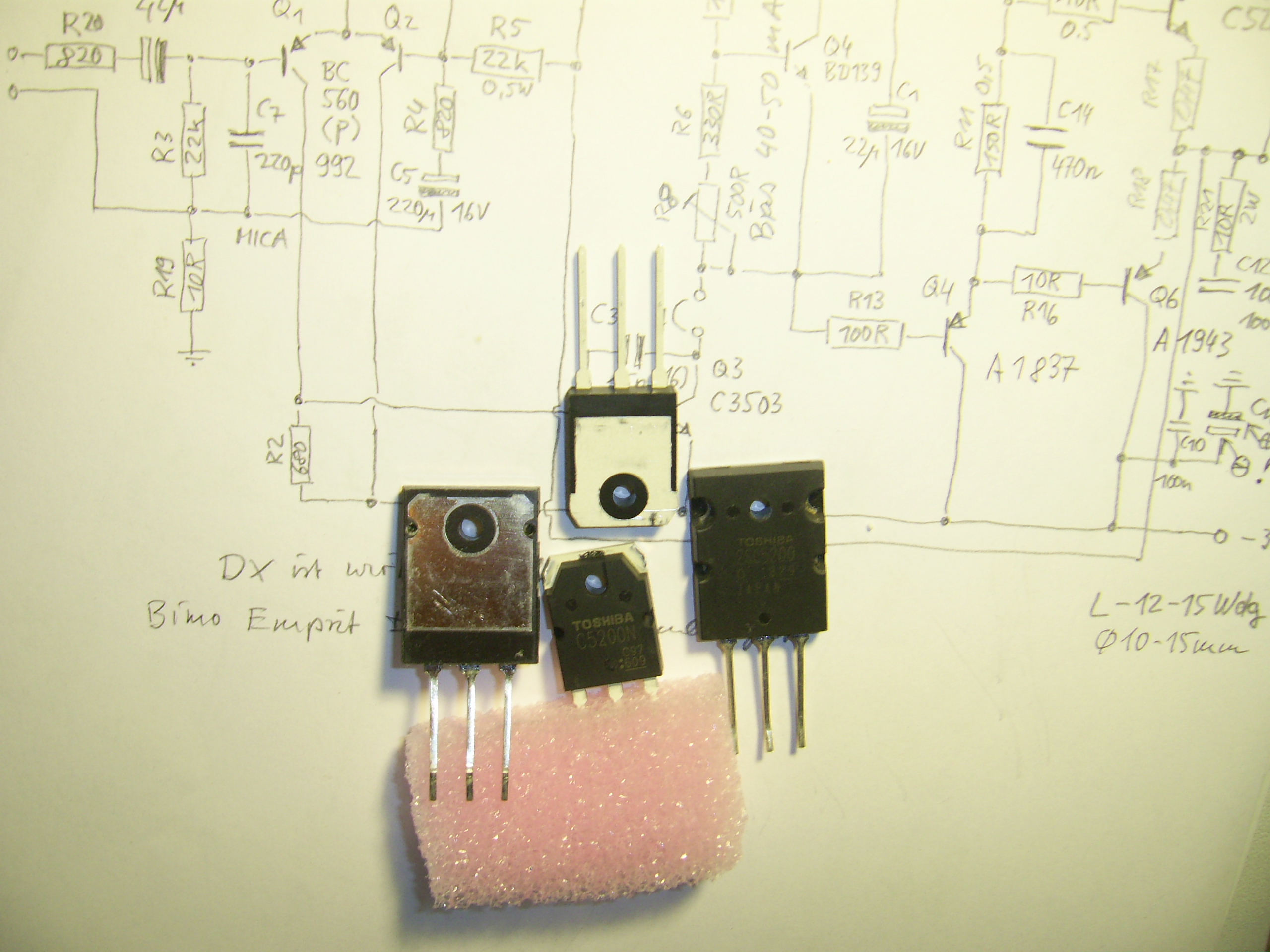

Hi maouna and interested.
send pics from my last bought 2SC5200 O Toshiba from digikey, 14 days back.
That is TO-3P new production since 2015- you can reed on PDF there.
What is happen with your Trannis? 😱
The Fakers ??? have taken the new LOGO ? or production has changed
to new LOGO with old TO264 Typ- is this possible? 😉 😕
You can compare- the older working in onkle Charly DX-Amp and the news
should in a Ranchu/AKSA Quasi Amp.
