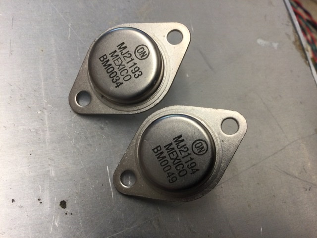

....Please take a look at the pics I've attached.
According to Rod Elliot's pages...these are counterfeit due to MEXICO at the bottom row...and not MEX...on 2nd row.
Also...date code not in correct place.
However...these were obtained from a 3rd party some 14/15 years ago as samples from ON-Semi, and I believe this info. to be reliable.
I've chatted with ON-Semi...and provided the picture below.
They suggest that printing standards/protocols may have changed over the years...and not to rely on the internet info.
They most certainly PASS the acetone test....but I haven't been able to test them conclusively yet.
Any thoughts out there please?

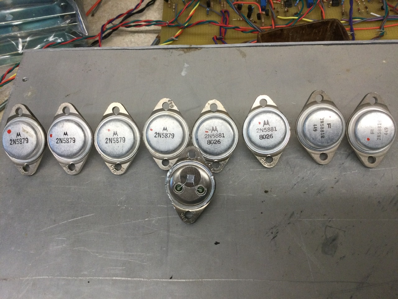

These were obtained using the sample program, right after the “ON switch”. I got 50 of each, a big score as samples. I have used them all over the place - still have about a dozen each left. One batch of 20 each ended up in amplifiers running off +/-127 volts, and would drive *two* labhorns in parallel off each. I damn near melted the plugs off the extension cords at a gig once (it was LOUD with a lot of bass). I think they pass the authenticity test.

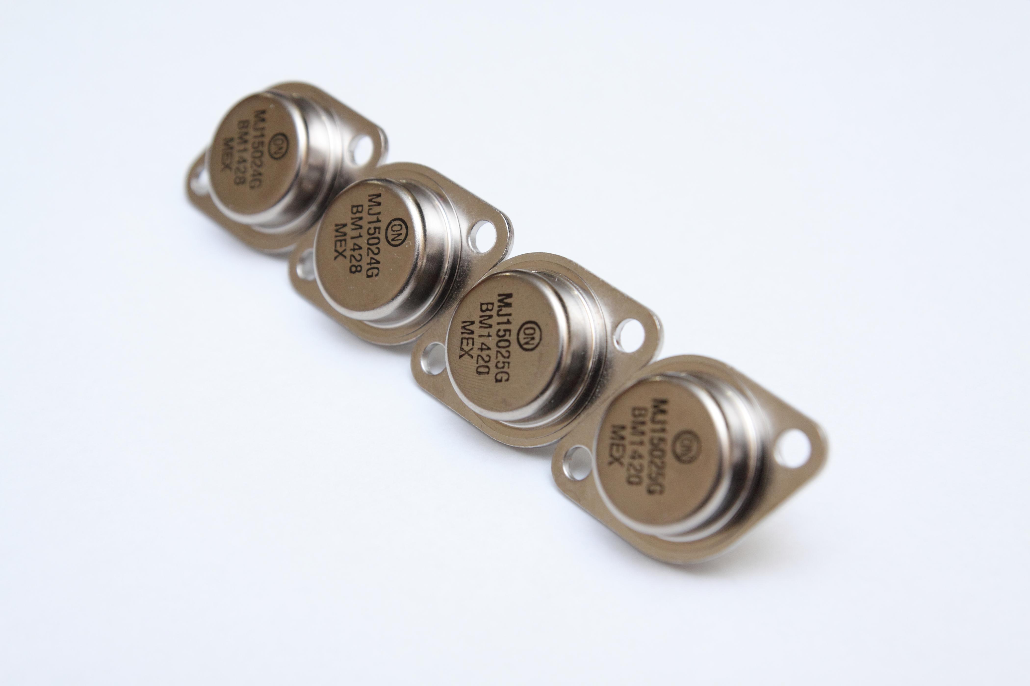

The MJ15024G looks believable ... the the 15025 less so ... the 855A looks quite ridiculous ... the top and bottom of the can doesn't line up and there's sealant oozing out of it!
The Next row ... Left is believable ... the OPA may or may not ... the diode, don't believe ... it looks like it was made in a transistor mould ... and the C3423 ... altogether too sloppy looking
