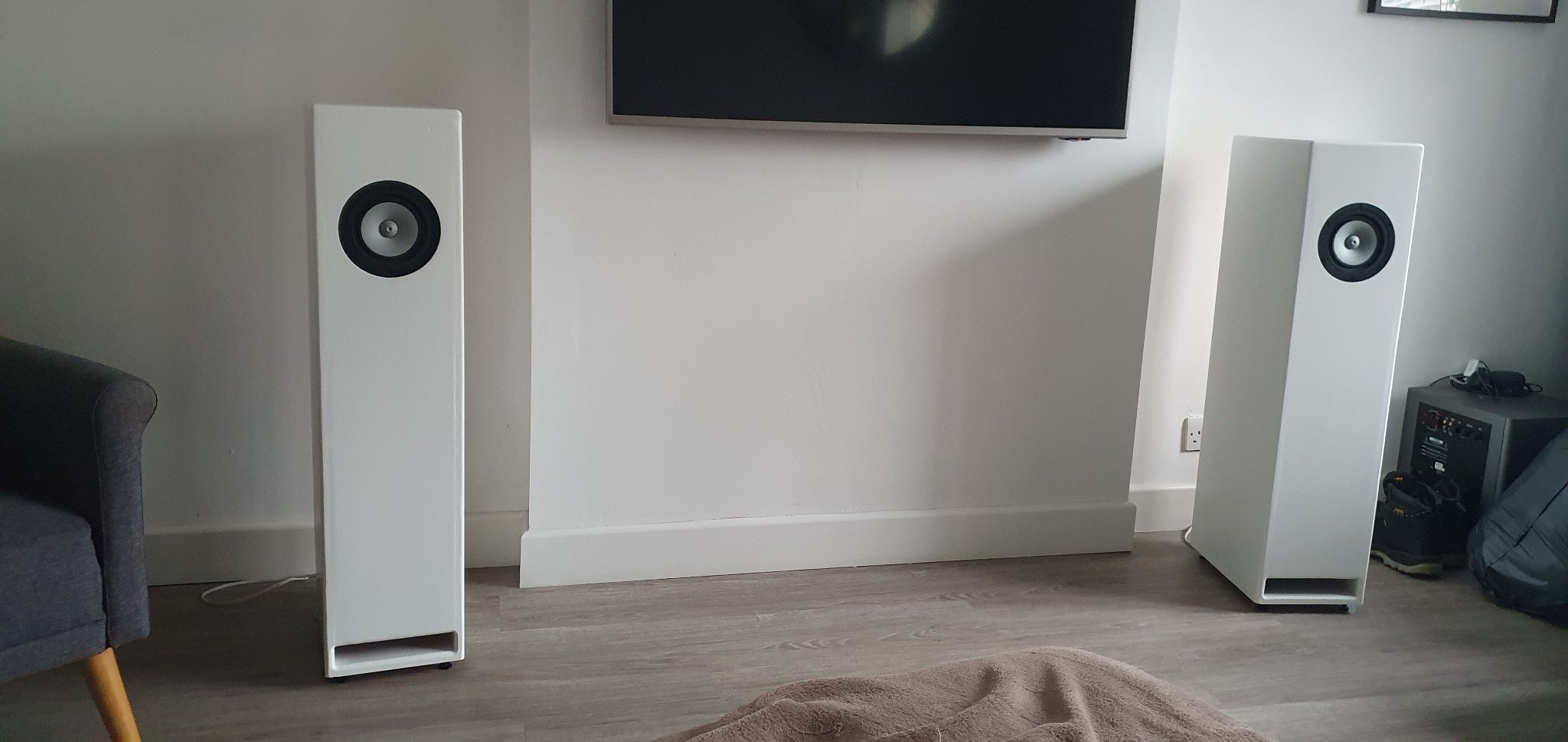

I built a pair of Pencil 10 cabs for a pair of Alpair 10P units a couple of months ago.
First time using full range drivers for me aswell. Previous amp/speakers were a Sony 550ES and pair of JBL L110 's so VERRRRRY different.
The Alpair 10p / pencil 10 combo is nice. Having got used to not wanting to ramp the volume knob all the time, I have got used to listening quieter than I did.

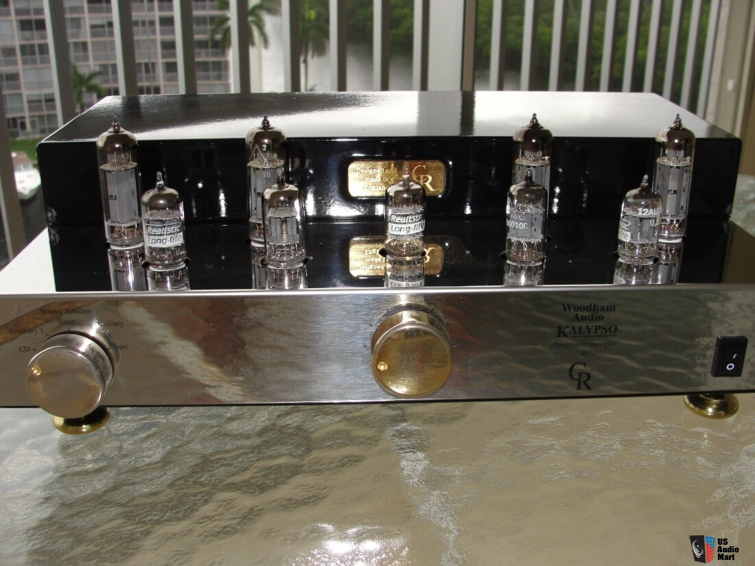

The Sony amp is way too powerful for the MA drivers so I tried a wiim amp. 65w class d. This sounds nice but I really wanted to try these with valves so I have bought (but not yet received) a 2nd hand CR Developments Kalypso EL84 tube amp. 15wpc I think.
Can't wait to try it.
I've attached a pic of the speakers.

Well done Borats Baby, that's a nice and clean looking Pensil build you got there.
