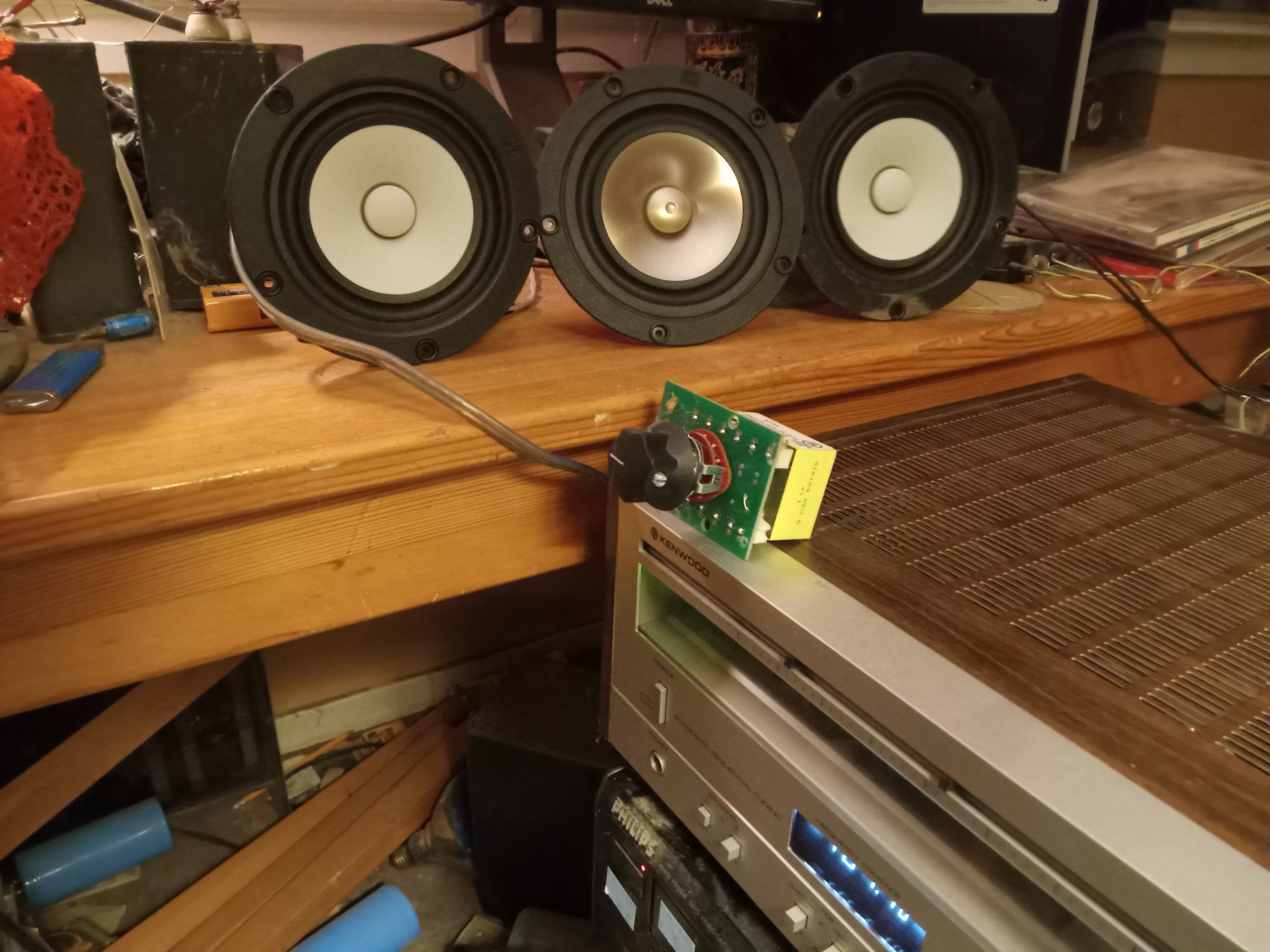

Some of the Mark Audio drivers use metal cones, and some use paper. They have some expensive models that use a fancy process treatment on the cones, and if anyone has first hand experience with these, I'm all ears - pun intended. The quality of sound I consider most important in this project would be that it sounds natural and non-fatiguing. In other words, if the metal drivers have the typical issues with ringing and breakup modes I'd lean away from them. I look at waterfall plots, and when I see a mess I'm discouraged. Are the paper drivers very good in this regard? Should I spend more and get those fancy metal cones they say sound good anyway?
I have experience with Pluvia Seven HD and MAOP-7. The Pluvia is excellent FR driver that exceeded my expectations. It works well in all types of enclosures: bass reflex, acoustic suspension, OB, and even without any enclosure! I was breaking-in my drivers by hooking them naked to my favorite receiver tuned to local FM station. The radio played 14 hours a day for about a month, with volume gradually increasing, and the progress was amazing. In a couple of weeks some bass appeared, and the tone was such that I started liking the kind of music that I previously didn't care about. Often I would set aside what I was doing to enjoy a song.
MAOP-7 is same as the Pluvia except cone treatment. Long story short, the MAOP is BIG improvement over the Pluvia. We all dream of speakers that perform at the same level as good headphones. Well, the MAOPs bested my Grado SR-325 and Sennheiser HD650 with all kinds of music, from pop to classical. They also need long gradual break-in.
Micro Arc Oxidation Process creates a layer of very hard alumina (4 times harder than the one created by anodizing, the process used e.g. by SB Acoustics in their ceramic drivers) tightly bound to metal substrate. The way it works, in my opinion, is by making a sandwich in which different layers have different speed of sound. This disrupts standing waves on the cone resulting from border reflections. MAOPs are so good that it would be a misdemeanor to make them play bass alongside with mids and highs.
