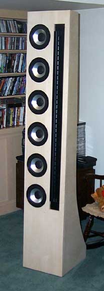

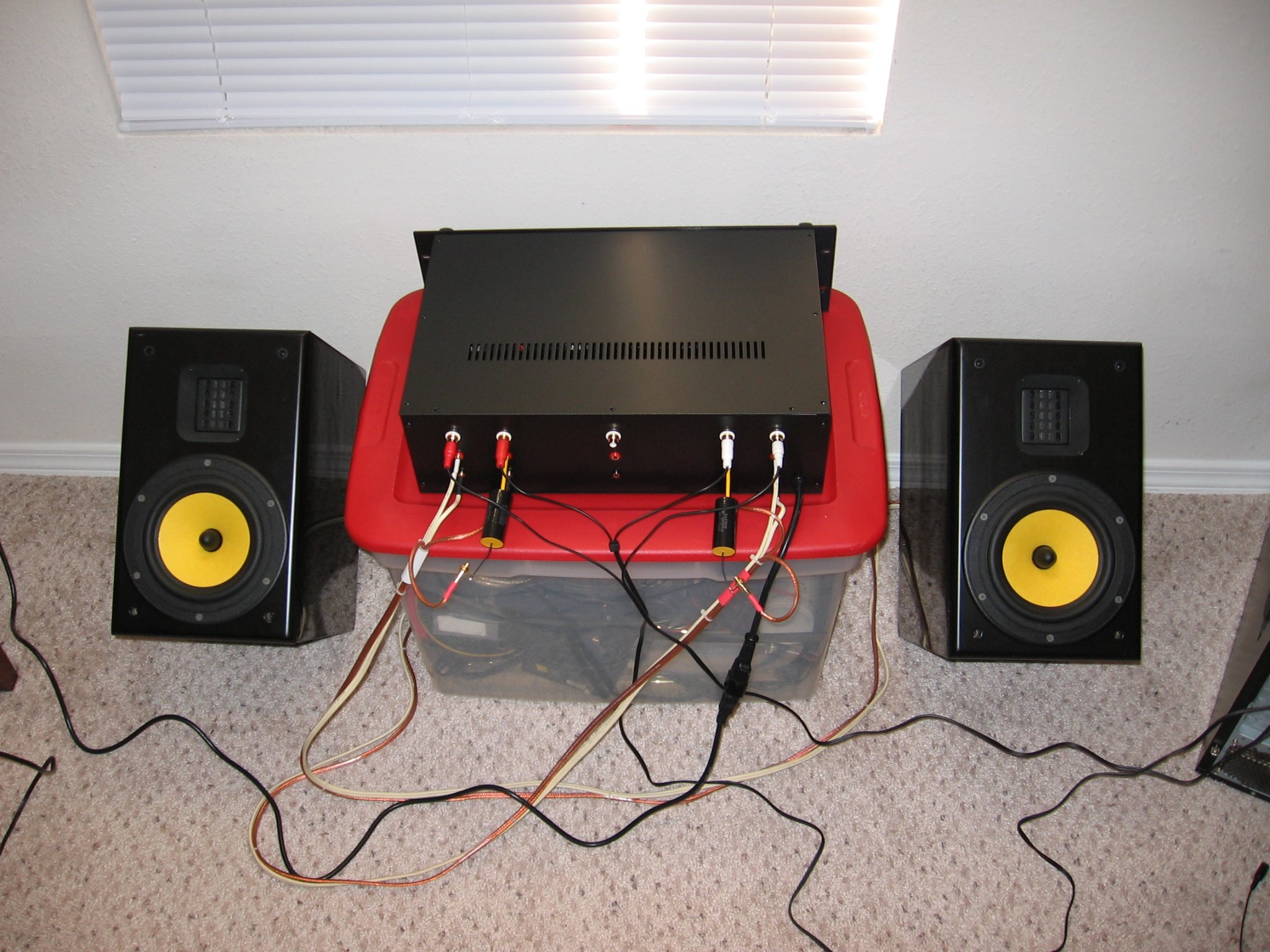

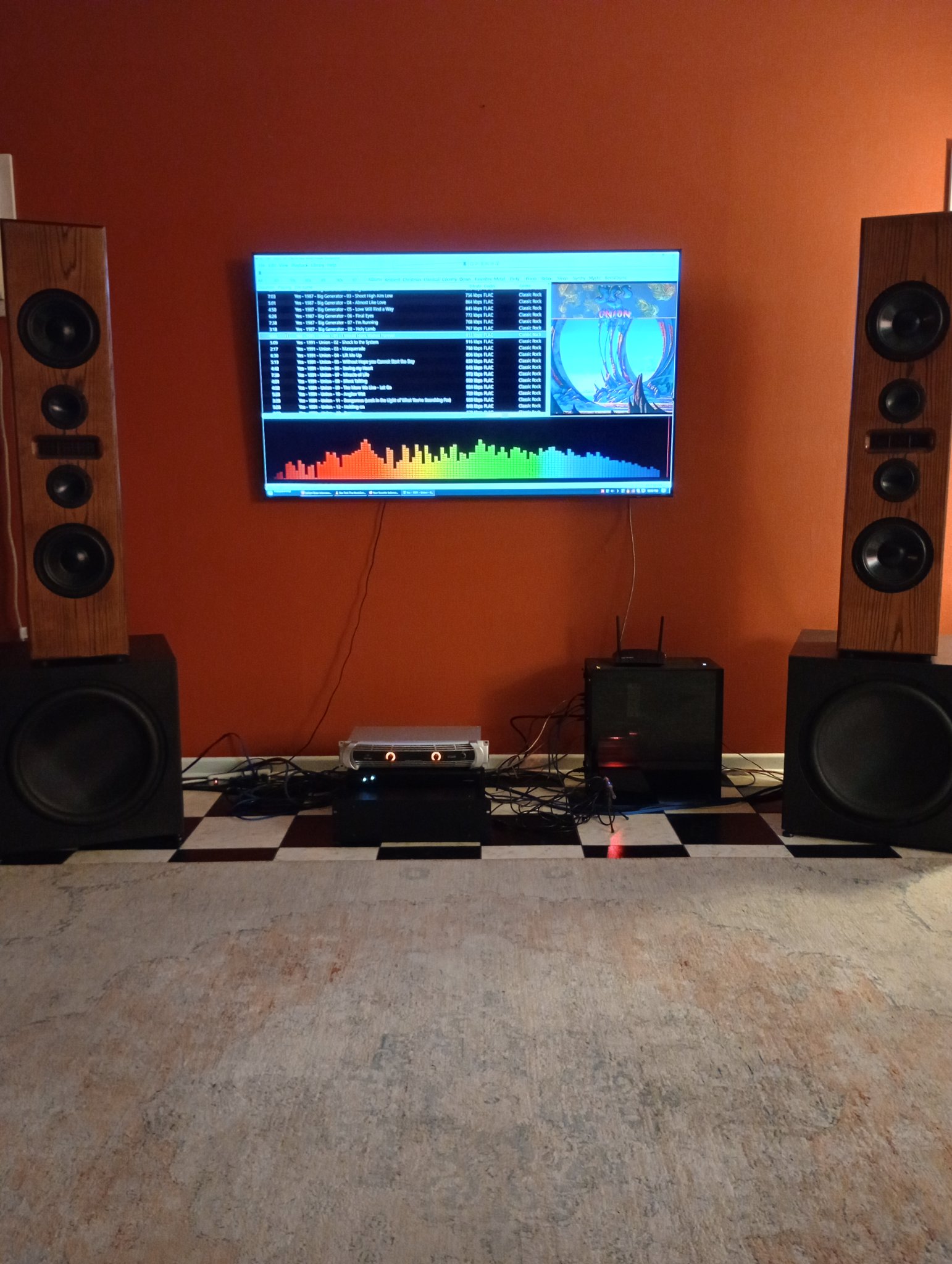

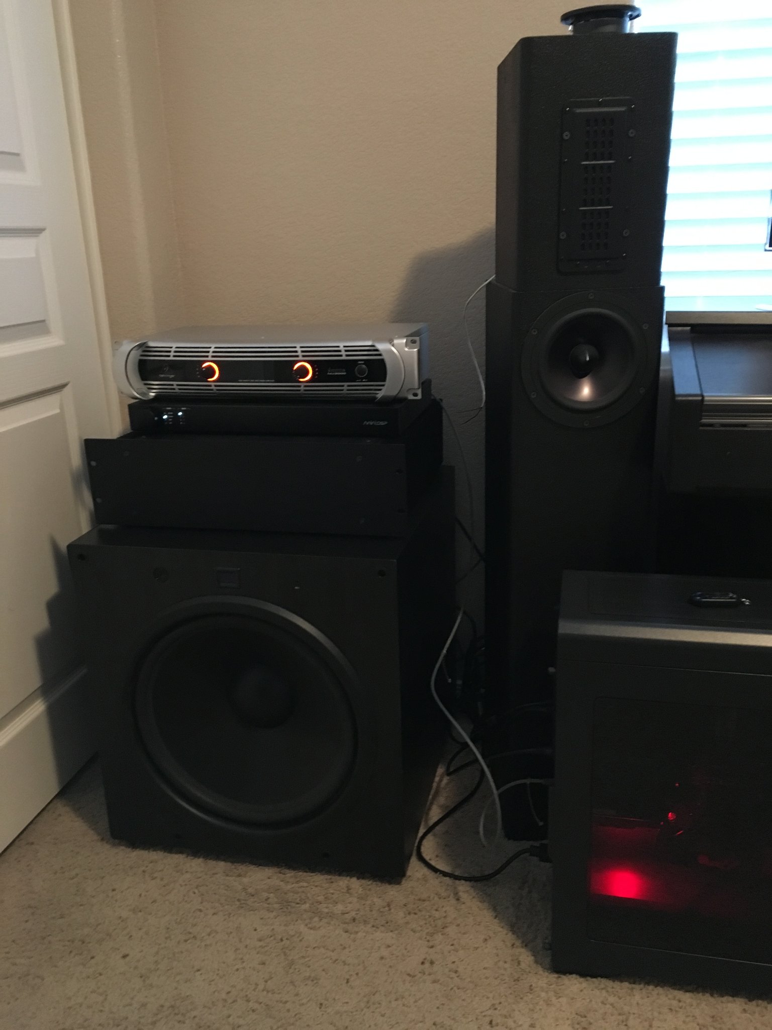

Do you recognize anything here?

Yeah, those planar tweeters! On the second picture it looks like Focal midbass. Focal also used the principle of sandwich cone to suppress cone standing waves, fiberglass on front side and paper on back in this case. I have a pair of these, very lightweight cones. Their ultimate sandwich cone is Utopia, used in high end speakers, car audio folks swear by it.
