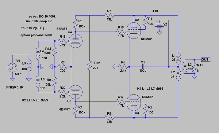

Actually the discussion shifted towards triode connection for the output stage in the last posts. The power output will be around 4W before the start of the clipping, where the input stage has still enough headroom and thus will not sound harsh at all, IMO.
Anyway, in the case of pentode connection the additional driver brings a substantial increase of power: 10 clean watts!
45

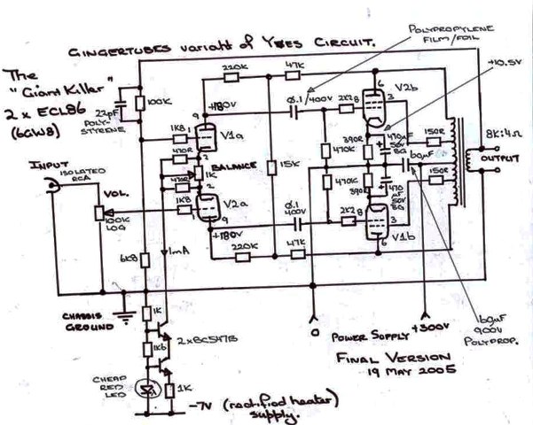

can you just remind me what purpose the R12 performs in your design. Does it help in balance.
Hi Shoog,
Stole it from Yves. As I see it it´s for getting the right amount of feedback. Infinite resistor=full feedback, shorted resistor no feedback.
Did a few sims. There seems be a problem! With more feedback the input stage clips/distorts earlier. Also 3H gets higher relative H2 with more NFB!?
Shoog,
If I may answer for Lars - R12 in the original Baby Huey set the local feedback amount - see the cross-coupled 15K in the original baby Huey schematic attached. It was varied to tune the amount of local feedback applied (about 6DB extended the top & bottom ends by an octave) versus the amount of global feedback.
AFAIK, this was the magic in Yves/Gingertubes Baby Huey circuit? But maybe Gingertube can explain more
This is as expected. The feedback anode-anode presents a much lower impedance load to othe driver tube resulting in a steeper load-line. This will limit possible feedback that can be applied before driver distortion becomes excessive.

What comes to mind when using triode-strapping is that absolutely no NFB, being local or global, is needed.
I got blinded of the nice "one connecting point to the PSU" idea
. This can of course still be done by shorting R12.
If we now use the ECL82s as example and find sensitivity to high a good stepdown transformer should be used instead.
The main concern should be to choose a working point with as low 3H as possible. Unfortunately this also will give us a lower Pout.
If wanting lower Zout(and lower gain) from the driver triodes, local feedback could eventually be used by connecting them as anode followers. But serial resistance is no fun

I don't believe you have anything similar in your Tabor clone or do you?
No John. Have have to admit that I'm very much a suck it and see man myself. The exact details of partial feedback are a bit mind numbing. I have my own ideas, but I'm not c ertain they are perfect. It does work though.
