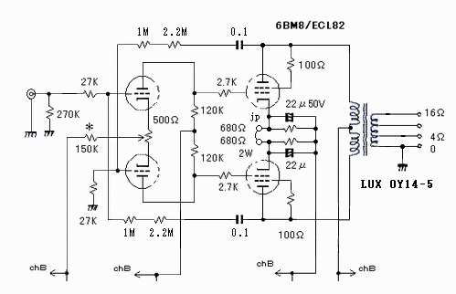

And what about this one for the volume control? http://www.raleighaudio.com/figure_18.htm
That looks like a very nice solution.
Shoog
Jaap said:This is also a kind of feedback that i intend to try.
Why is the designer using the 27K resistor at the input ?
O.K., now I understand, its the law ...🙂 😉
just joking
I tried it out quickly and it indeed did not work without the resistor
just joking
And it lowers the input impedance to the neighborhood of 27K
per grid... As the feedback loop tries to hold the 1st grids to a
virtual AC ground. But there is always some signal present, so
its obviously a little more than 27K, I don't know how much...

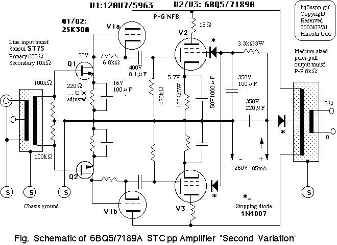

IMO it is a very good idea and works nicelyl with all high Gm pentodes lile PCL82/86, EL84, EL86......
In the circuit above, the Fb should be approx. 3dB (output stage in triode connection) and you could get 5W with very low distortion (approx. 1%!!).
The input impedance is practically 24.5K however I don't think it is a problem for any good preamp: for 5W output it should require 1.3-1.4V only.
That is the only "downside", IMO it works much better than any Fb solution which makes any use of the OPT. Basically the amp is more stable.
45
Sorry.... the sensitivity should be around 0.6-0.7V RMS (for 5W and using a 5K a-a OPT) and not 1.3-1.4V...😀
The input bias should be about 0.8V and since there is no cathode feedback anything more than that would overload the input and reintroduce some harshness to the sound.

Ok Jaap, give some time.....I don't have and don't use simulators or other circuit design stuff so I have to do it with powerpoint! 😀
Basically if you go for RC-coupling and self-bias for the output stage you will need approx. 255-260V (depending on drops) in order to have 250V voltage supply (19-20V will drop on the cathode resistor).
With more than 250V at input you can use 1,5K cathode resistor and 120K for the anode and will get a bias around 1.4V and a gain of approx. 45. The overall gain, considering the splitter and the source follower will be around 36.
So you can apply up to 6db plate-grid Fb without overloading the input.
The splitter is RC-coupled to the input mainly because you can better set the quiescent point for your purpose.
The driver can be a JFET source follower (80-100V JET's are good).
Each stage is RC-coupled and someone would not like it, but IMO it sounds.
Here the voltage swings are modest. Especially if you use 630V good quality caps like the SCR MPK, they will sound transparent....

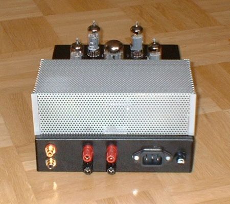

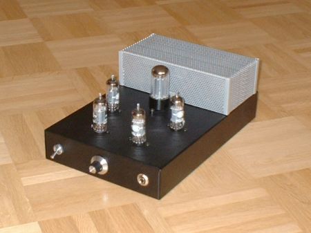

In the meantime I remembered that I still have a long time unused EL84 amp in the closet: inputtransformer => 2SK30 => stc style power stage. I fired it up and I must say that it sounds very good.
I don't have a clue how it works (most people don't I think) but this little amp is a killer. This kind of stc topology started in Japan with the 6BM8 tube. So I think I cannot escape in trying this too in the future.
Jaap said:I am going to experiment further, thanks for all the suggestions so far. Keep posting![]()

thanks again (all of you) for the interesting suggestions, i will certainly look into it.
I chose the ecl82/6bm8 because I have some (4 unused Telefunken and some Philips
) and two rather good OPT's which were made for them. Are you gentlemen suggesting the ecl86 for better sound or for more power ? I suppose that I can use the same OPT with ecl86.
I do not like Fet inputs because matching is a problem. The regulated screen supply is certainly on my list. And I have also some ecc40's (= e80cc) on the waiting line to put in a cathodyne splitter in some amp some day. But for this one I have promised myself to stick to two holes in the chassis. That doesn't mean that i cannot put some mosfets somewhere if this helps in finding the holy grail with a small two tube amp.
For some reason I like fiddling with tubes as ecl82/86 and el84 more than trying to get good sound out of 300B's.
