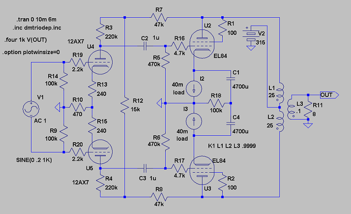

Hi Jaap,
sorry for answering late. Here are the schematics:
Amp, one channel
PSU, for both channels
BTW, I used a tube rectifier just for the fun/optics of it ...
Tom

This is the variation on Yves circuit, but for input transformer. It can off course be optimized for ECL 82 or ECL86. No need for global feedback as long as you go Class-A.
If you want go Class-AB there has to be capacitors from the cathodes to ground and another working point. And NFB......

There are better solutions for Class AB1 (triode connected) where you don't need any Fb as well. The simplest is using a classic cathodyne splitter. As Jaap mentioned before, an ECC40 will work nicely in such application. With 250V supply voltage you can get 2x18V RMS with 1% THD. This much more than needed (7-8V RMS typically).
Accordingly the distortion will be proportionally lower. You can estimate approx. 0.3% THD only from the front-end (just before the clipping). And this will be practically 2nd harmonic only and very probably you can sort-out some way to cancel it out.
The splitter can be directly coupled to the voltage amplifier or RC-coupled. I prefer the latter because you have more freedom for the design, the tube experiences less "suffering" when allowed for auto-biasing and, IMO, this is reflected on the sound.

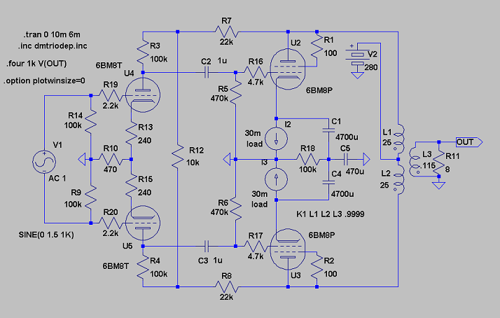

This is the ECL82-version. without C5 you will get over 2W in pure Class-A. With C5 in place you probably will get almost 4W in AB. It sims very well with low THD until just before clipping. I have some doubts about the pentode model I use, will try to find another.

The Circuit proposed at Post#1 has promise. I would echo comments of others about the input pot arrangement.
The circuit at post#22 (posted by Jaap) is really interesting. My view is that the cross coupling the balanced feedback like this should give a quite different harmonic distortion profile than the circuits returning the feedback to the same side diffamp anodes. I think it should be better at suppressing odd order harmonic distortions, a useful thing in any push pull amp (like whats done in a Citation II). Do you agree?
Lars (revintage) - re: schematic at post #45,
At your convenience (and if you can be bothered) can you look at the effect on odd order harmonic distortion of using MUCH lower values of R18 (currently 100K). I am suggesting a value of around 30 to 50 Ohms.
Ian

Hi Ian,
Have done it before and just did it again 😉 !
There is no difference at low levels!
Near clipping the difference between the 39ohm and the 100k version is that the 100k gets a trifle higher H2 and H3 barely visible lower.
When shorting R18 H2 gets even lower and H3 higher. Points in the wrong direction doesn´t it?
Will dig deeper into this eventual tweak favoured by AW. But remember this is sims and the differances are small. If it sounds better, use it!

Lars,
Thanks - That "stacks up" with what I found in listening ONLY tests using the fixed bias version of the Baby Huey.
I tried a common 39 Ohms in the cathodes. that is, individual 10 Ohms for current monitoring and then a common 39 Ohms to 0V. I set bias with the 39 Ohms shorted and then listened with the 39 Ohms shorted and with it in place (short removed) - just accepting that I also got a bias reduction when the short was removed. Based upon just listening tests I eventually deleted the common 39 Ohms. I thought that with the common 39 Ohms in place the amp lost some impact and slam (although it may have been as a result of the reduced idle currents (about 20%) with the 39 Ohms in place).
I don't have distortion measuring gear at the moment but am in the process of restoring an ancient (1961) Hewlett Packard 302A Wave Analyzer. This thing is a tunable (20Hz to 50kHz) precision voltage meter with an 8Hz pass band and 75dB out of band rejection. Won't be ideal but its a start. It uses a balanced modulator, 100kHz IF frequency and XTAL based IF Filters. Might even design a cheap modern version of it for DIY'er use one day.
Ian
Ian
Allan Wright recommends the approach of lowering R18 from a high value (100K) to a low value. In my version of this amp I have it set high at 1Meg and it works fine. On my other amps I went down from 1Meg to 300R and noticed a slight improvement in smoothness. Barely noticable though. I think you have to be careful of hearing what you want with this type of marginal tweak.

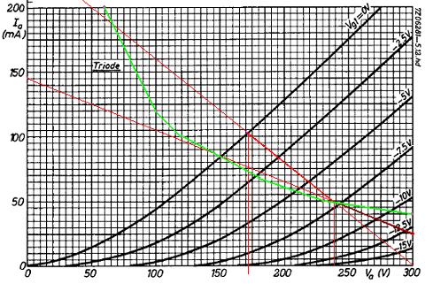

No revintage, my driver description was just to tell that, as you say, THD will come anyway from the output stage even if you go for the simple cathodyne. This driver is simple, works great and you don't need any input tranformer which, if not of high quality, will have a negative influence on the sound.
The transition from class A to B is very broad with vacuum tubes if the idle current is high enough (i.e. 300V/25mA with 5K a-a load for the EL84's) and you will be not able to see any anomaly in the THD as function of output if things are well done.
In fact, if the idle current is not low, in many RCA datasheets an amplifier delivering a RMS current identical to its idle current is still considered class A.
In theory, instead, it should be class A until the output peak current equals the idle current......
I never trust simulators when working out the THD, the models they use (indipendently of their accuracy) are always based on average specs.
Same, same when you sit with your slide-ruler, pencil, paper and a Ua/Ia-diagram: They are all based on average specs!
Same maths, but higher accuracy, IF the models mirrors the diagram
If we leave calculations behind, IMHO pure Class-A still rules soundwise.

Edit: Added curves to show what happens with 300V/5k/25mA. Pmax=7W, Pclass-A=1W. Also from 1W and upwards the tubes are over Pamax with 16W at clipping. These are very course figures, just an indication.
What you may not see in a sim is that with a lowish value of this R18 you get a LOT more power on signal peaks, the amp just sounds a lot more powerful.
That's the only reason I use a lowish value, otherwise the circuit more closely appoximates differential operation with a high value, just low enough so the big elco's get biased OK.
Using this whole concept on a rebuild 70 watt Chinese amp - sounds suprisingly good. But without the NFB. I used anode/anode NFB for years but finally prefer the sound without it.
Regards, Allen
