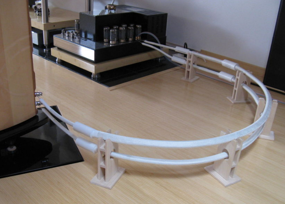

I have never seen a 600 Ohm cable. The old TV twin-lead was 300 Ohm. A 600 Ohm cable would be a widely spaced pair.If it was 600ohm balanced DF96 was absolutely correct in his analysis. So why the 'hehe'?
Wait a minute! There just might be a 600 Ohm speaker cable. I think that the brand name starts with "S".
I dimly recall some ladder line used in an old ham radio setup being 600 ohm. But that memory is 50 years old, so...😀
I thought it looked familiar...A maybe 600 ohm real speaker cable?
If the cable really has a characteristic impedance of 600ohms, do the terminations also have 600ohms impedance?A maybe 600 ohm real speaker cable?

Cable capacitance (plus load capacitance, which often dominates) forms a low pass filter with the output resistance of the source. Hence excessiviely high capacitance should be avoided. Once the cable capacitance is sufficiently low there is no advantage in making it any lower. So the rule is not 'low capacitance cables are better' but 'excessively high capacitance cables may be worse'.merlin el mago said:I think low capacitance cables are better, also shorter better. Please could you elaborate?
Real 600 ohm cable comes in two forms:Speedskater said:I have never seen a 600 Ohm cable.
1. RF 600 ohm cable - this will be widely spaced twin line used as an antenna feeder and/or matching network.
2. Audio 600 ohm cable - this will be a closely spaced twisted pair with 88mH(?) inductors inserted every ? km, as used in telephone trunk cables.
Modern audio does not use 600ohm cable. It may use twisted pair cable between 600 ohm sources and loads, but the cable won't be 600 ohm.

2 has unusually high capacitance - don't use long lengths with a high source impedance
4 and 5 have rather high resistance - not high enough to do any damage, but perhaps a sign of peculiar construction?
1 and 3 are what cables should look like
Now let me guess: the electrically inferior cables are the most expensive?
1, 2 and 3 are just standard bulk cables, 4 and 5 I have no idea.
However 1 and 3 are meant for 75Ω connections while 3 is a star-quad microphone cable.
Star-quad is designed for very specific conditions when even normal balanced XLR cables do not give enough RFI immunity by using 4 internal conductors rather than just two. This of course doubles capacitance and star-quad is only really needed if you build a recording studio next door to a radio transmitter.
