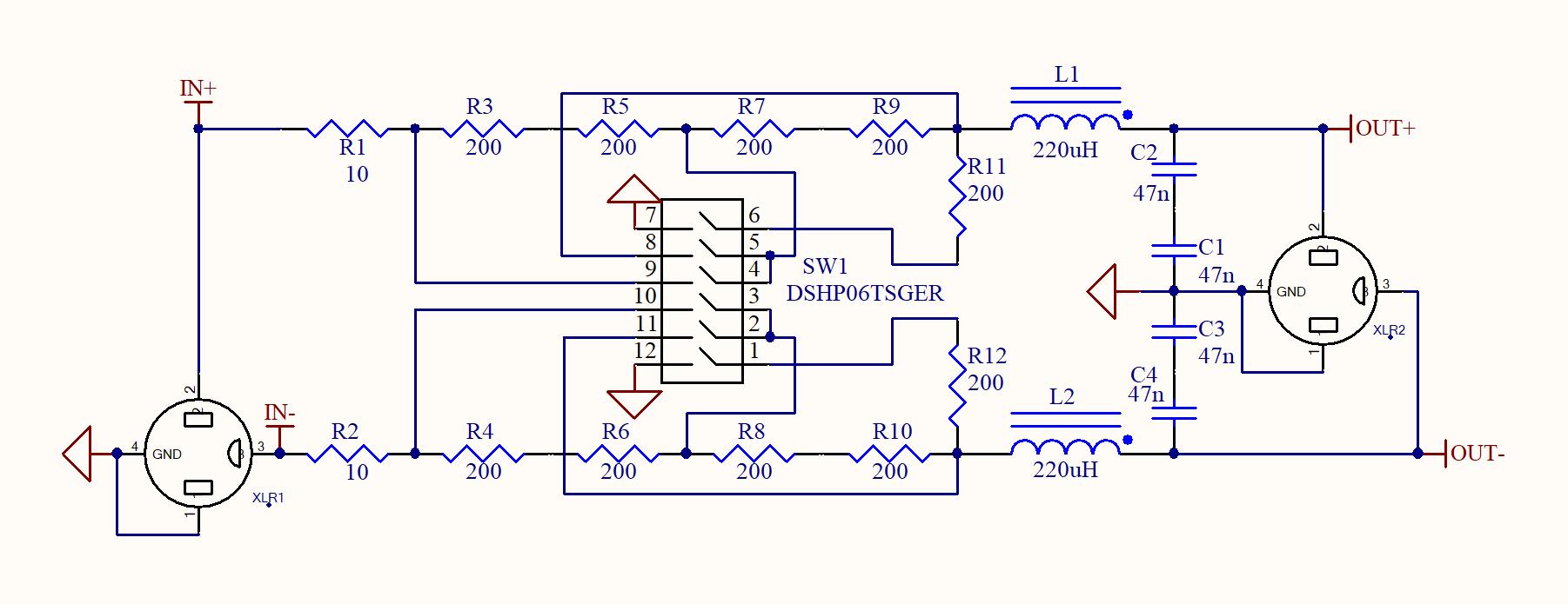

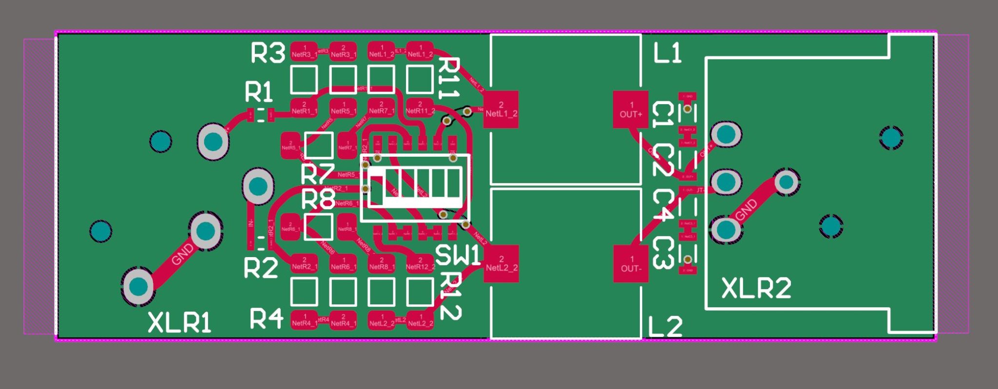

if anyone is interested in repeating. The inductors are SLF12575T-221M1R3-PF, caps GRM3195C1H473JA05, RESISTORS ARE Viking 0207 200ohm.
hi, i've ordered boards via JLCPCB and now questions regarding BOM are coming :))
-what size are R1/R2 10ohm resistors (power rating?) ?
-R3-R12 are 0207 package 200ohm 50ppm 1W (like MMB02070C2000FB200). do those resistors need to be thin film ones? what tolerance is acceptable (should be matched as close as possible or 1%=no matching is OK)?
-is it possible to use R3-R12 resistors with lower power ratting and higher tolerance (like 0,75W or 0,5W and 2512 package)?
-DIP switch DSHP06TSGER is not readily available in EU. i'll use omron A6HF-6102-P or CUI DS05-127-2-06BK-SMT-TR
-[ XLR1 = Neutrik NC3FBH2 ] /[ XLR2 = Neutrik NC3MBH ] would be OK?
is above correct :) ?
also - you've mentioned about separate DC-blocker board. what about this one?

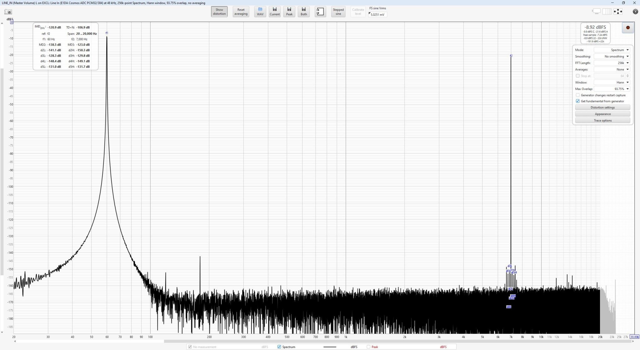

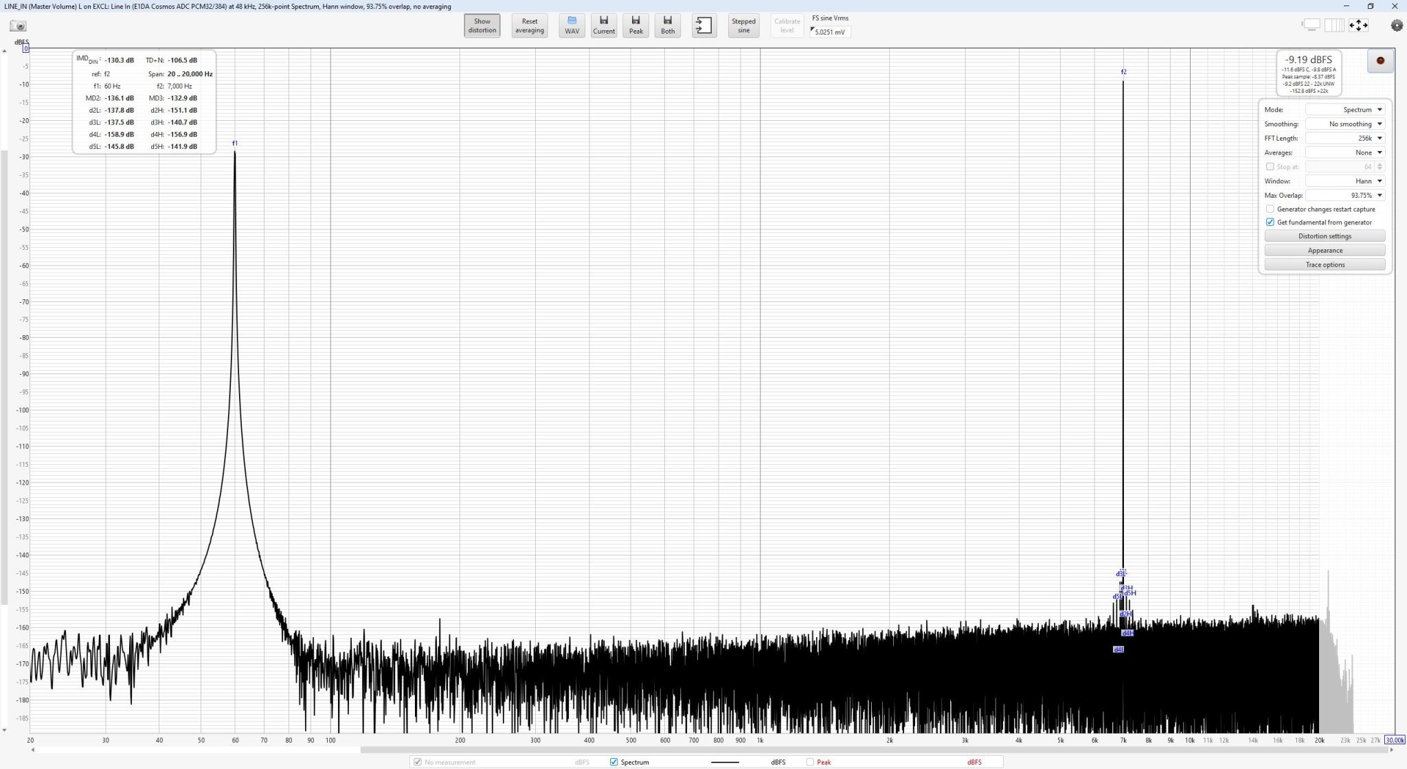

I got an interesting result with 1st ord HPF(built in the XLR cable external 100nF to the ADC input impedance 1k) for the IMD. The 60hz component was reduced by about 20db, and ADC's IMD contribution was reduced. The first FFT is a standard cable from 9039Q2M, the IMD is about -120db, next one is the same cable but with 2 caps 1206 C0G 100nF, and the IMD is -130db.
Not quite clear on what you are doing. Where are the caps placed, at the ends of the cable or something? In series to make a high pass? Also, what is capacitance of the cable itself?
Also if this is an SMPTE test, aren't the amplitude ratios of the test signals suppose to be kept the same for different trials?
