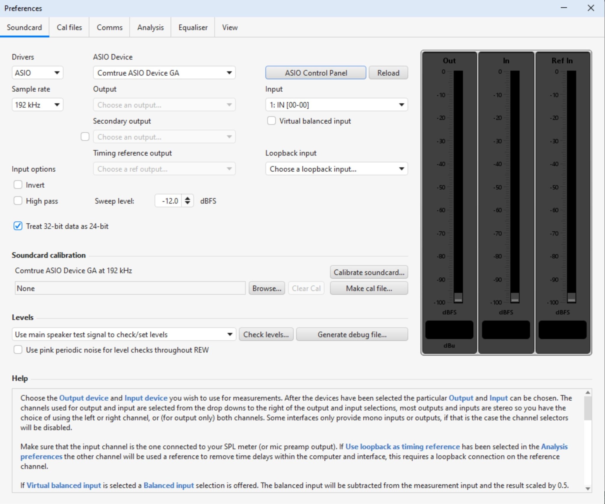

Hello,
I am unable to get REW to recognize my Cosmos using the Comtrue ASIO device driver, only Java, and only as an input device with that driver.
I have also tried ASIO4ALL V2 and FlexASIO - none allow my Cosmos to work with my Windows 10 laptop.
I can get it to work on my Win 11 desktop computer with what I believe are the same drivers, but would prefer to use my laptop for measurements.
Can anyone help me with the proper installation in Win 10 so I can actually use this great DAC so it doesn't just get sold off or sit on a shelf?

GKTAUDIO, pls try to install the Comtrue driver, the product page is here https://e1dashz.wixsite.com/index/cosmos-adc

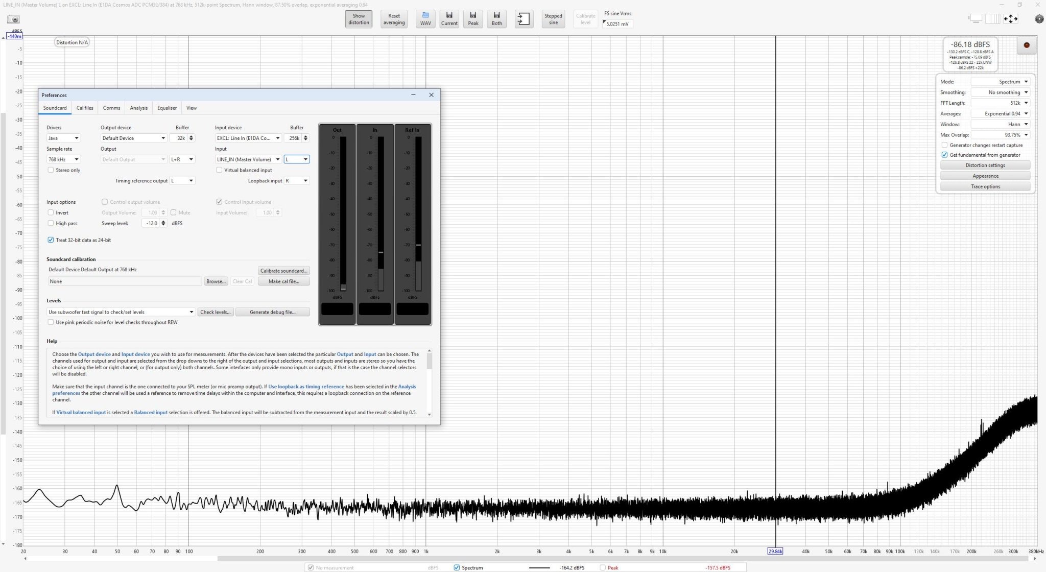

Comparing ASIO and Java, I couldn’t find any advantage in using ASIO drivers so I’ve switched to Java drivers as an only choice. Cosmos ADC is recognized outright on Windows 10, Windows 11 and Linux and works flawlessly at any sampling rate.Is it satisfactory to use the JAVA selection?

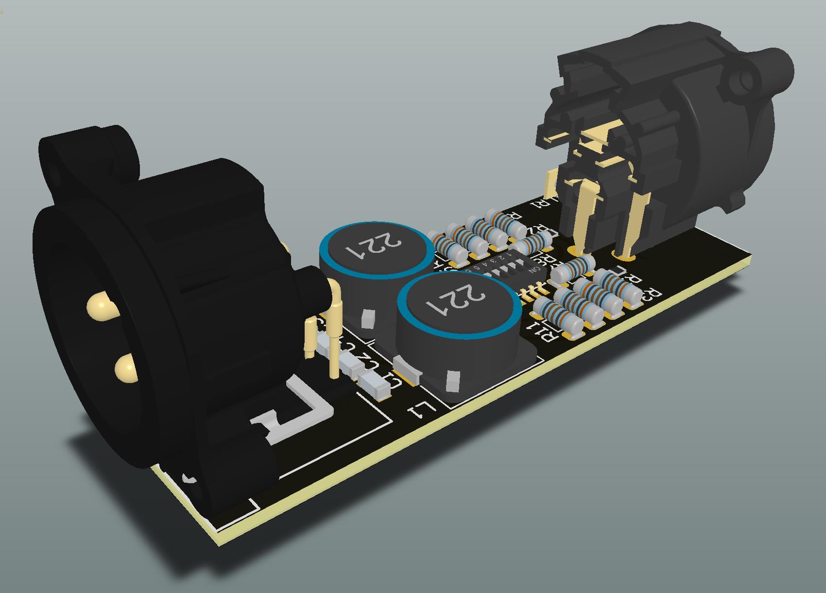

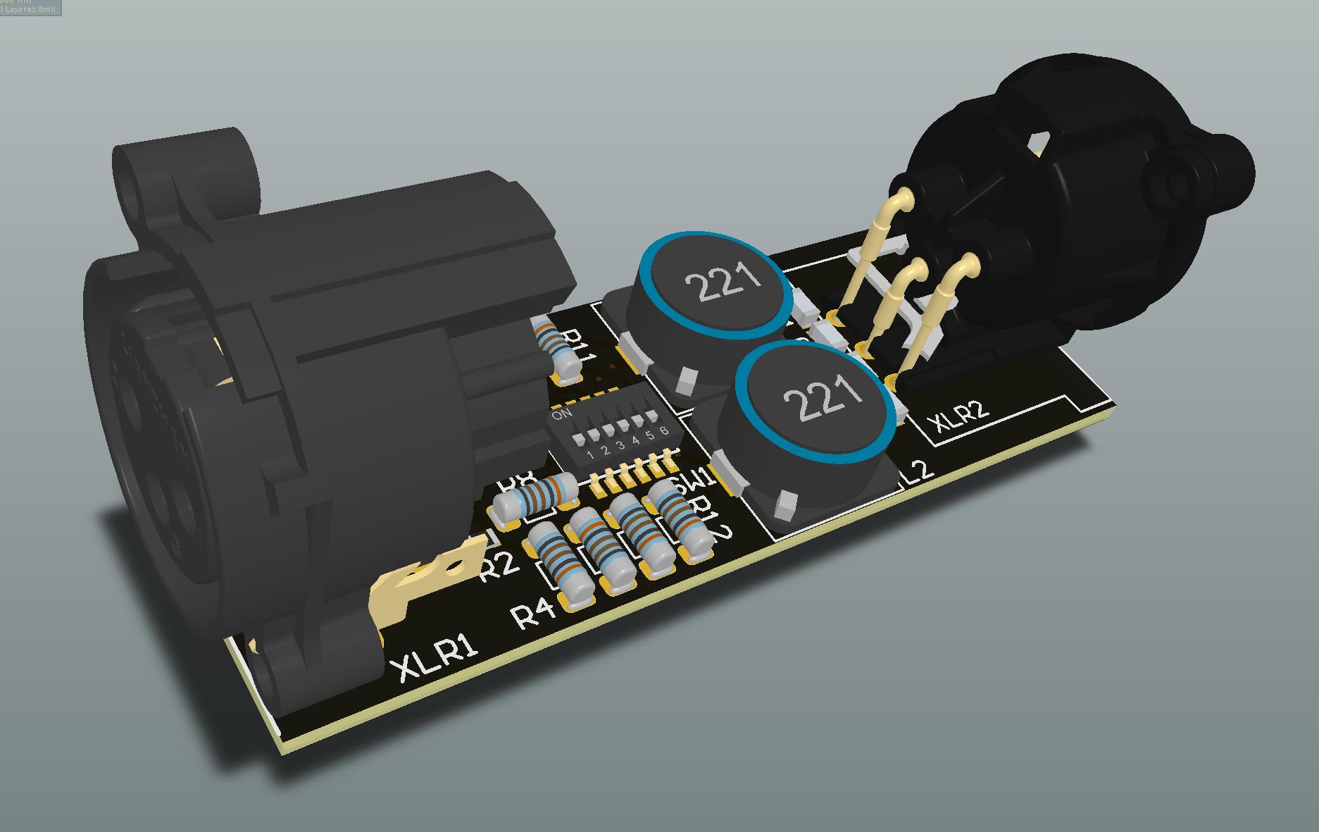

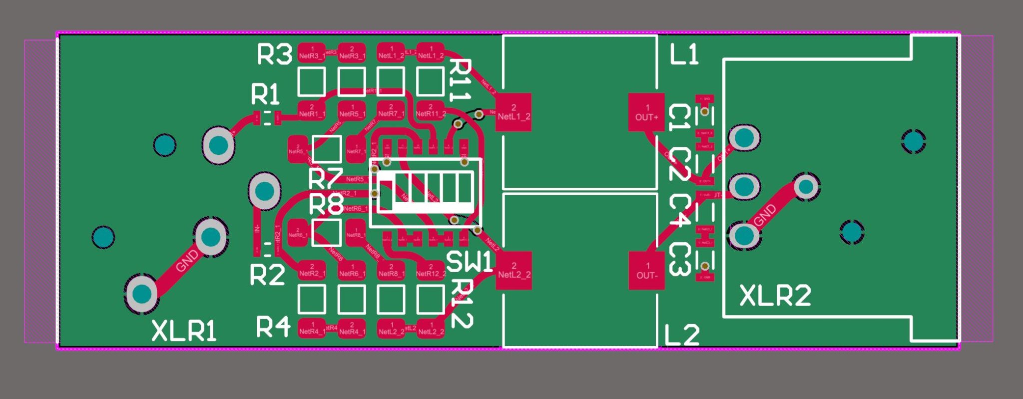

Maybe this is a dumb question, but why would you want to adjust to -30 dB vs. -40 dB or any precise attenuation? Wouldn't you want to go for the best achieveable suppression?The device is quite simple and inexpensive, strange that's not on the market already. Especially inexpensive(~$70) would be a version without the case as a PCBA which any DIYer can adjust by 4pcs trim-pots(2pcs for the 1kHz Twin-T -30db or -40db, another pair for 10kHz -30db).
I found 30db is stable, easy to get with no parts preselection, and enough to get -150db resolution at the same time. You can try to readjust It from 30 to -70db but it will be not always possible without very well caps matching. Also, need to understand that the buffer and diff amp THD aren't zero.
Usually there is no need for that, say, especially if using something like REW software which can compensate for whatever notch you have.But why would one want to adjust to a specific attenuation?
