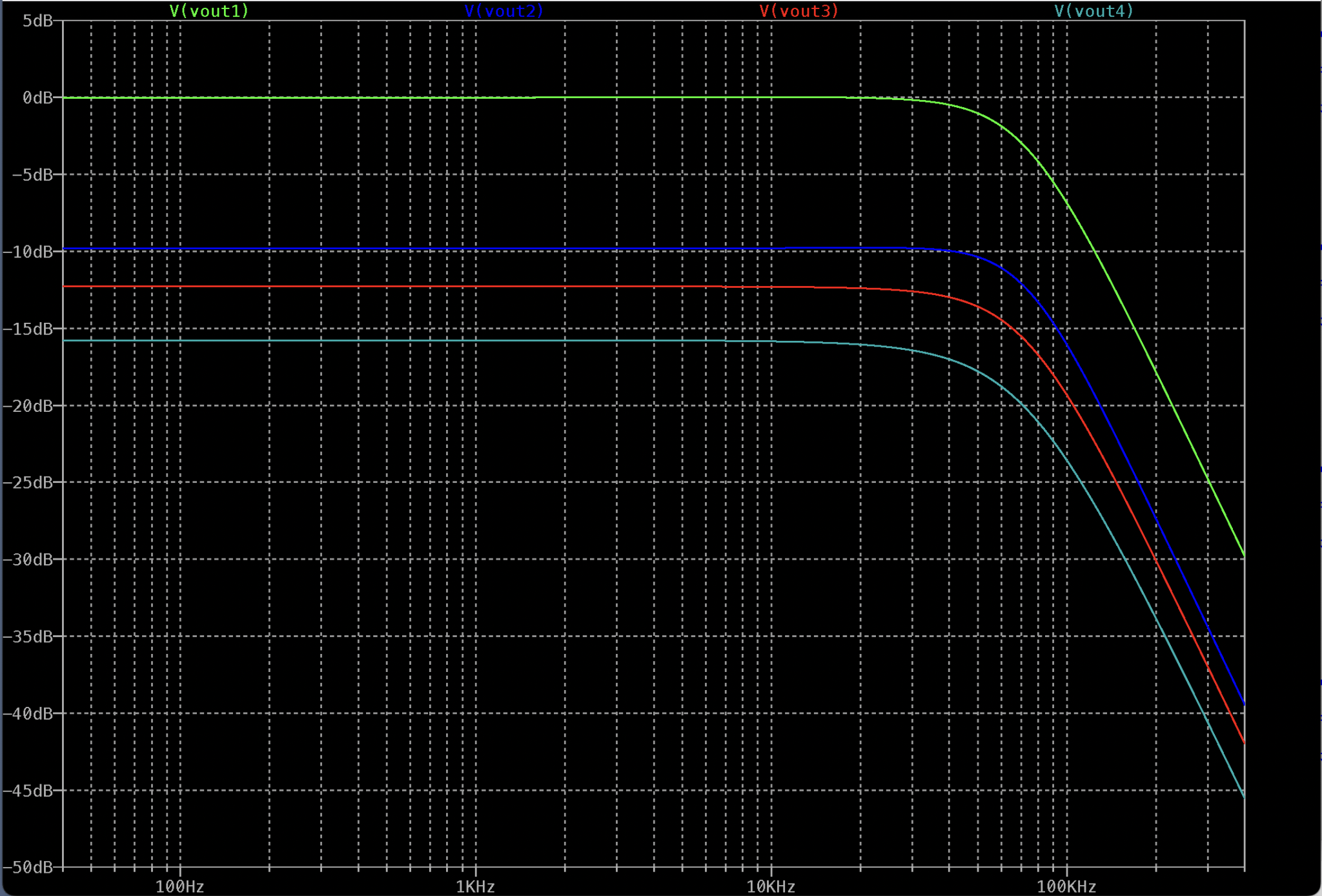

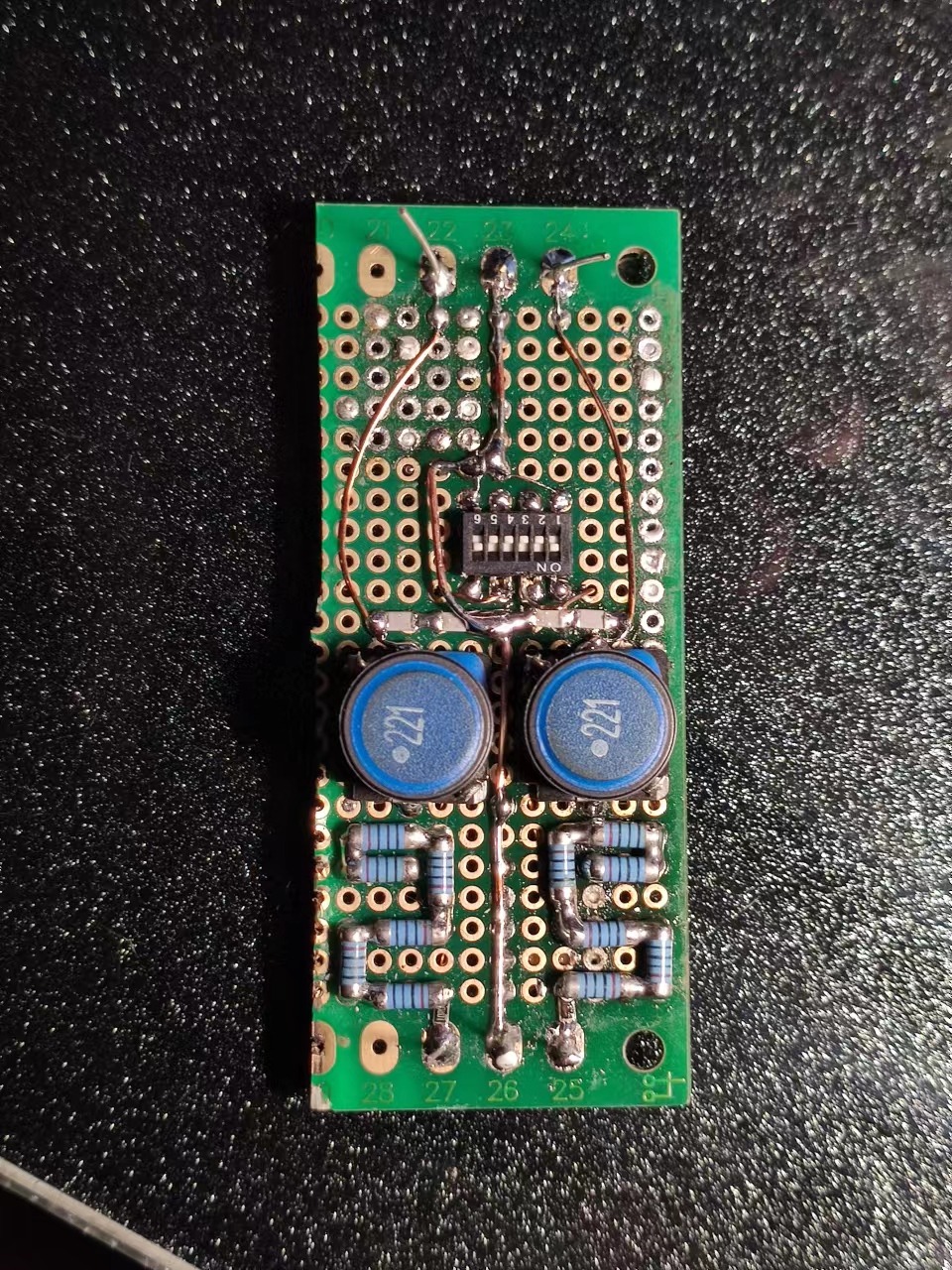

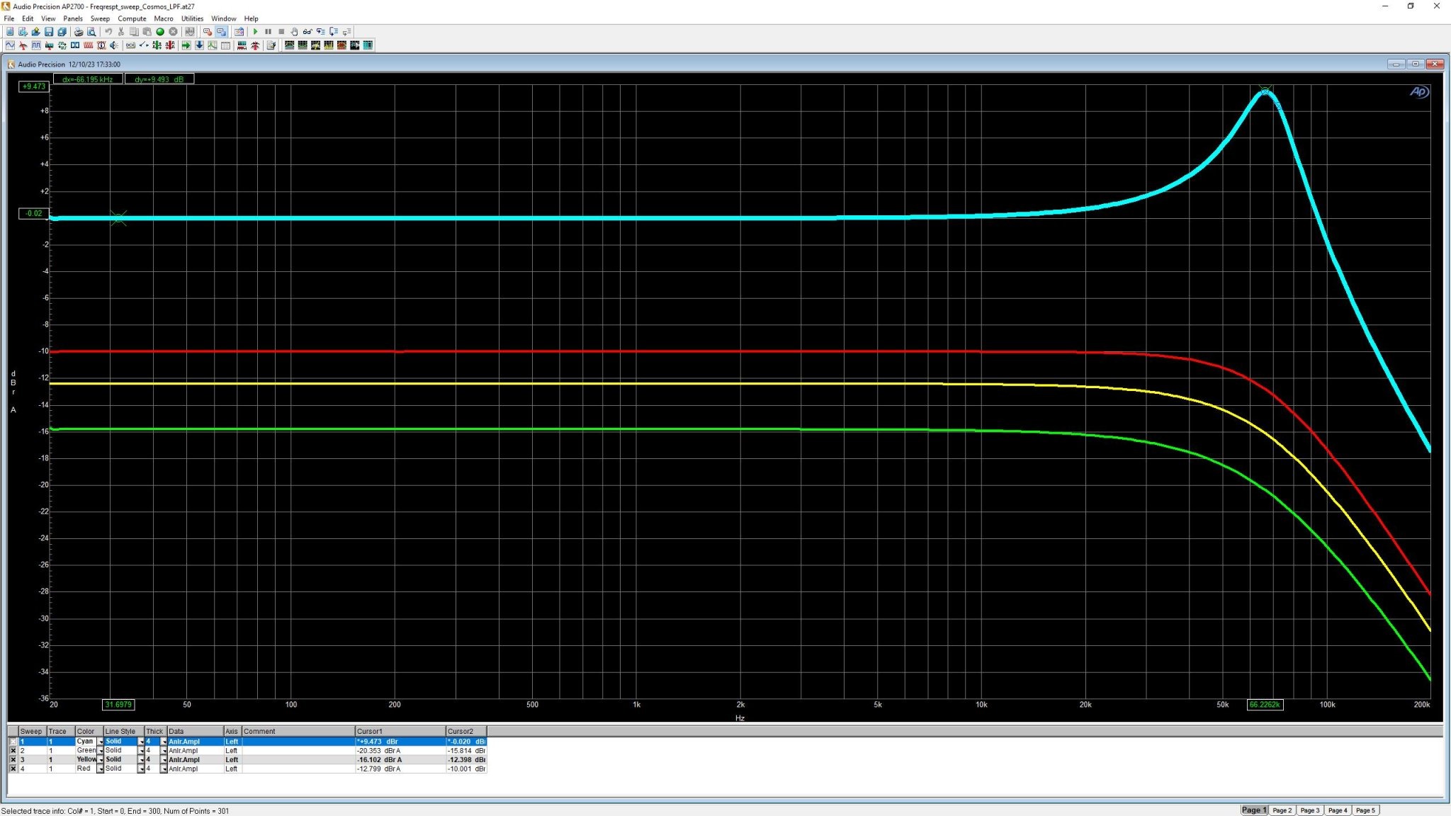

So, finally, I stopped on something like that:
As you can see, the only "0db" mode requires some postprocess EQ in REW FFT. However, as I mentioned above, that mode needed for the DR test i.e. BW20-20k and A-weighted, hence +.69db at 20k isn't really an issue. 18db peak at 70k perhaps may create trouble with chip DACs like CS43198/131, and better to add one more switch to alternate the termination 10k/1k, or keep 30-50ohm as a min resistor instead of 10ohm(I'm greedy regarding the noise so I'd like 10ohm). The R/r resistor divider steps could be different but I like 10 + 1000;600;400, from a total 5pcs 200ohm MELFs(2.5W together).

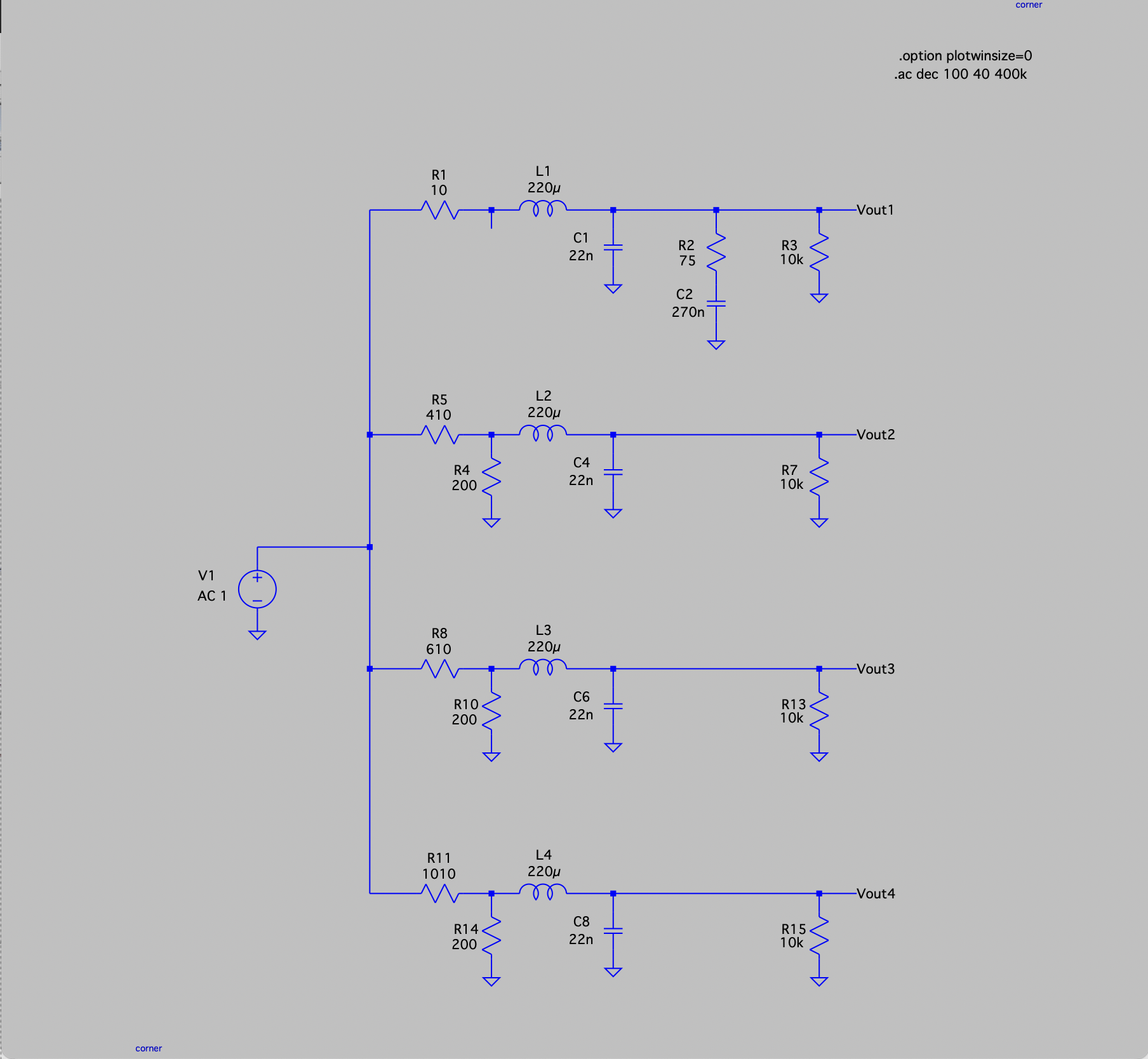

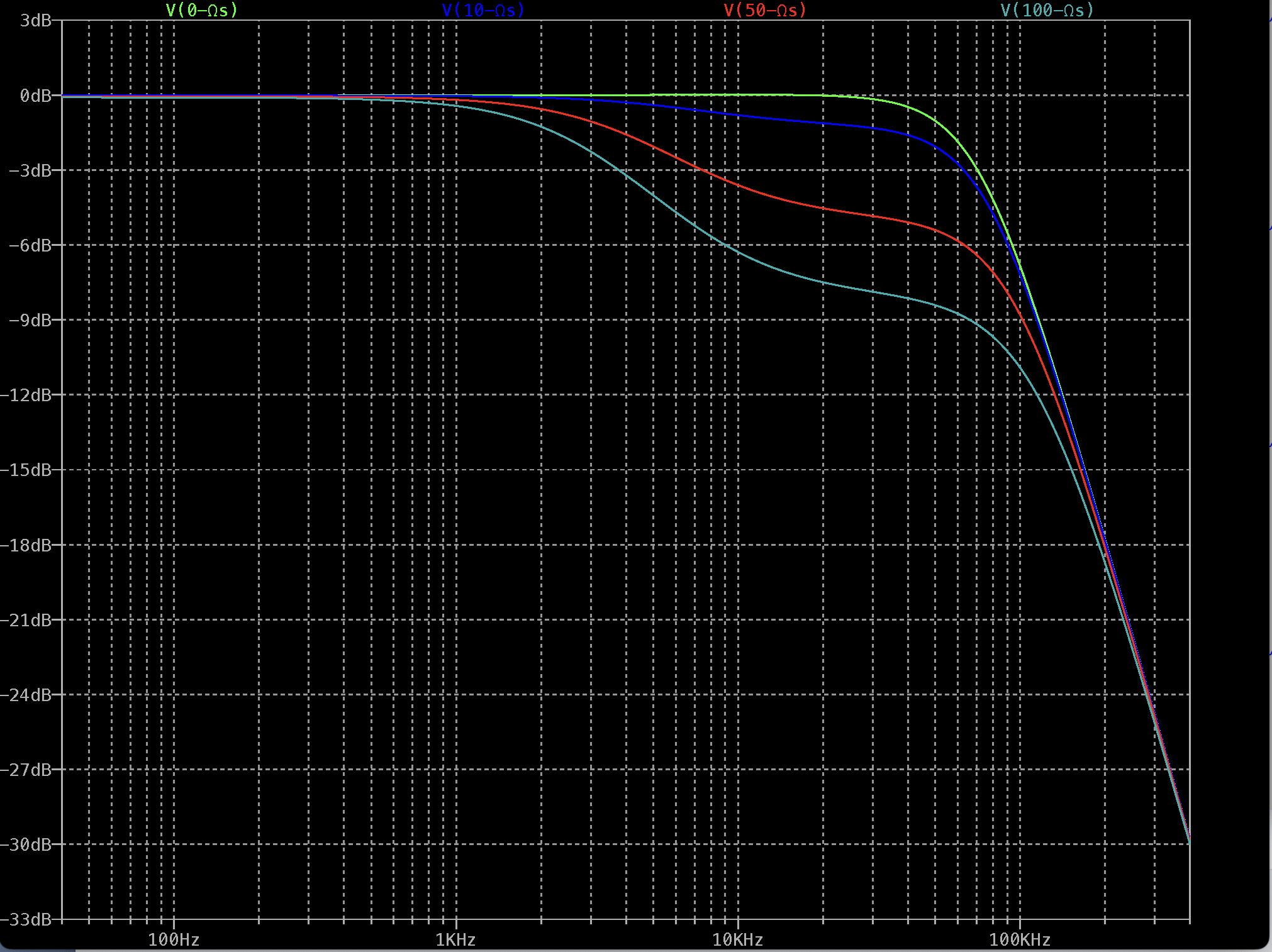

With higher source impedances, you get drooping at high frequencies with R2 & C2 in place. This shows what happens as you change the source impedance from 0 Ohms to 100 Ohms for the zero attenuation (10 Ohms at your R7) low noise setting:
Most of these filter topologies are far more source sensitive than load sensitive. You could fix that by changing the impedance of the voltage dividers at the inputs so that the source impedance is relatively constant. Make R4, R10, and R14 something closer to 10 Ohms and adjust the series resistors to get the division ratios you want. You might have to live with a minimum attenuation to get the flatness correct over a range of source impedances.
As usual, you end up with trade-offs between resistor noise and load impedance. Complex filter and switching or peaking and drooping.

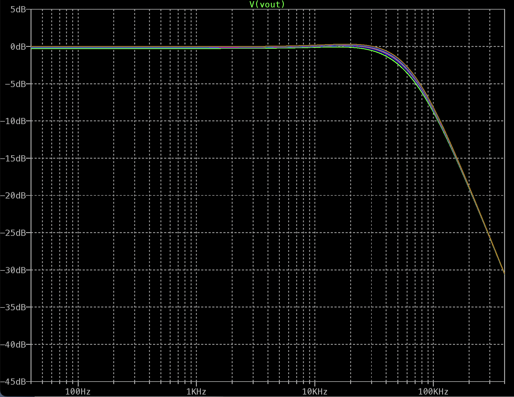

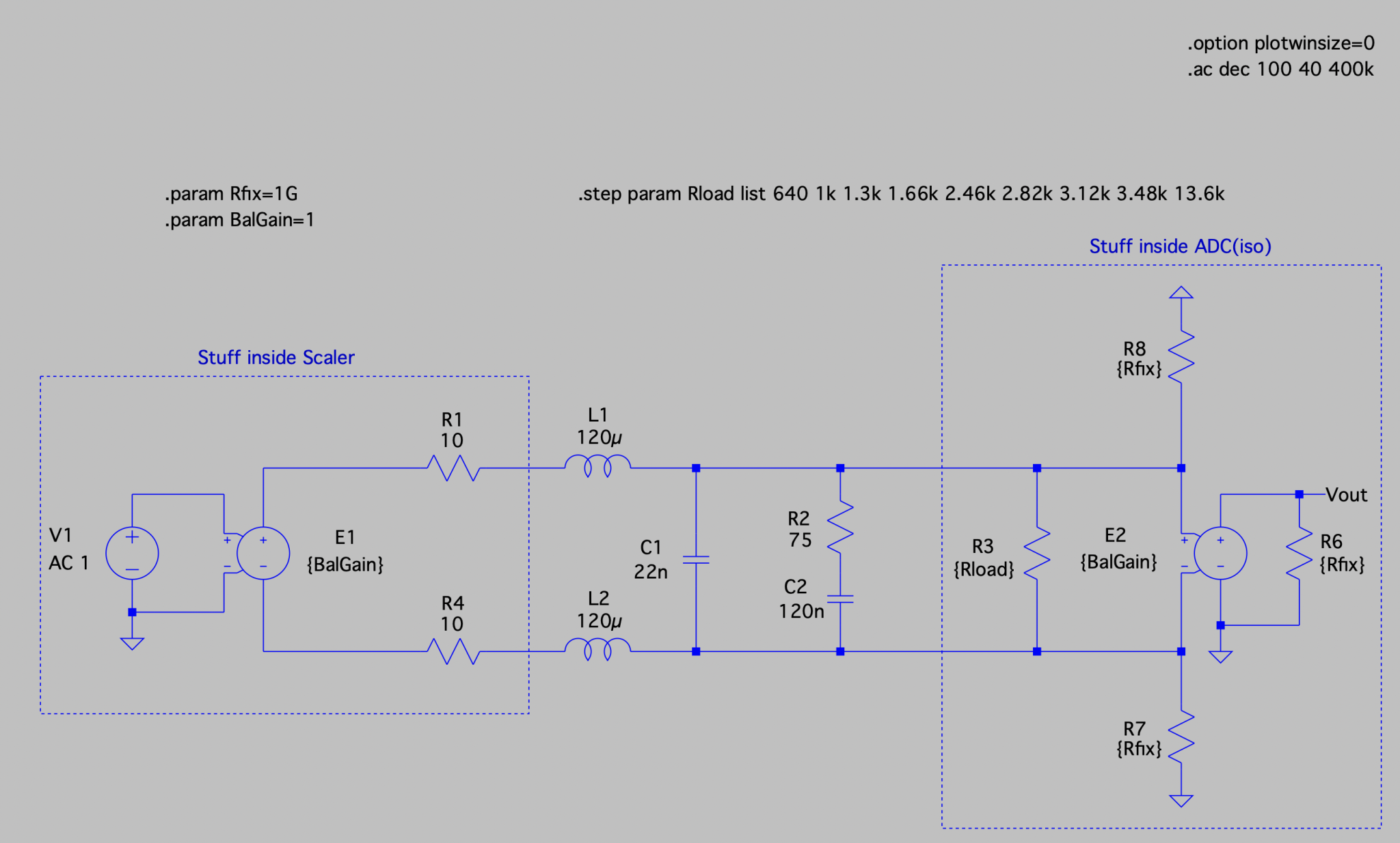

If any DIY readers want to make a balanced anti-alias filter that might go between a Scaler and an ADC(iso), here is a candidate. This could also go between a Scaler and an APU before the ADC(iso). Note: Rfix resistors are there to make LTspice happy - they aren't in the actual circuit.
This is what you get for frequency response for all the possible input impedances of the ADC(iso):
CG, Scaler has 10Vrms max input voltage i.e. isn't suitable for class D. Far not every ADC user has Scaler.

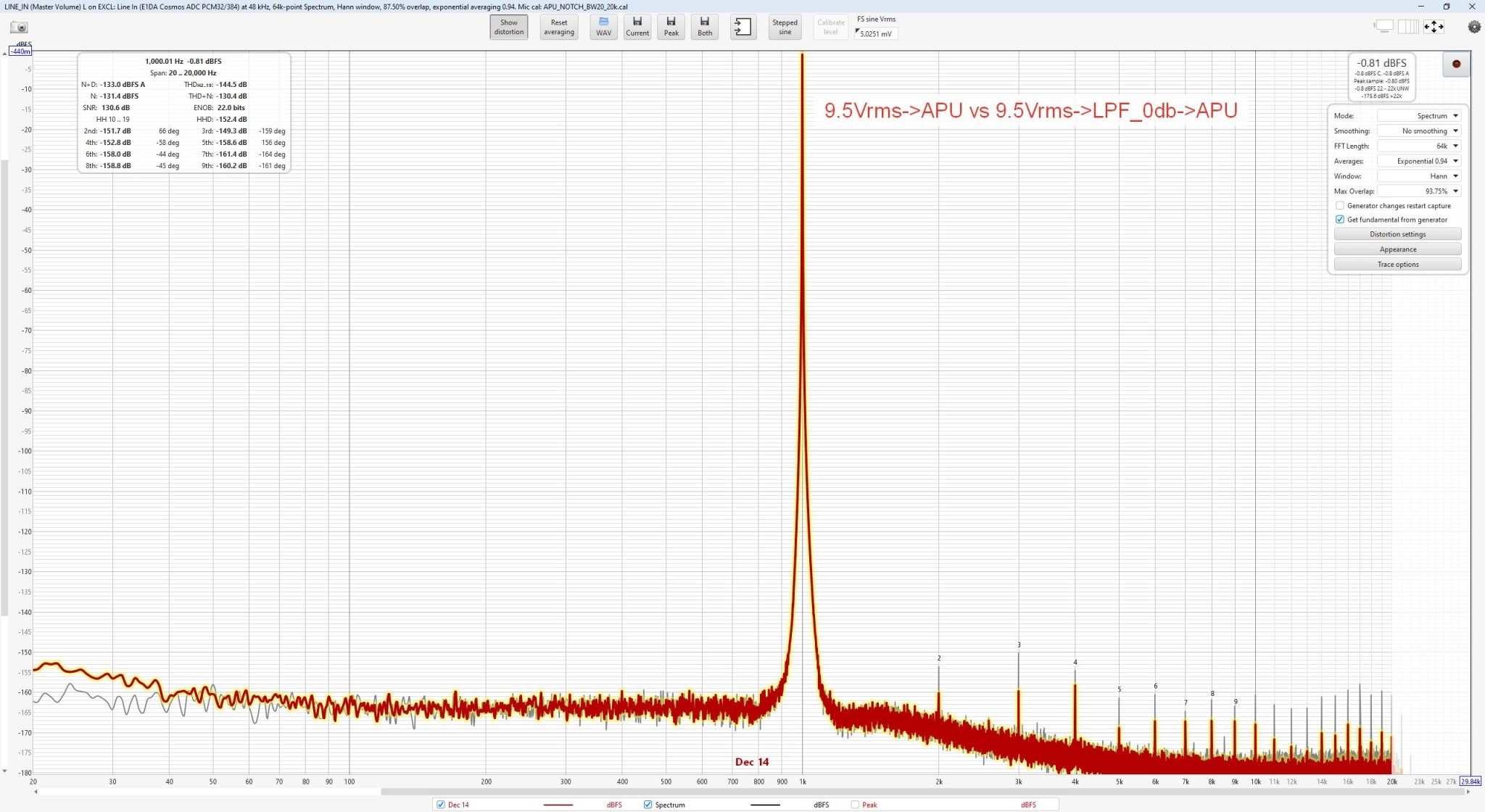

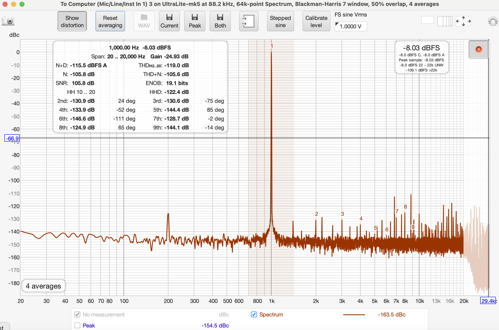

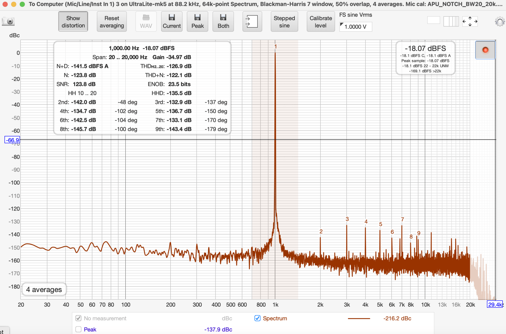

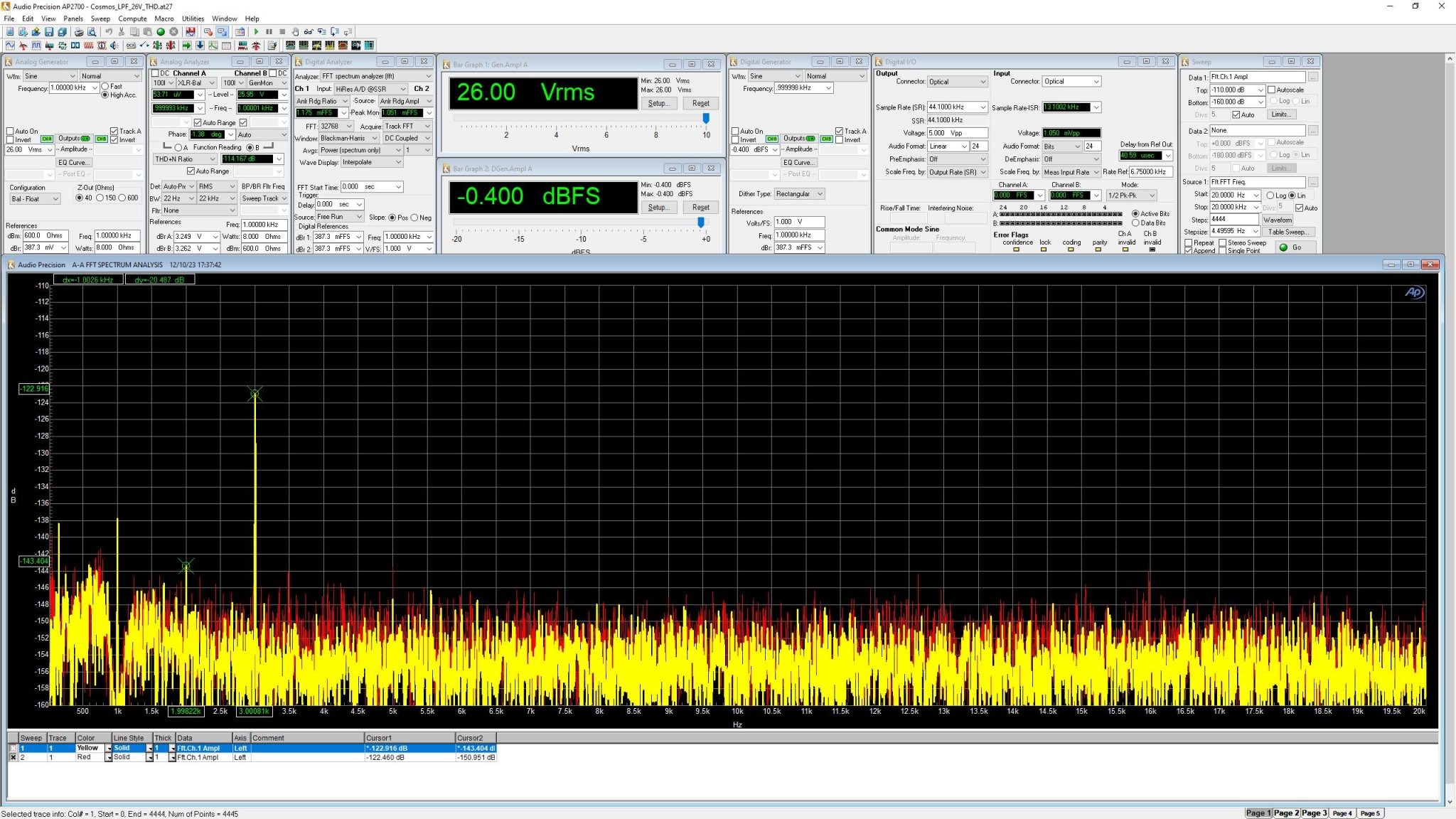

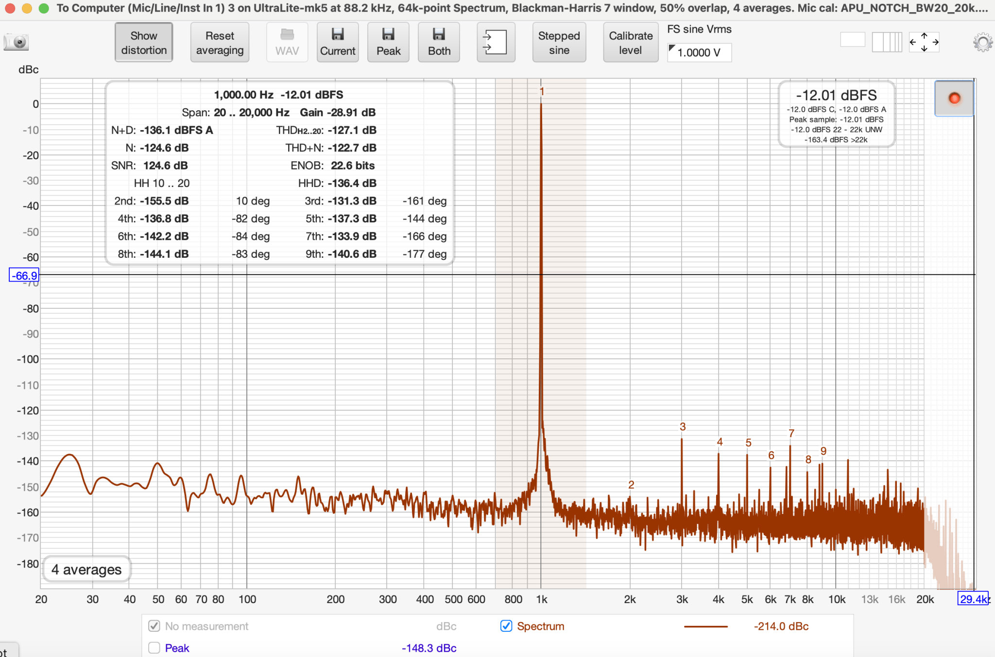

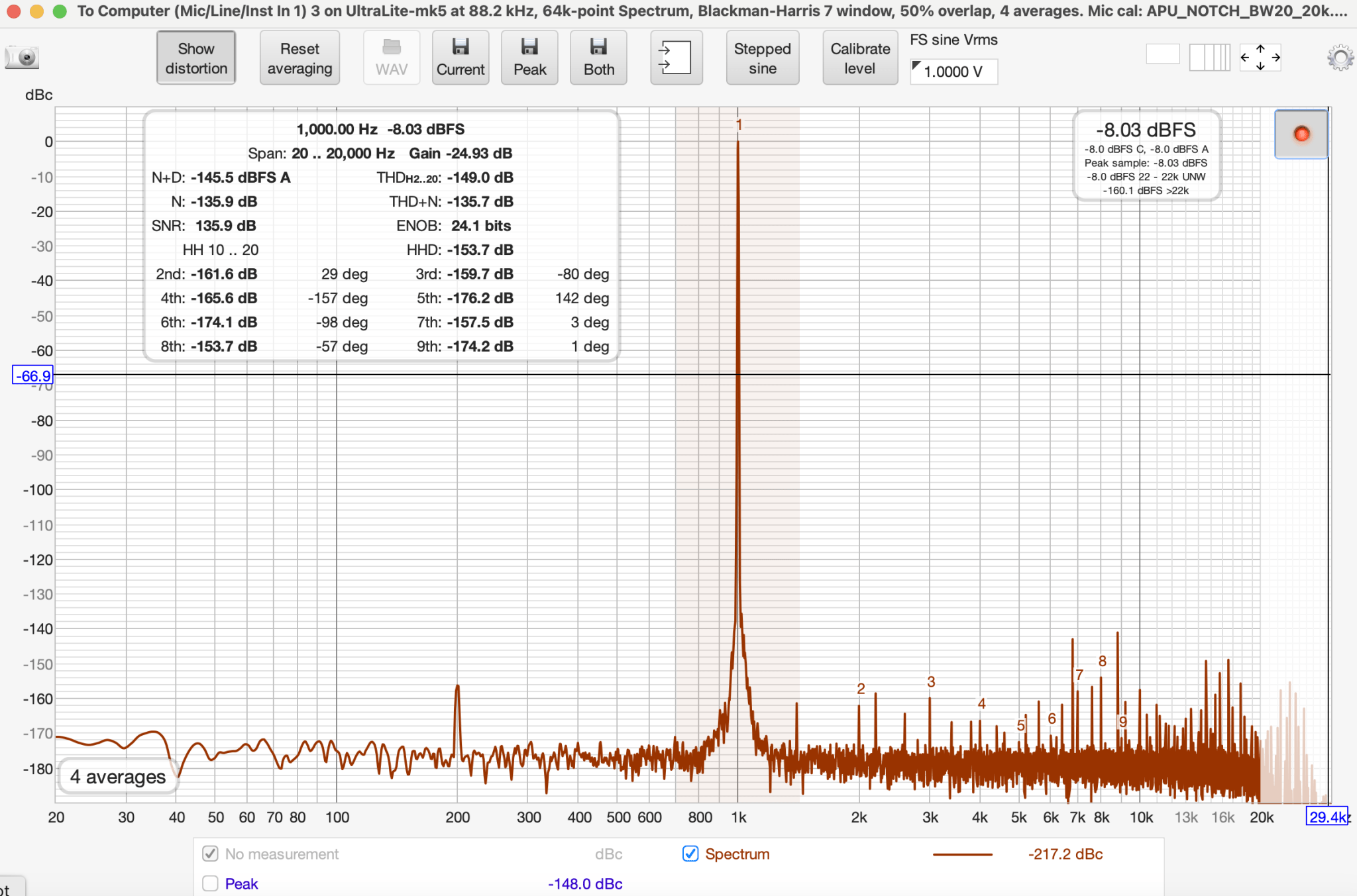

back to LPF topic, I think it is not too bad for such simple filter(loaded with APU's Notch inputs)

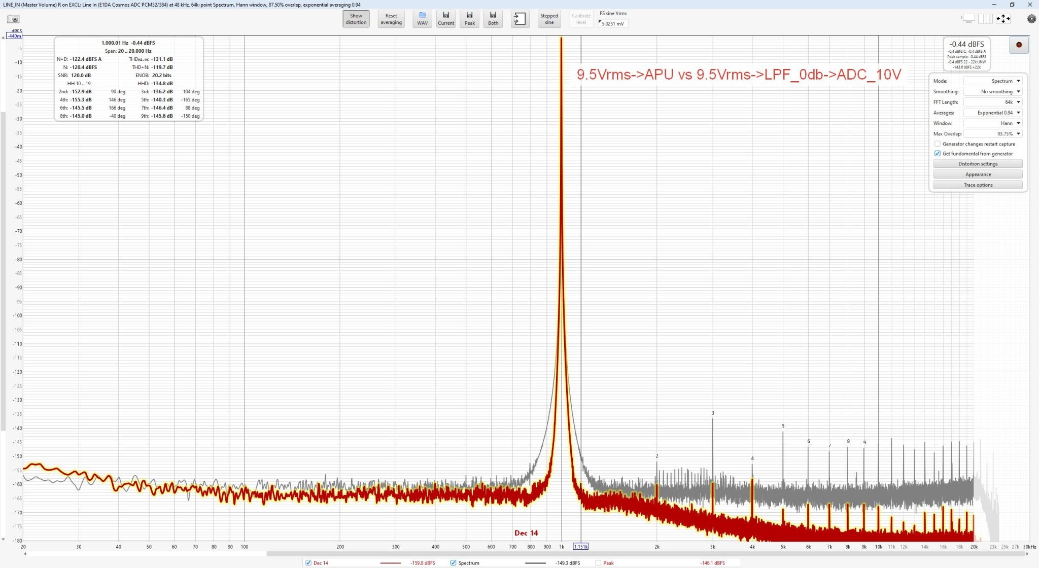

Loaded by ADC_10V LPF has worse distortions due to higher current through the TDK SMD coil, which should have a high current rating = size(SLF12575T-221M1R3-PF). That ADC sample has a residual H3 at -138db.
a scope, even 12bits has an awful linearity, and 30db of APU's Notch, for sure isn't enough. Any laptop's internal audio interface is a lot better for that purpose.For someone who as an APU, presumably its output is a time-domain notched-out distortion residual? If so, a PC oscilloscope app might be able to visualize it?
