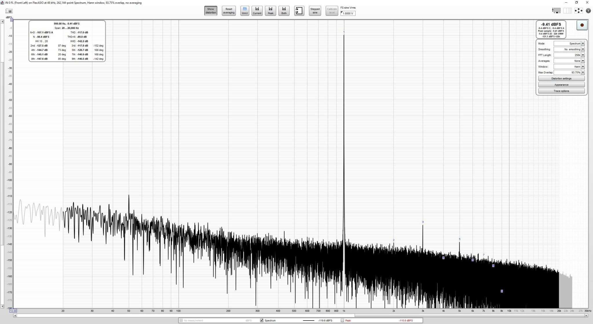

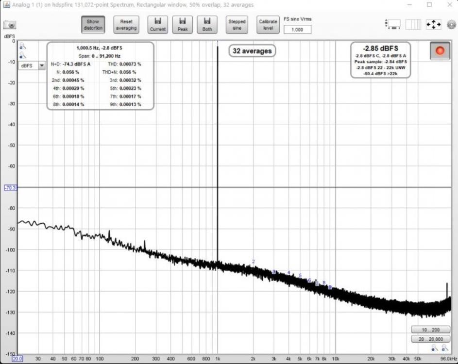

Hey, if I understand correctly, Cosmos APU+Cosmos ADC+RIAA combo outperforms "Ultra high spec. opamp MC/MM phono" at least for distortions, noise and RIAA accuracy(I never seen if DSP filter was less precise). Please, correct me if I'm wrong 😉
https://www.diyaudio.com/community/...p-elliptic-filter-line-headphone-amps.362390/
Cosmos APU+Cosmos ADC+digital_RIAA, 250uVrms input 10ohm source.
Well, as stated by author, THD of his preamp is limited by test system.
11. Unmeasurably low (limited by measurement system) distortion at rated output, including harmonic and many tone.
Maybe, but IMO doesn't look so because his H2 is covered by the noise floor. Probably his ADC was cray noisy, something like 16 bits. lt1115 has the same 1nV/Hz^.5 as THAT1510, so the result shouldn't be 8db worse indeed.
The hunt for the lowest THD + noise is IMO for RIAA preamp pretty useless - compare it with noise/hum/thd of the mechanical MC/MM pickup system of the turntable...
exactly, I would like to try the first mod of my turntable as adding the balanced wiring. Under my apartment I have a few teslas charging every evening, and I very well know when looking on the FFT. A balanced MM->APU cable will help for sure.
