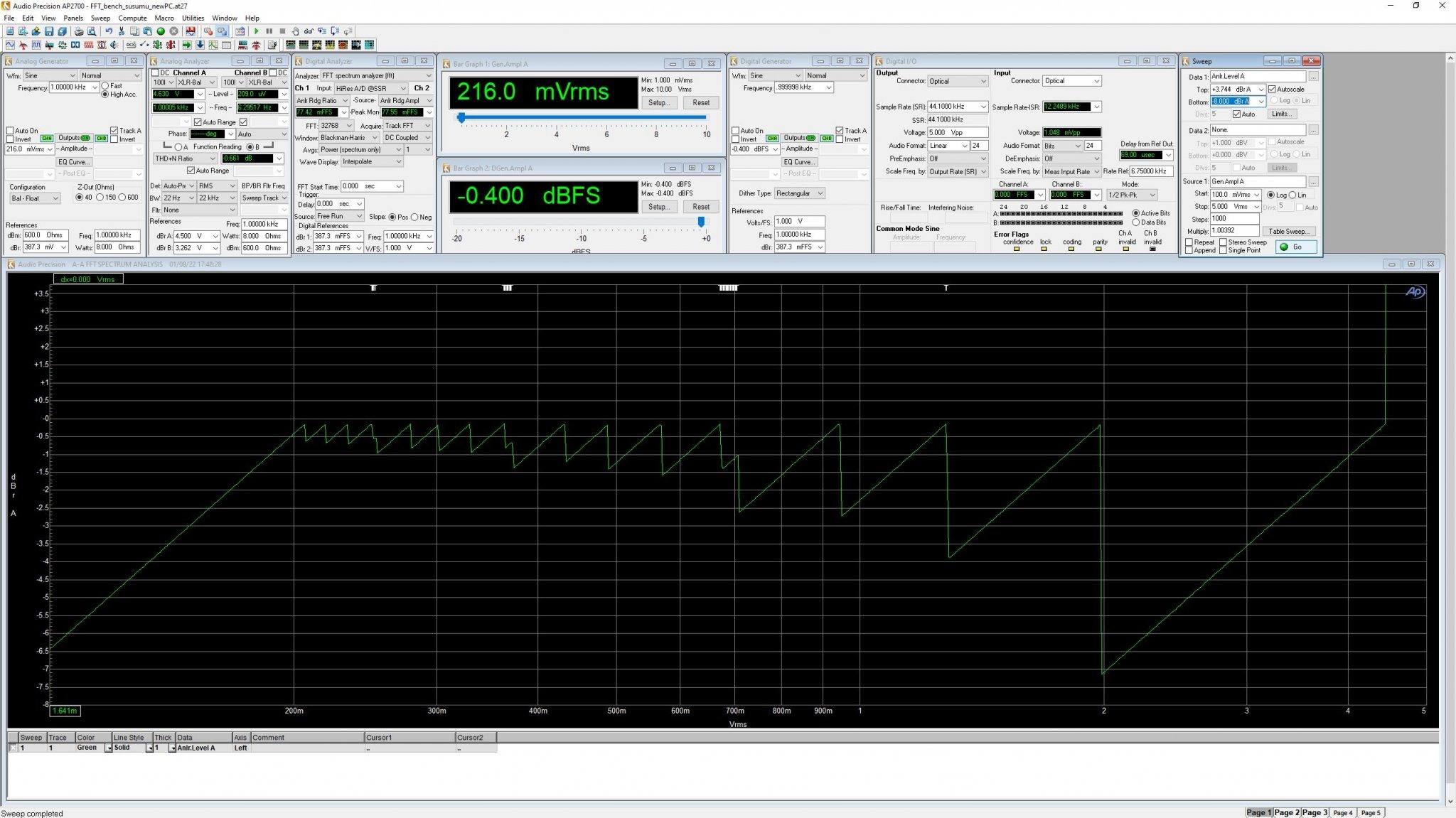

Ok, one more time, what I have:
1) AP SYS2522 output with 1.8mVrms feeds the Cosmos APU with 60db gain to Cosmsos ADC with 1.7Vrms sensitivity.
2) I clicked on [Calibrate level] button in REW, and entered 1.8mV. After the calibration REW starts to show 1.8mV level the same as AP.
3) With a shorted APU input the APU+AP noise results vs Cosmos APU+ADC results have just .4db mismatch.

Now it is clear - if you did calibration with known level from AP then noise level is corectly displayed in nV.I did not read REW help and I have no idea what indicates the window you asked for. I simply don't need to know that as many others things in REW(there are a lot of tools&options). I guess "Fs" could be "Full Scale", actually, to me "Fs" is always like a Frequency of Sampling.

With 60 dB of APU and 1,7 V of ADC I expected FS (Full Scale level in V rms) in REW for this combination around 1,7 mVrms. It seems that there is some deviation in ADC sensitivity (or APU gain), so for propper V/dBV/dBu indication some basic calibration is needed.

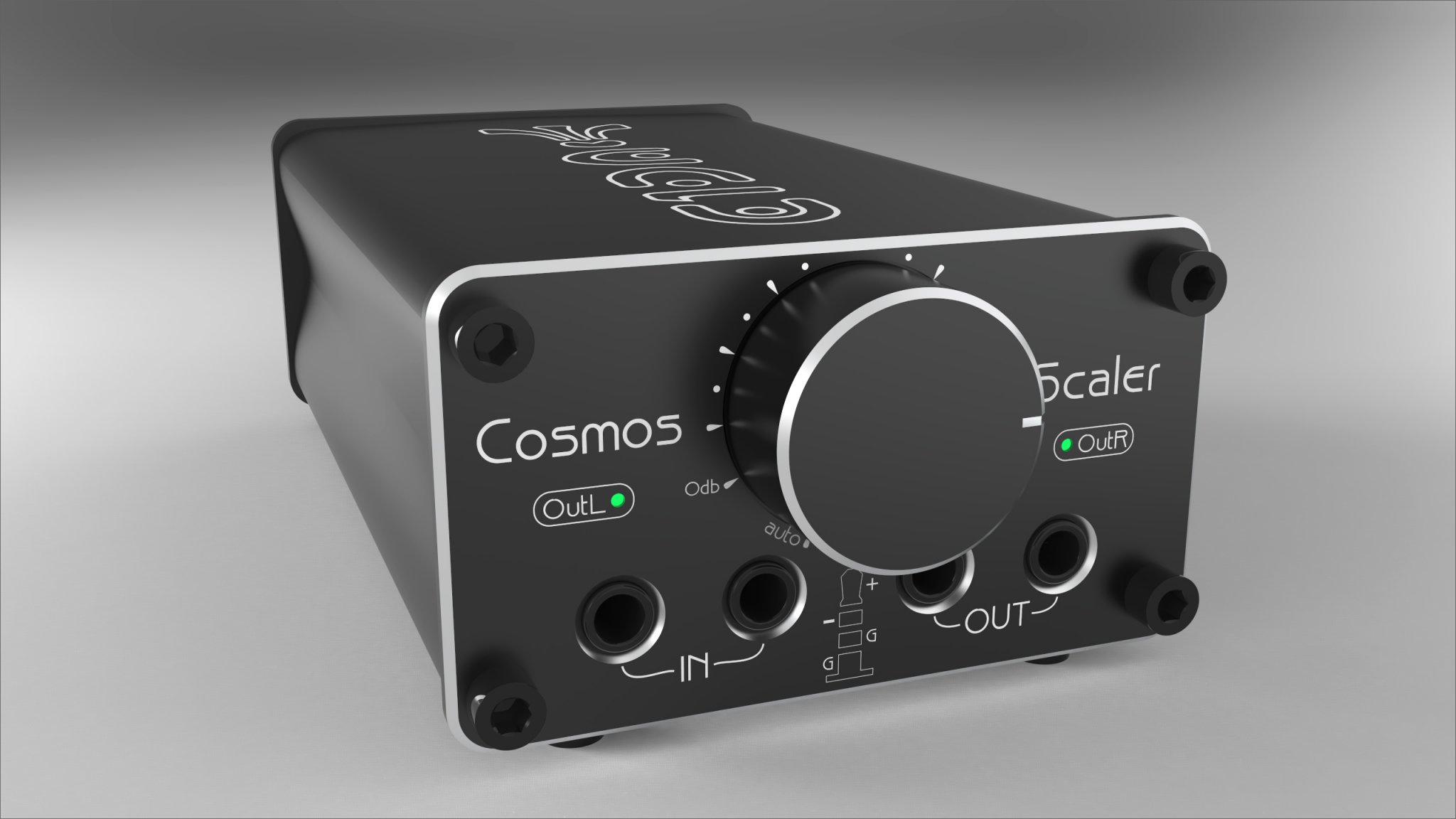

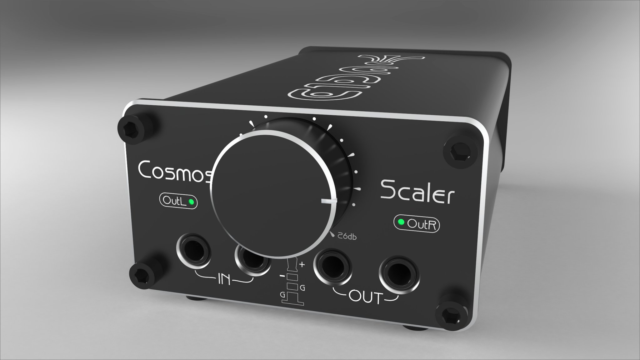

Actually, I already described that simple stereo preamp for Cosmos ADC yesterday as I think.
Min gain 0db, max 26db thru 16 log steps
Zinput 200k/100k balanced/unbalanced
Zout 20ohm
USB-C powered 200mA
Max input level 10Vrms
Max output level 10Vrms(actually up to 20Vrms but Cosmos ADC doesn't need >10V)
Residual noise with shorted inputs 250nVrms(A)
3 Levels LED indication, Blue if 1.7Vrms<output<4.5Vrms, Green if 4.5Vrms<output<10Vrms, Red if >10Vrms. So, there are 3 thresholds, the middle one is the Auto-range target.
Calibration mode activating after 5 times switches from "0db" knob's position to the "Auto" i.e. 0/Auto/0/Auto/0/Auto/Auto/0/Auto/0
in the calibration-mode Scaler will turn White LEDs, and measure its output voltage and memorize that as a new threshold value. After 128 times level AVGed, White LEDs are Off and Scaler back to the normal mode. If during the calibration process the output voltage was <1Vrms, all 3 thresholds will be presented to the default 1.7/4.5/10.
By the default blue=1.7V, green=target=4.5V, red=10V. If you like to change the target for the 9V, as an example, you need to feed Scaler with that voltage sine, 5 times switch manual/auto/manual/auto/manual/auto/manual/auto/manual/auto during 2s. LED will change color for the white for about 2.6S, after that red LEDs will do flashing during 1s. That means that the red-LED threshold has been updated from default 10V to 9V and the target changed from default 4.5V to the 9v. If you'll give Scaler 2V instead of 9v, you'll see 2.6S white LED, next 1s of blue-LEDs flashing i.e. blue-LEDs threshold now is 2V(and the target for the autorange too) instead of 1.7V etc.
