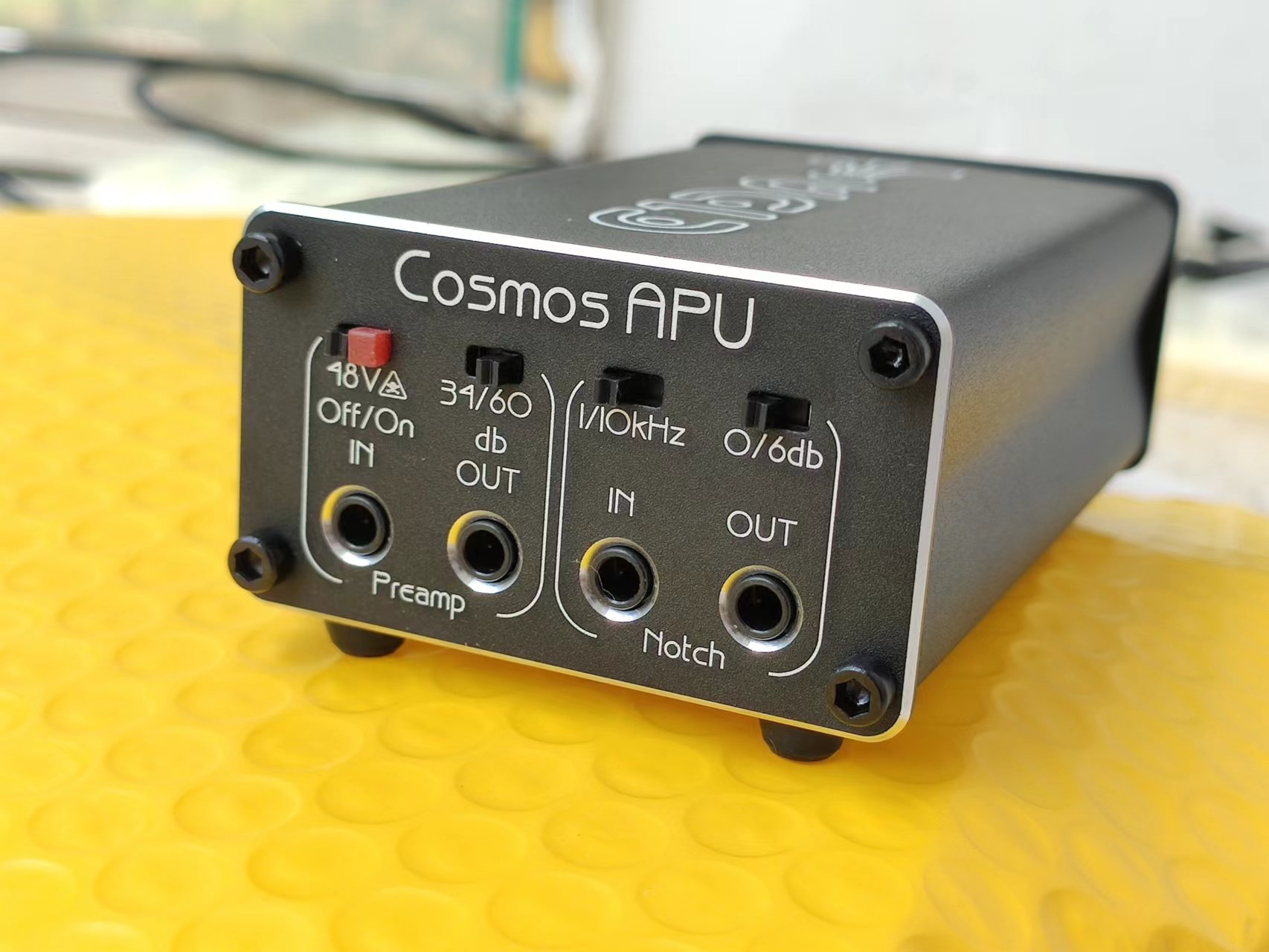

and about the 48VDC protection, we adding such blocking red rod to prevent accidentally switching ON.

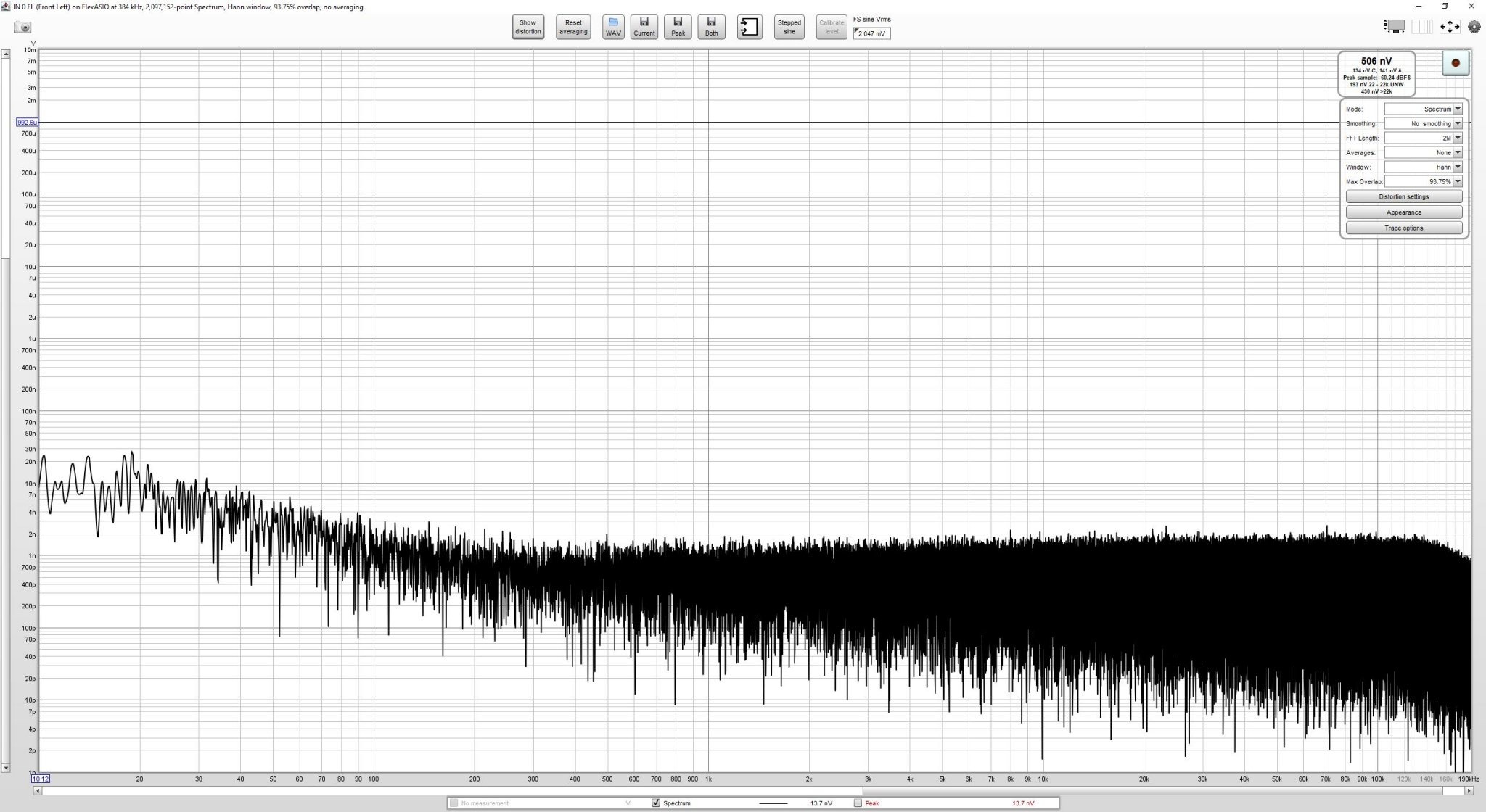

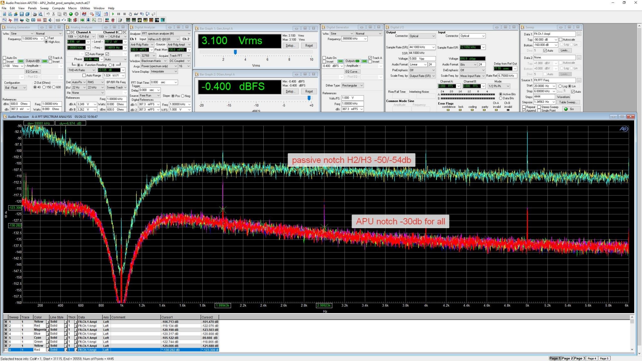

BTW, about the noise, in our discord I've got the question about the broadband noise FFT for a combo Cosmos ADC+APU, and the result looks like that:

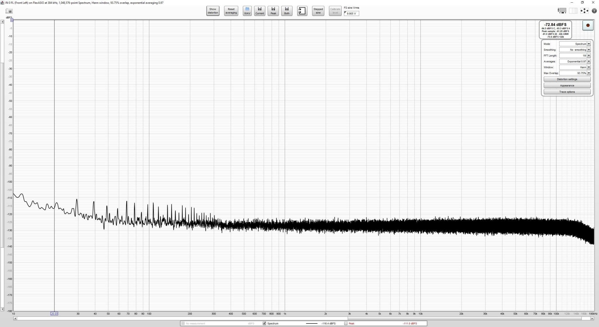

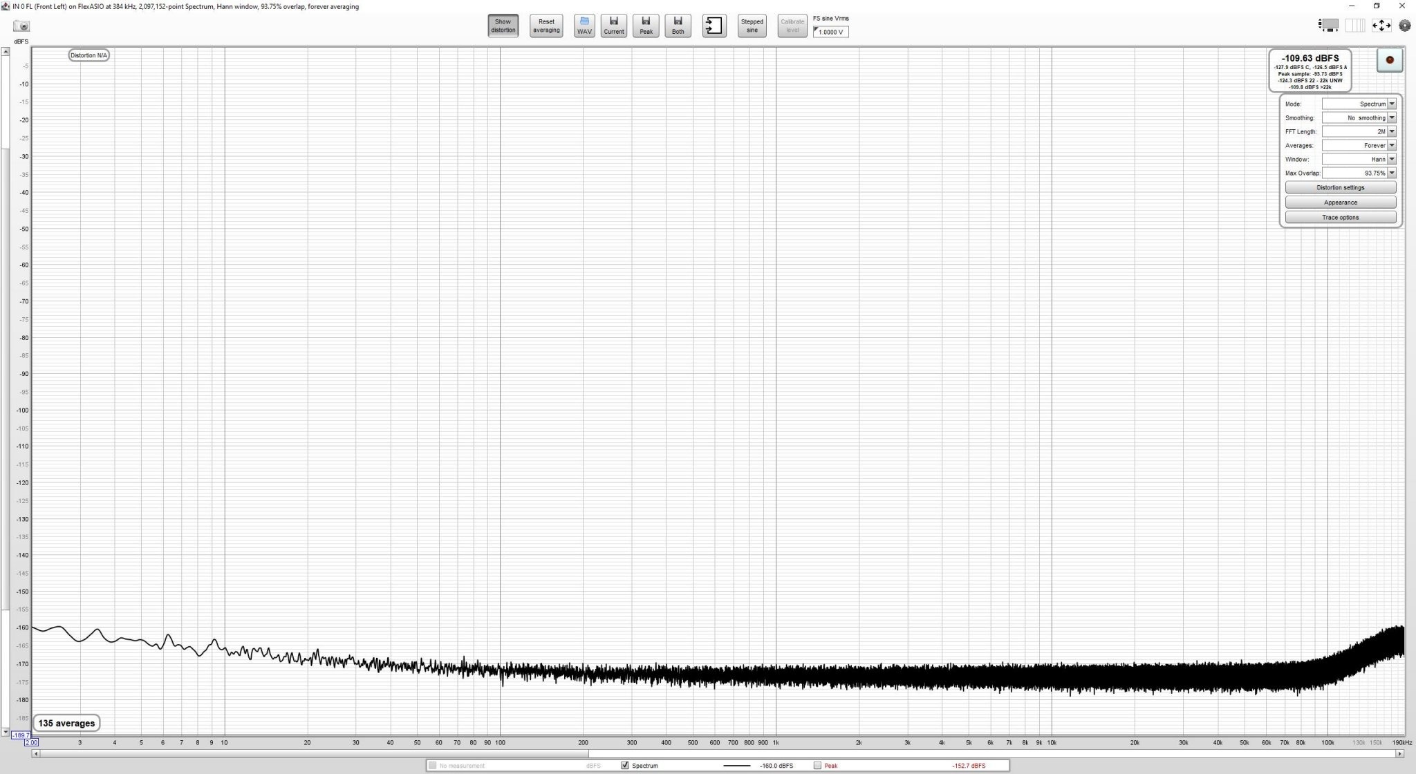

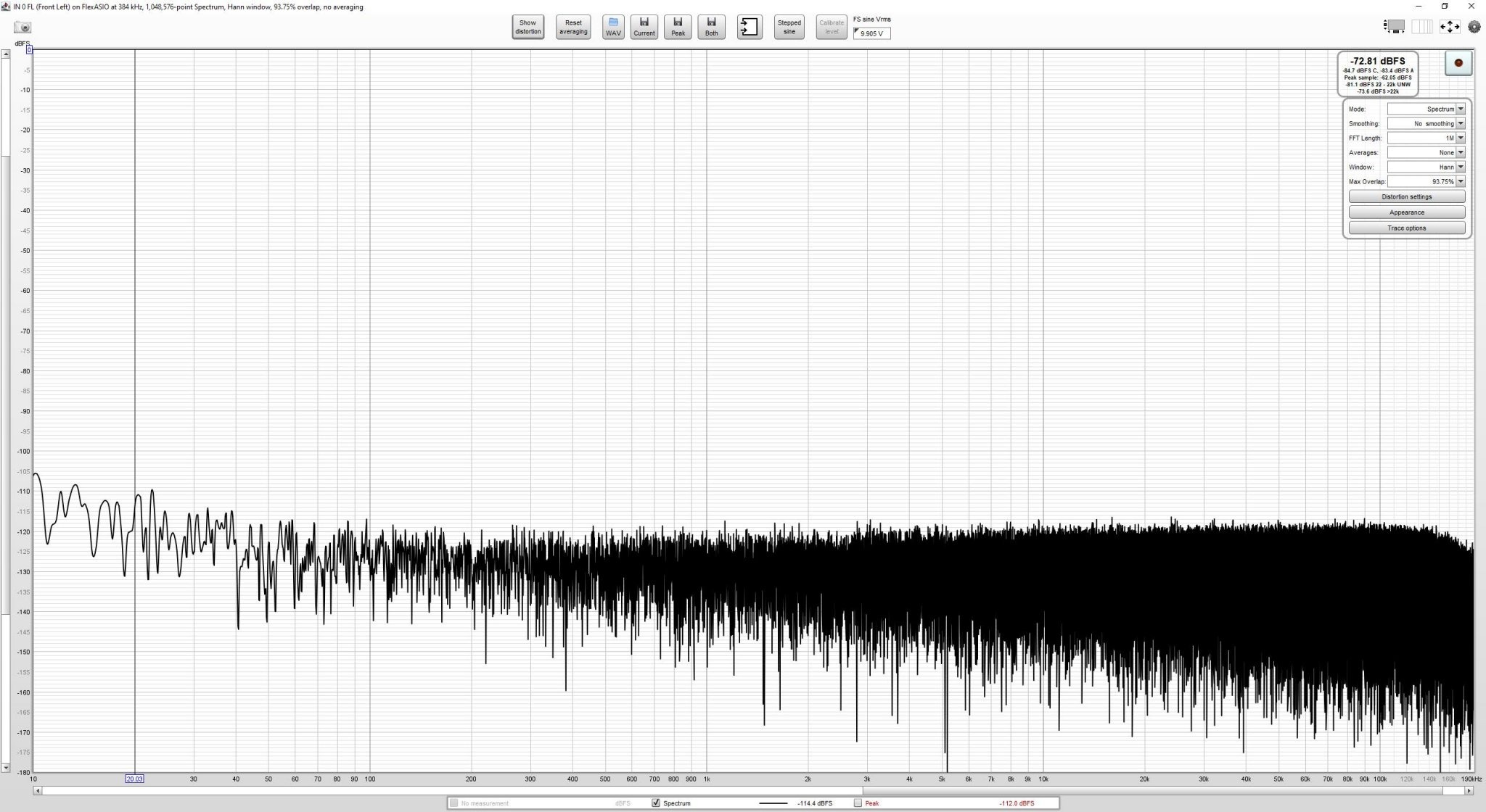

As you can see, THAT1510 1nV/Hz^.5 is really there, and 1/f corner is about 100Hz. Better to see that with AVG(please note, the FFT above is for another APU sample, the next two FFT are from a bit less noisy sample):

Very nice Ivan, da. BTW, what is the main reason of elevated LF noise of the ADC, is it the current noise of input opamp?
how low is "LF", show me that pls? If <10Hz that's perhaps due to the impedance of the aluminum caps(220uF ) increasing, or maybe your FFT is too short and you can observe the DC bias of the ADC chip.Very nice Ivan, da. BTW, what is the main reason of elevated LF noise of the ADC, is it the current noise of input opamp?

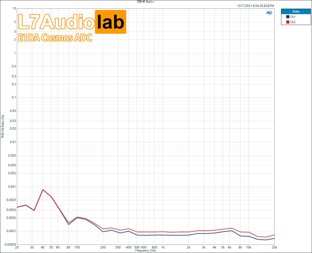

Do not be touchy, please, I was talking about your first plot in post #32 or measurements at l7audiolab
Oh, I did add that function to the Cosmos Scaler in the last 2 versions, now Scaler works as a modest auto-ranger with coarse 16 gain steps yet. I made that clearly by the way because I had an idea of using a variable potentiometer for the gain setting but they are bad for THD or huge and bloody expensive. Hence, I did go with relay+MCU. The MCU has a lot of free resources and I decided to add 3 color LEDs indications of the output level. After that, the MCU still had resources and I did implement auto-ranger as well. The same day I got an idea to add a calibration procedure for the auto-aranger, so now you can set any of 3 thresholds for LEDs Blue(by default 1.7V)/Green(by default 4.5V)/Red(by default 10V), where Green is the auto-ranger target threshold. Simple solution and virtually free.We need autoranging input divider 🙂😉.
Ahh, Ok, it is L7 measurement/setup problem, Cosmos ADC has no such THD+N 40Hz bump at all. The corner from 200Hz .0001% to 20Hz .0003% is real, I'm not sure about the reason yet. I did adjust the lowest H3 at 1kHz -.5dbfs, you can try to readjust the lowest H3 at 20Hz instead, but pls do not lose the original H2/H3 Tweak_Cosmos app setting.Do not be touchy, please, I was talking about your first plot in post #32 or measurements at l7audiolab
