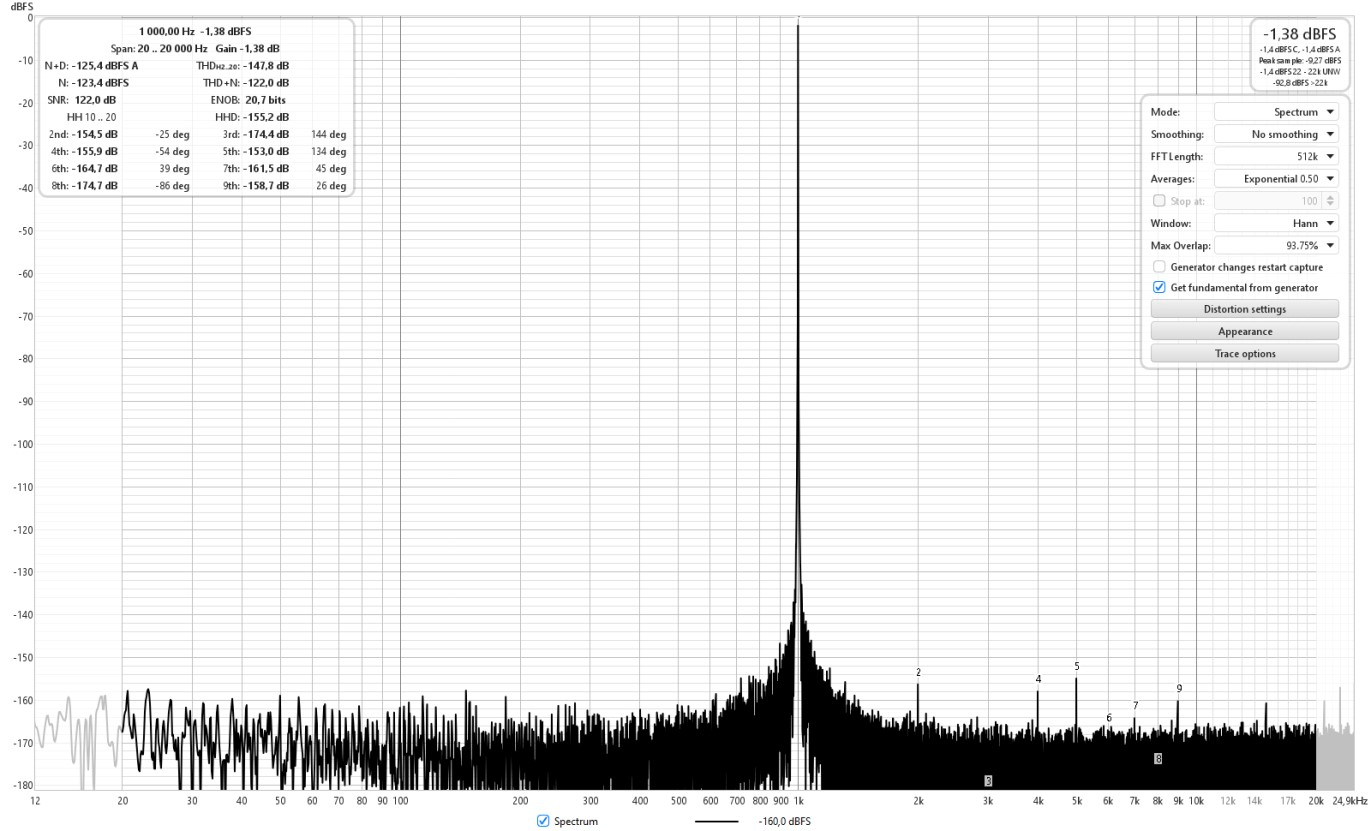

The guy who helps me with 9039S beta testing, reported that his result was even better than mine from the video I posted yesterday 😉
THD@1kHz is close to -148db. I don't know how to make Cosmos DAC better..

Usually, I use another sine gen but today I run REw's one and got THD -146db on the same sample! Completely vanished H7 for instance.
That suggests there may be some cancellation of harmonics. Its an issue when the harmonics are that low. One trick- add a low pass filter to the source, It will shift the phase of the harmonics altering the cancellations. If the harmonic signature does not just follow the LP rolloff then you have cancellations to sort out.
there is no LPF just bare 9039Q2M and I/U(OPA1612+AD8397 composite), and no any anti-harmonics are used. What I see is the two digital gens difference, and REW is better. One gen THD -143db, REW's gen -146db with the same sample.
I was not clear- the LP filter is a diagnostic tool to test for harmonic cancellations not necessarly part of the system.
A difference in distortion from digital sources suggests a math problem, truncation or a difference in dither level and implementation. Virtins give some dither options. A digital loopback may show some differences relating to the digital signals.
I have noticed a difference between the macOS version of REW and the Windows version, too. There's often even a difference between the generator in REW and a saved .wav file of a similar signal played back through REW into a DAC. Not a lot, but along the numbers you suggest.

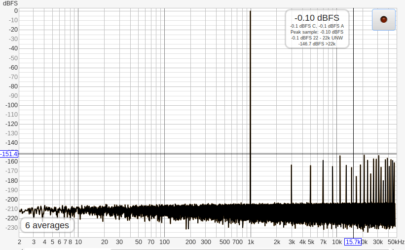

Last time I checked, REW's generator was flawless in a digital loopback test, both on Windows with ASIO drivers and on Linux. Same results than when doing an offline FFT from file created by the generator, saved as 24bit PCM *.wav.
Dithering has to be set properly of course, that is, to 24bits or less, otherwise harmonics at ~-150dBFS may appear depending on the ratio of the test frequency vs sample rate.

Yes. For example, 1khz (exact, not nearest bin center) with 96kHz SR looks like that in a 4M FFT, without dithering. The sample train consists of only 96 different values and those are truncated/rounded to 24 bit, hence the accumulated error.by "less" you mean 24bits, 23bits and so on i reckon? Just to be sure...
Thank you, and appreciated.KSTR, I do all work by myself and things go slower than I wish. For example, 9038S I tried >10 PCB versions before I got a decent THD+N performance under 16ohm load. The first version I had in Jul 2023, and only in Apr 2024 I'll be ready for production. The next model is Cosmos DAC which has to be even better, and I have no idea how. My design reminds a slow fine-polishing process, I can't say if I have plans for something else until I finish the current model.
One small caution- using an exact submultiple of the sample rate won't "exercize" all the bit levels. 997 Hz would be enough off to run through all the levels.
