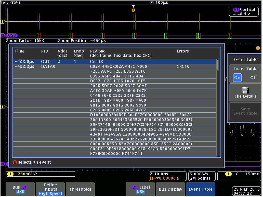

I have the TEK compliance and evaluation setup for USB (diff probe and software) here at the office as well as 2 protocol analyzers. Believe me especially in HS with high sample rates your getting USB errors and since Isosynchronous is not error correcting this can be a problem.
I have been asked to test more than 50 USB cables from $5 to $5K, I have some real dogs. So here is the problem and one of the reasons why HS USB sucks. So a DAC is primarily getting data from the host so BANG BANG BANG... then an IN request the cable, DEVICE and HOST must now turn around. Some of these cables have really low capacitance and yet they have terrible overhang. That's when the last transmitted signal is still present when the next preamble comes down and that packet is screwed.
The other problem is when you have a large packet, say DSD or 32/384 and that packed comes down and the device trains on the preamble, but by the end the clock is off enough that the samples at the end are not read correctly.
How do I know this, well the TEK was good at that, it didn't add up the BCC errors. They gave me the dev kit but who has the time to explore that much code to figure out how to keep track of errors? not me....

Here is a typical screen shot of the TEK finding a BCC error in a HS high sample rate array of 24bit samples. Sorry there is no way to group the data which makes it a bit of a pain when it's grouped in 16bit chunks like this.

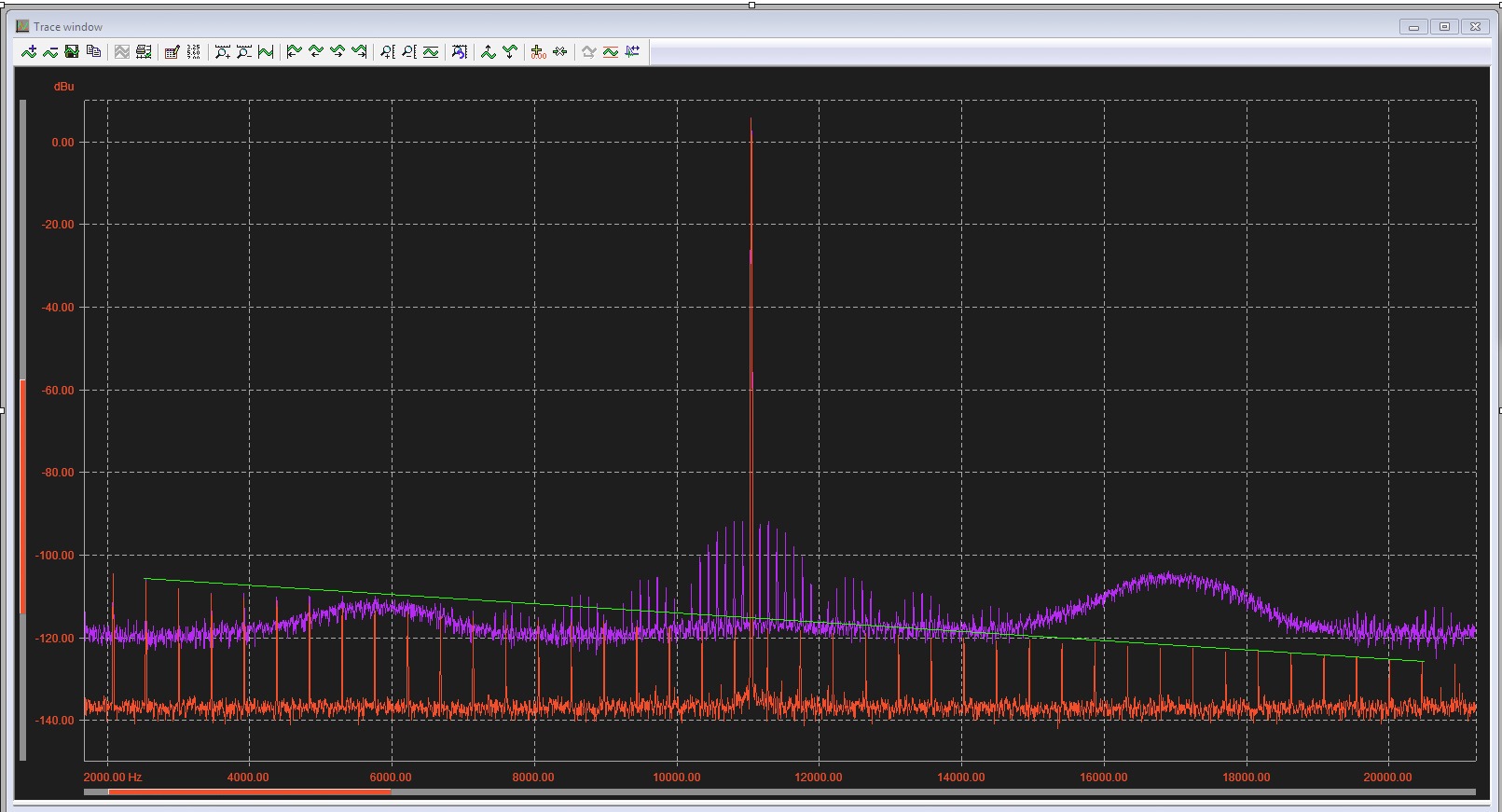

Also if you don't think isolation is important here is an example of a well respected dac when I sent the JTEST down. Purple not isolated, Red isolated High Speed. CG and I have done a lot of isolation work. USB in general especially with USB powered devices like dacs and interfaces really need as much isolation as possible.

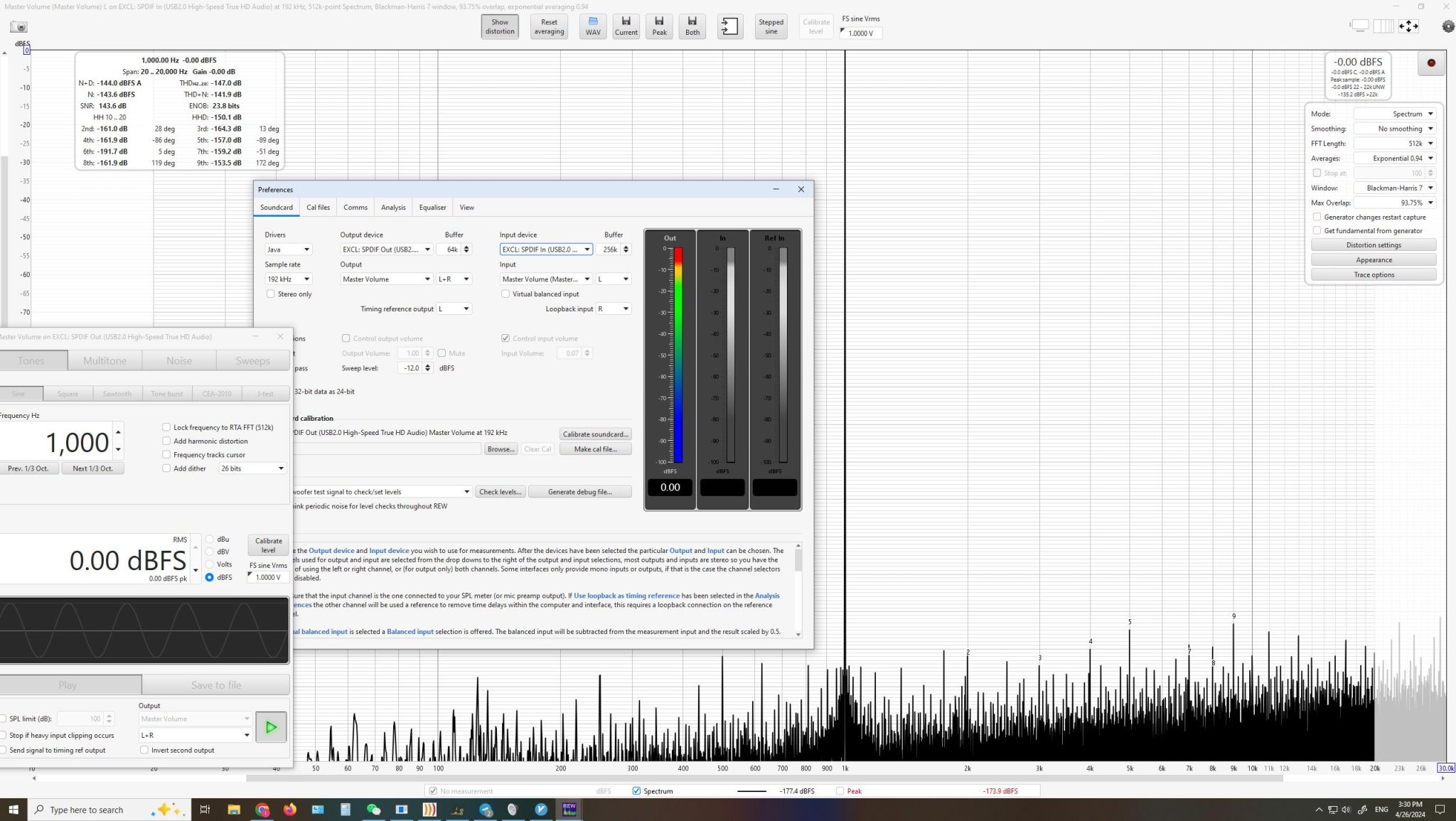

The RME ASIO driver for ADI-2 Pro etc monitors and displays CRC errors for USB... in many years of usage I've never encountered any CRC errors, using bog standard cable, USB hubs and isolators in between.
I've also done hardcore stability tests, using digital loopback in the RME and playing a sine with REW and peak hold on in the RTA, any glitch would have been captured but they don't happen -- at least not from the USB transfer as such. If the sample rate is very high and maximum overlap is used, then REW does occasionally glitch when it doesn't get enough CPU share. General system load is sure a factor, as is general USB bus load on the used bus, at some point.
