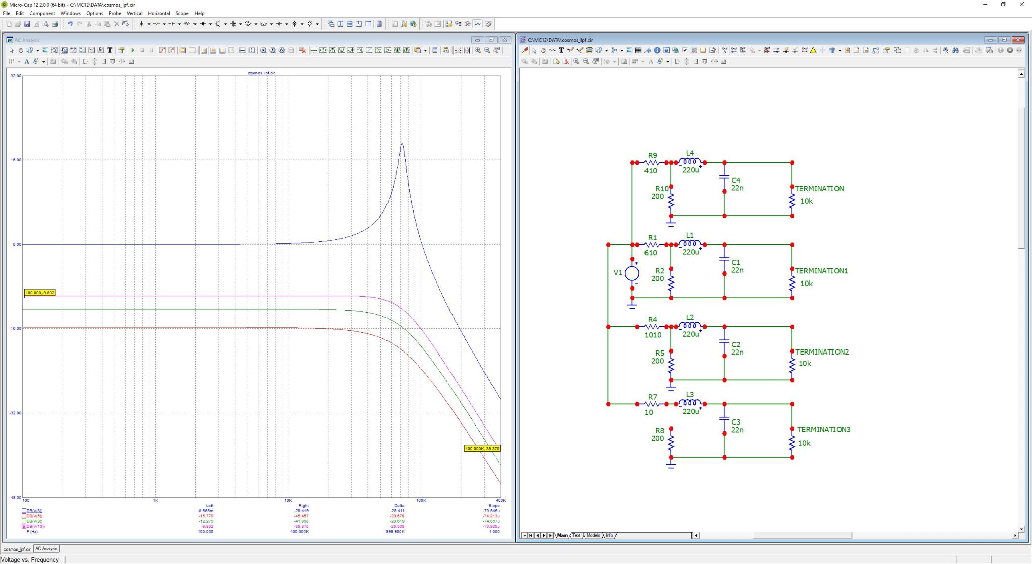

Consider to use Bridge "T" net attenuator?So, finally, I stopped on something like that:
As you can see, the only "0db" mode requires some postprocess EQ in REW FFT. However, as I mentioned above, that mode needed for the DR test i.e. BW20-20k and A-weighted, hence +.69db at 20k isn't really an issue. 18db peak at 70k perhaps may create trouble with chip DACs like CS43198/131, and better to add one more switch to alternate the termination 10k/1k, or keep 30-50ohm as a min resistor instead of 10ohm(I'm greedy regarding the noise so I'd like 10ohm). The R/r resistor divider steps could be different but I like 10 + 1000;600;400, from a total 5pcs 200ohm MELFs(2.5W together).
