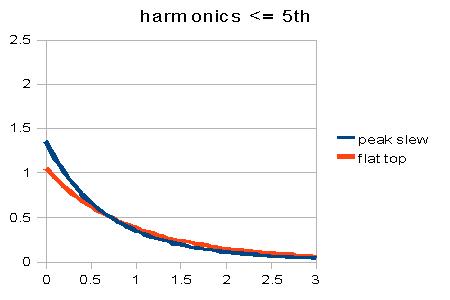

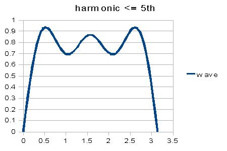

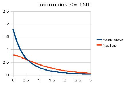

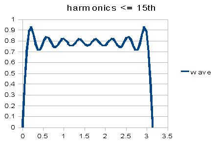

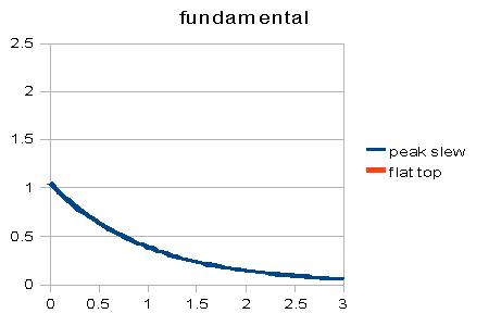

I have been thinking about how to demonstrate that the linear model of skin effect can exhibit behaviour which might appear to be non-linear when viewed in the time domain. I have come up with a spreadsheet model which shows this. The idea is to make an approximation to a square wave using a variable number of harmonics, and then show how adding up the current density gives the impression of slew rate varying the skin depth.
A square wave consists of all odd-order harmonics, with the nth harmonic having amplitude 1/n. I have used up to the 25th harmonic. Of course you get Gibbs' phenomena near the edges but I hope that will not detract from my argument. Near the zero crossing the fundamental and harmonics are all in phase, so the slew rate is fairly high. In the centre of the (somewhat wiggly) 'flat' top they alternate in phase so the slew rate is lower; actually, at the centre of the top the slew rate is zero as all the component waves are at a positive or negative peak. A slew-rate dependent model would presumably show uniform current density here?
In the linear model found in textbooks, which I believe is required by the linear nature of Maxwell's equations and Ohm's Law, the skin effect penetration depends on frequency and geometry alone so there is no variation of the skin depth during the AC cycle. To find the current density for a complex waveform you have to calculate it separately for each Fourier component, and then add up the resultant effects (taking account of phase as well as amplitude). This is what I have done. I show results for fundamental only, and for up to 5th and 15th harmonics. I also have 9th and 25th, but I don't want to bore people!
The first set of pictures show (half of) the waveform. The second set show the current density. It can be seen that around the zero crossing the current is nearer the surface. This is not because skin effect depends on slew rate, but because of the way the Fourier components add up.
Units are arbitrary. I have tried to scale/normalise the results but it is the shape of the current density curve which matters rather than the absolute values. I used a half-thickness of 3 times the skin depth at the fundamental frequency (e.g. a conductor thickness of 6 times the skin depth).
Somewhat surprisingly (at least to me) adding extra harmonics makes very little difference to the 'flat top' current density profile, although there is a hint of some flattening of the curve. However, they do make a significant difference near the zero crossing.
To sum up, I have demonstrated, in a way which satisfies me, that a purely linear frequency-dependent model of skin effect can exhibit a result which at first sight looks like a non-linear slew-rate dependent skin effect. I believe this confirms that jn and his colleague have drawn a false conclusion from the results of their time-domain modelling.
