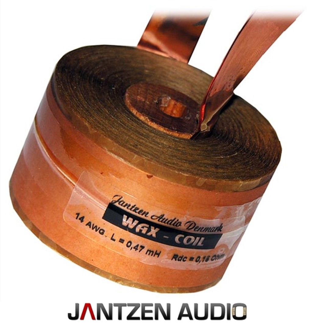

The right Litz wire can make a slight difference at audio frequencies. Agree, inductors are the worst, but sometimes they're still the right choice. Remember that when used in a frequency selective network, the signal amplitude may be greatly reduced and the inductor performance over a wide range may not matter, so long as it doesn't misbehave so badly as to cause the response shape to change.
Attached Troels Gravessen placement coils.
4 is not so bad, but I assume since both are resting on a planar surface, symmetry of orthogonality is broken. I'd avoid it also.
Jn
Potting in varnish would be better, far more monolithic. Wax would deaden vibration, but might not keep the turns from moving relative to each other.
In all cases, litz will support better parameters vs frequency, independent of potting material. It's just a pita to solder to.
Oh, and if you make or buy potted litz inductors, be very very careful of the exit wire. If you bend it too much where it exits, individual strands can break, which will increase resistance based on fraction broken. Inductance will remai the same, but it is easy to break them.
A stranded wire inductor does not suffer that fragility, but does have a L and R vs freq dependence, not to mention packing factor.
Jn
This litz wax coil keep the turns from moving relative to each other?
An article on skin effect is of little use with respect to a discussion of proximity effect when discussing multi turn inductors.read "Beldon Wire and Cable" description of skin effect and its relevance at audio frequencies.

They look solid enough. Honestly, I would not make a distinction between potting materials, especially if the wax is hard enough. I assume those use hard wax, otherwise they'd fall apart.This litz wax coil keep the turns from moving relative to each other?

Ps. There is obviously some kind of paper involved as well on those foil inductors, does anybody know what type?
Attached information Jantzen web site.
Thanks.
So the insulation is "special paper". Well, that cleared up a lot.😕
"Power distortion" is what they call what skin effect is. Ok.😀
They've no clue what proximity effect does to current distribution, they assume it remains uniform across the surface. Boy, they need an analysis package..
Oh, they use a polyurethane coat and then a polyamide bonding. Keep in mind, polyamide is nylon, polyimide is kapton. Major difference only if you want to go to 300C or 1.8 Kelvin. Room temp, no big deal.
