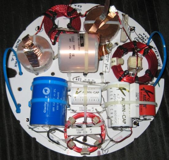

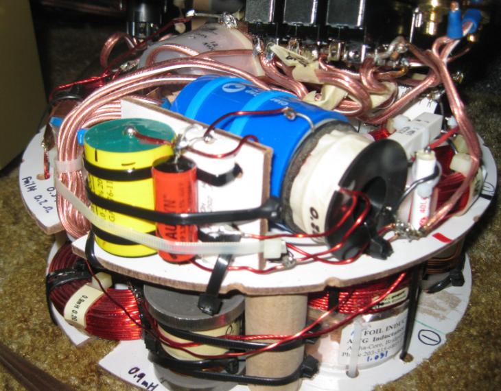

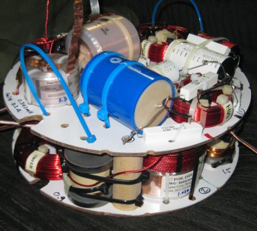

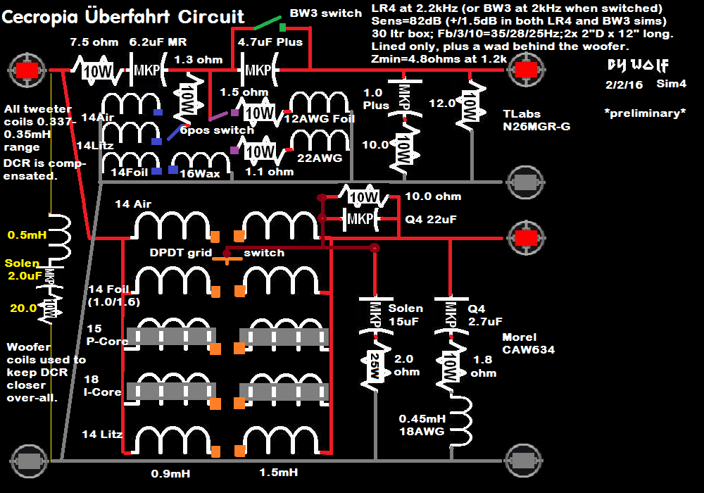

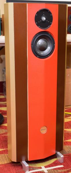

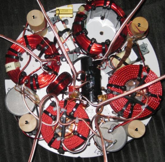

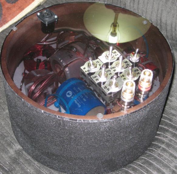

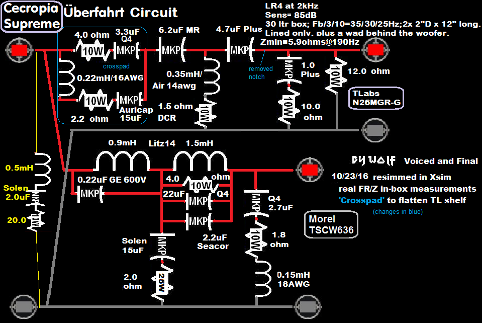

I did a subjective test on coils a little over a year ago. My Cecropia Supreme project was my test-bed. DCR was matched with a resistor in the tweeter shunt, and all were similar in the woofer sector except the P-core. I used what follows...
Tweeter:
Litz14
Foil12
Foil16
WaxFoil16
AirCore14
AirCore22
Woofer:
AirCore14
Icore18
P-Core15
Foil14
Litz14
My take on all of this is that the foils pretty much all sound similar to each other, regardless of AWG. This might change had I not matched the DCR. P-Cores sound like poop by comparison to everything else I tried; loss of detail and just plain bad. I-cores have a bit of emphasis in the midbass region, that is pleasant to many.
I even did a somewhat blind test, letting the crowd unknowlingly select what they liked best. Litz on the tweeter and Icore on the woofer came out on top. That slamming midbass helped the I-core there. The litz on the tweeter provided a bit of a BBC dip, and I'm still not sure why. The Air22 was also plagued by this abnormality, but did not sound as good.

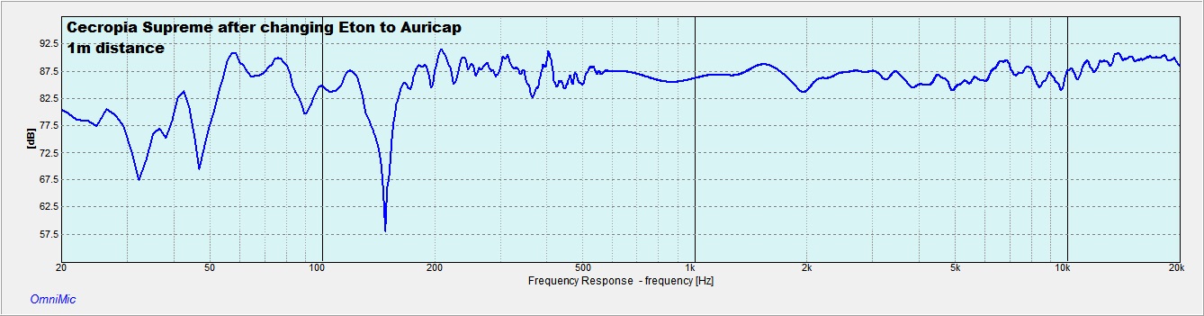

I even did some measurements, and have my listening preference being Litz14 on the woofer and Air14 on the tweeter. The warmth in bass and loss of clean mids did not agree with me like the spur of the moment crowd exercise.
FWIW, the foils did not sound as good/open and detailed as the Air or Litz coils.
So- I would not use Litz on tweeters, likely due to the inherent capacitance of the component. On the woofer, it was a more open and detailed best choice.
Be advised there were 2 versions of this journey. I used the CAW634 initially for the woofer, and the Tlabs N26MGR-G tweeter, later switching out the CAW for the TSCW636. My sentiments agree in both iterations about what I liked best. The CAW version info has been used here to show the entire circuit setup, as well as coil placement photos. It took me 6 months to lay this out and not get coil interactions, and works by switching out both coils in the driver circuit at the same time, tweeter and woofer are independent.
Later, and I hope this helps you make your decisions,
Wolf

Thanks very much for your input Wolf ...you sure crammed a lot of components in your boards there - no issues with magnetic fields overlapping?
Would I be right in thinking you didn't notice much difference between the poly/foil AWG16 and the wax/foil AWG16?

I-core is a steel-laminate rectangular slab of silicon-steel.
P-core is a sintered permite core with ferrite slabs on either end of the cylindrical coil. Jantzen makes them.
ThetaII-
No coupling that I could tell. Measurements were not affected. As I said- the foils all sounded the same to me, and lacked the resolution of the air-cores.
Later, and you're welcome!
Wolf
