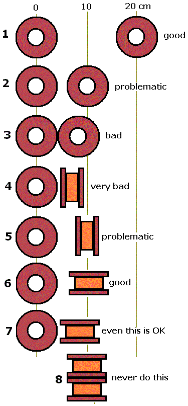

Thanks Merlin and JNeutron for taking the time to provide info. I started my little cap upgrade on the crossover pcb board at the back of the speakers about 8 months ago but somehow it kept growing till I had to make an external board. I have 4 coils on my board and 3 of them are in the same plane but I made the board big and they are at 150mm centres so I'm hoping that shoud be sufficient?
If you have an inductance meter, you can easily test coupling. Measure one, and short the others. If they couple you will see the inductance go down on the measured coil. Measure each one in their frequency use range, although it would be stronger to measure all 20 to 20k.
Attached Troels Gravessen placement coils.
