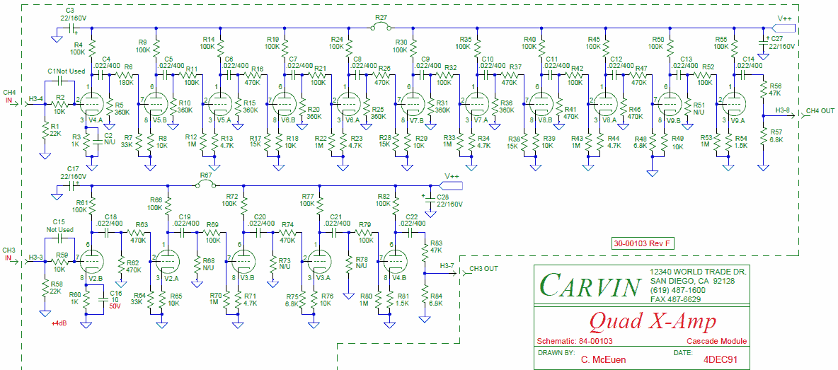

Starting in the 1980s or so, there's no such thing as too much gain for many guitarists...see attached partial Peavey 5150 schematic as an example.
Amplifiers like this are designed to make your electric guitar sound exactly like a power tool grinding on a sheetmetal roof, which is apparently what many guitarists want.
-Gnobuddy

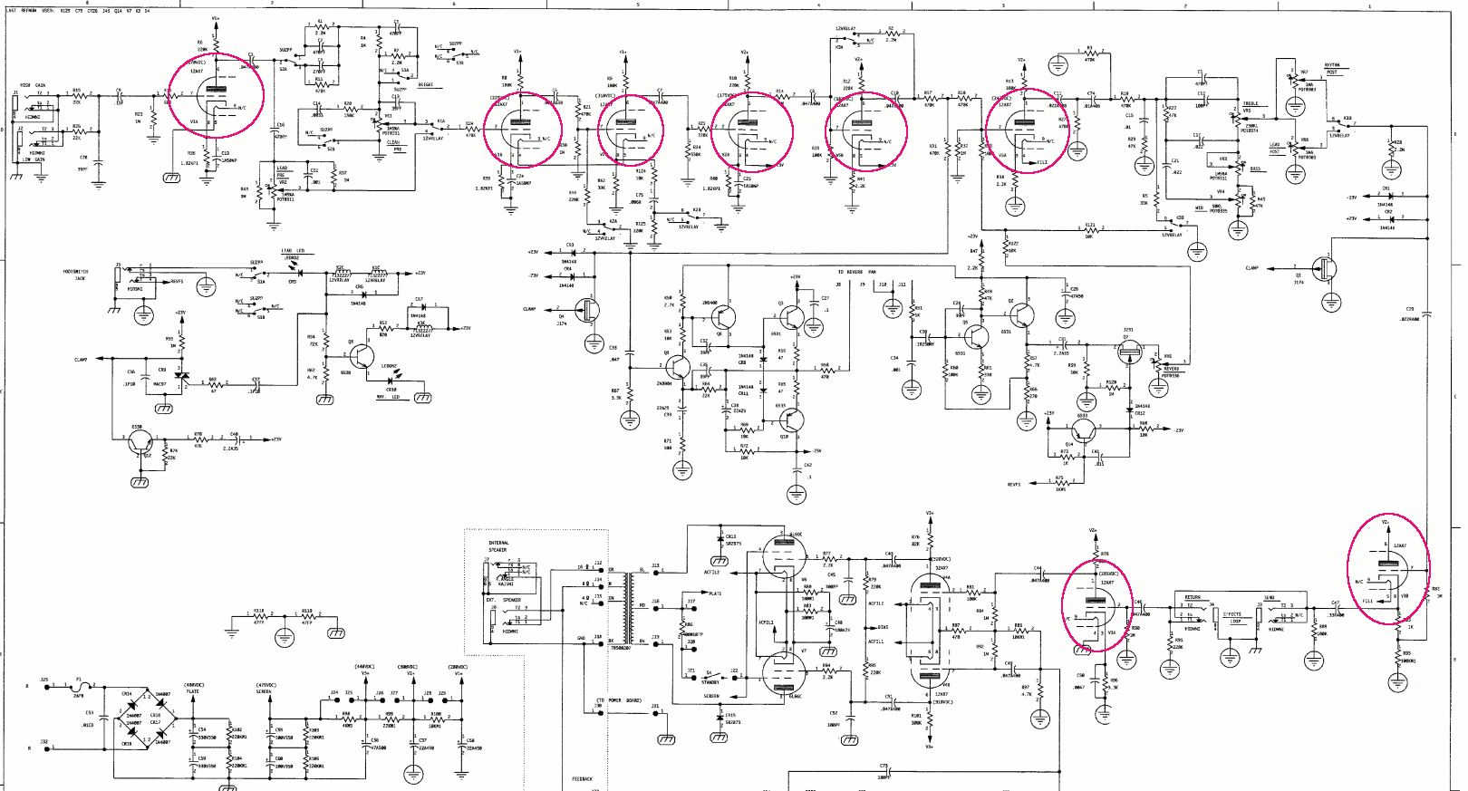

PRR
Joined 2003
Note also an attenuation network after every gain-stage. There's crazier zhit than the P-5150... IIRC there was an amp with discrete switchable 3-stage, 5-stage, and 11-stage corruption. Ah, Carvin Quad-X, almost 30 years ago.
Yes, there are insanely sensitive amps today. And while a 100 Watt wants more gain than a 10 Watt, that's only 10dB (3:1 voltage). Clearly there are players won't don't care about idle noise, because they never shut-up. And will pay for the extended development to get such a beast stable.
