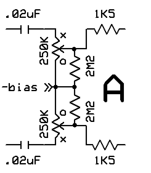

I've seen that used in many DIY schematics, and that's the only sane way to go for a PPIMV.
Are you talking about a design like this, where the pots become variable grid leak resistors for the power tubes? (I'd use a 470K or 500K pot, of course).

The PPIMV circuit I was thinking off is quite straightforward - a volume control from each phase-splitter output to the negative bias voltage, using a ganged (stereo, dual) log pot. Add a fixed resistor to ensure the output valves still have grid bias when the pots get old and scratchy. Schematic attached.
(The actual pot resistance is up to you, depending on the source impedance of the phase splitter, and the maximum allowable grid-bias resistor value for the output valves you're using.)
I'll add that the 1.5k grid stoppers in the attached schematic (which I grabbed off the 'Web and edited for you) are far too small - using much bigger grid stoppers will usually help a lot with bad overdrive tone (blocking distortion.) I've gone as high as 220k in one of my amps, which uses little 6AK6 output pentodes. Input capacitance of a pentode is usually only a few picofarads, so you can use a lot of resistance here, the limit being set, once again, by the datasheet maximum grid-to-bias resistance allowed in fixed-bias operation.
This looks like the design that goes by "Lar-Mar" in some circles. Is it? Or is there a difference that I'm missing?
I'll add that the 1.5k grid stoppers in the attached schematic (which I grabbed off the 'Web and edited for you) are far too small - using much bigger grid stoppers will usually help a lot with bad overdrive tone (blocking distortion.) ( ... ) you can use a lot of resistance here, the limit being set, once again, by the datasheet maximum grid-to-bias resistance allowed in fixed-bias operation.

Honestly, I have no idea.This looks like the design that goes by "Lar-Mar" in some circles.
Usually cathode-biased lets you get away with more resistance between grid and the bias voltage. The output valve datasheet will often list two values under "maximum grid bias resistance" or something like that.... didn't have grid stoppers at all. Since this is cathode-biased, would that limit still apply? Would it be different?
So why add grid stoppers to an amp that didn't have them? Here's the key thing: the control grid starts to draw current any time it is more positive than the cathode (and even when it is only a little bit negative.)
In a Hi-Fi valve amp, this is not a problem. The output valves are never driven beyond their linear region, so there is never any control grid current.
Electric guitar amps tend to live a much less sheltered life. Most guitarists will, sooner or later, crank up the volume and gain knobs and overdrive the output valves. Which means the output valve control grids will draw pulses of current through their coupling capacitors - but only on positive half-cycles.
In effect, the coupling cap and grid current now form a half-wave rectifier. With every pulse of current through that capacitor, it will charge up more and more - in such a direction that the average voltage on the output valve control grid gets more and more negative. This biases the output tubes colder and colder, and in extreme cases, may bias them completely off intermittently, resulting in an ugly stuttering sort of distortion that nobody wants to hear.
Adding a big grid-stopper is one way to ameliorate this problem. It doesn't stop the control grid from drawing current when overdriven, but it does reduce the amount of current drawn. This means it takes the coupling capacitor longer to charge up, so the amp is less likely to immediately move into distortion even on short guitar notes.
On positive half-cycles, the coupling cap charges up through the grid stopper resistor (+ the grid-cathode path in the valve), as well as the external grid bias resistor. But on negative half-cycles, that cap can only discharge through the external grid bias resistor. It's this asymmetry that causes the cap to charge up.
So one way to reduce the severity of the problem is to increase the grid-stopper resistor as much as possible, and reduce the grid bias resistor as much as possible.

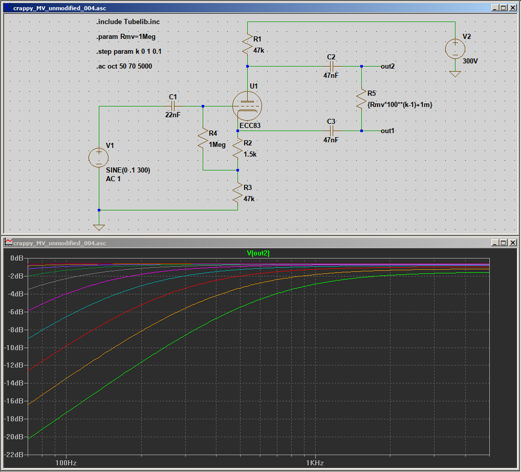

Since we've been talking about LTSpice, and it's use as a tool in separating myth from reality, I thought I would knock up a quick simulation of the Ken Fischer master volume we've been talking about.
The LTSpice simulation confirms what jjasniew spotted (image attached.) Look at the graphs. Turning down the master volume pot results in heavy attenuation of deep bass - and almost no change in signal level at higher frequencies!
A master volume should turn down the signal level evenly at all frequencies in the band of interest, not turn down the bass and leave some frequencies unaffected. Ken Fischer's design isn't actually a master volume - it's a crappy (poorly designed and electrically dangerous) bass control!

Earlier we speculated that Ken Fischer probably had limited technical understanding of audio circuits, instead relying on a good pair of ears, sadly accompanied by a large splash of superstition.
Fischer would have noticed the problem with his master volume design if he'd made a couple of frequency response measurements, so we must assume he either did not make such measurements, or didn't bother to fix the obvious problem with his circuit that these measurements would have revealed.
Having confirmed that his master volume isn't actually a master volume, I thought it would be an interesting exercise to fix the broken design.
One of the problems with Fischer's design is that he didn't understand the interaction between the output impedance of the phase splitter, the reactance of the coupling capacitor, and the resistance of his master volume pot. So he ended up with an accidental tone control circuit, one that affected the bass much more than the rest of the guitar's frequency range.
This is easily fixed. What is needed is to increase the non-reactive output impedance of the phase splitter, so that unwanted filtering effects are moved to frequencies too low to matter (i.e. below the lowest note a guitar can reach, 83 Hz in standard tuning.)
The attached image shows the effect of adding two 47k resistors, one in series with each output of the phase splitter. As you can see, the master volume pot now does what it's supposed to - it lowers the signal level equally at all frequency levels, i.e., it turns down the volume.
With the added resistors, there is now very little effect on the frequency response as the MV pot is turned - worst case, maybe a 2 dB loss at 80 Hz at the very lowest master volume settings, which is unlikely to be audible at all. (Increasing the 47nF coupling caps will remove even this tiny bass droop, but might worsen overdriven tone quality.)
