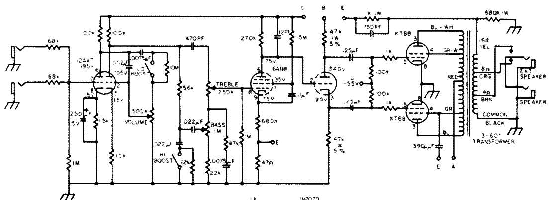

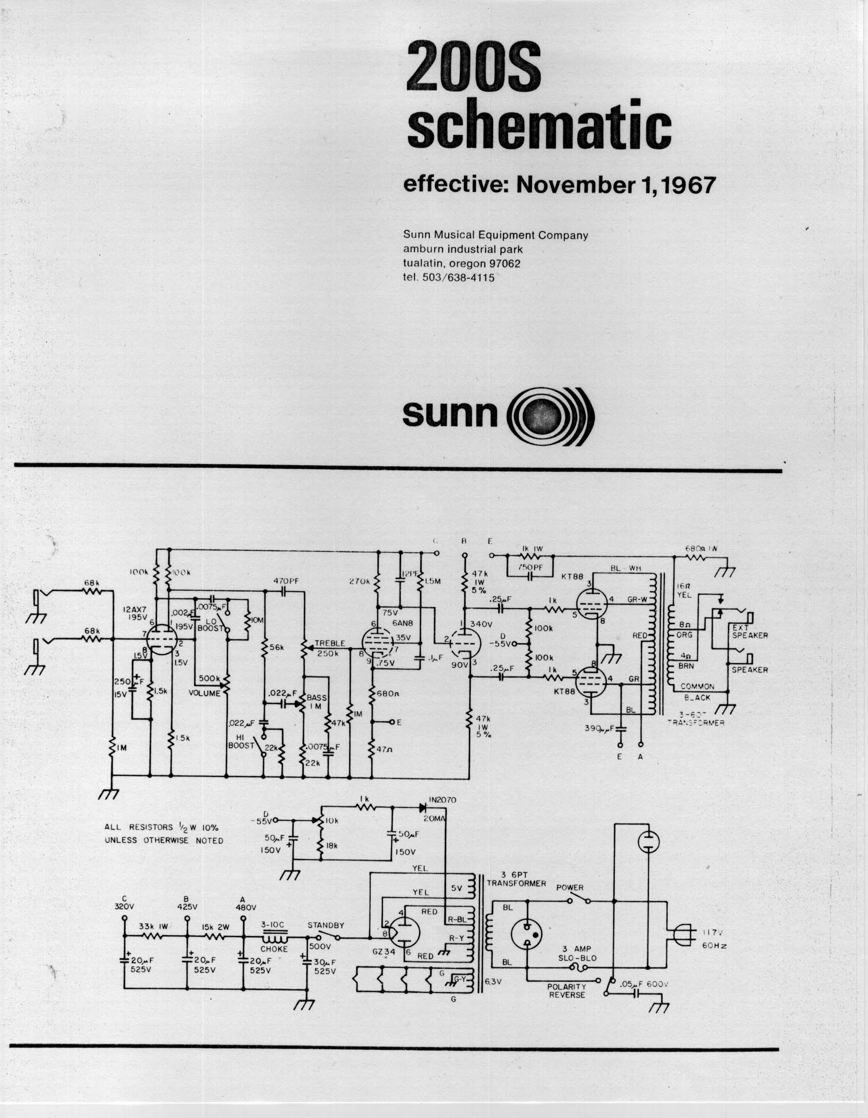

Sunn 200S (BTW: also derived from a Hi-Fi kit, but a big Dynaco) is legendary and may have lessons. The early Sunns were kick-butt large stage amps. This one has second stage biased very cold, does not bother with a buffer. Input sensitivity may be a bit hotter than 10mV of the Fender of that era; Sunn had to do something to stand out. It also has 4X the power of your home-size Heath. Paired with Sunn's hot speakers, these things filled stadiums in days before serious PA (rock PA evolved from stuff like the Sunns).

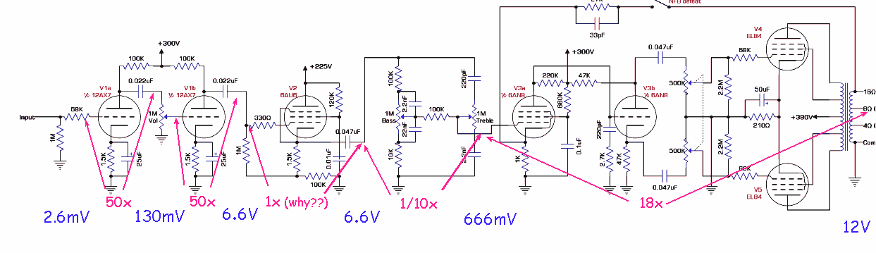

How did you come up with the gain numbers for the TS and the power amp? I'll throw a sine wave at it when I get a chance tonight and see what the actuals are.

Spent a little quality time with a sine wave and the scope this evening.
The smallest signal I can generate cleanly is 20mVpp, so I put that on the input, attached the dummy load, and cranked the volume and MV. Some interesting results. Output of V1a was a clean sine wave at 1.64Vpp.
Output of V1b was a slightly clipped sine wave ... 64Vpp I'm starting to wonder if it was really such a good idea to goose the B+ to 300V to get all that headroom!
Things get weird at the tone stack. I had replaced the James with a Fender 6G5 stack (Amplifier Tone Stacks - monster.party.hat). And that just messed everything up.
If the treble knob is anywhere above zero, the amp turns into a lovely square-wave generator. To get anything approaching a sine wave coming out of the PI, I had to turn the volume way down and zero the treble. At that point each side of the PI is cranking out 36.8Vpp, and there's 21Vpp on the output. My big honkin' 50W flat wirewound dummy load was almost too hot to touch. I really need to put that in an enclosure ...
So. Next step is to rebias V1b with an unbypassed 10k resistor to get the clipping without so much voltage gain. Probably switch to a Marshall tone stack. And I'm seriously considering the topology change I mentioned before:
- Replace the 6AU6 with a 6J6-based LTP
- Replace the 6AN8 with a 12AX7 (or 6N2P, I'm cheap), use half for the CF and half for a one-triode tremolo (More tremolo?)
