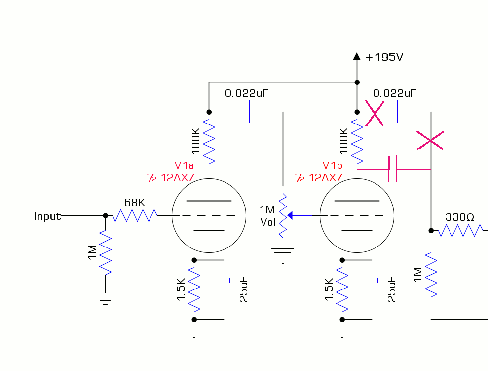

As promised, here's my planned circuit. Voltages are from the original schematic. The only change from the tone stack on is the addition of a Trainwreck Type 3 MV.
Oh, wait, I just had an epiphany - the rectifier output I mentioned above isn't filtered, it's just the raw output at the cathode. So of course it's got a ~1:1 ratio of VAC input to VDC output! Once that first filter cap is in place, unloaded DC potential should rise (close) to the peak of the AC (1.4*RMS).

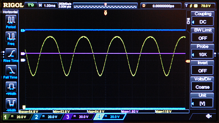

I tried this with one of my builds, with unsatisfactory results. I was hoping for single-ended clean guitar sounds, but didn't get them.
At the time I didn't have a 'scope (having just moved from Los Angeles to British Columbia to avoid the impending political disaster I anticipated), so it's always possible that I actually reduced the existing imbalance due to mis-matched valves and an imperfectly wound output transformer.
In the end, I did find a way to get what I wanted - I used a small-signal beam tetrode as the first stage in the power amp section, the stage before the cathodyne, and I added some fixed attenuation between that stage and the cathodyne. This let me drive that input stage enough to produce some of the same singing clean tone you get from bigger beam tetrodes like the 6V6.
EQ turned out to be part of the recipe, too. I got better results if I applied a gently rising treble boost in the 1 kHz - 5 kHz band to the signal before it entered the little beam tetrode stage.
I came up with those ideas using only my ears, but after I'd found work and had a stable income again, I got myself a 'scope. And I was surprised at how much nonlinear distortion I'd dialed in to get that nice-sounding "clean tone". Image attached - this was the signal to the cathodyne, with a clean sinewave input, just before any outright clipping occurred anywhere in the power amp section.

...follower...dc coupled to the previous stage will...get cathode follower compression.

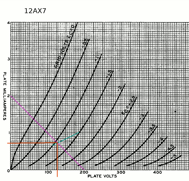

In the Bassman and its various copies, the CF compression only occurs because the half-12AX7 has a high ra (anode resistance, plate resistance), doesn't have enough DC voltage between anode and cathode, and therefore cannot supply enough current to the 100k cathode load. Since it can't deliver enough current, the output waveform gets flattened on positive peaks. This was accidental, a bug that later turned into a feature. 🙂
But if you use a valve with a lower ra, the same thing won't happen. From the datasheet, a 6AU6 will happily supply 15 mA of cathode current before running out of steam; a 12AX7 has trouble supplying 3 mA under the same conditions.
So I don't think you will get any cathode follower compression from a 6AU6 DC coupled to the previous stage, not unless you go to extremes, such as using a low-value cathode resistor, and maybe lowering B+ to the 6AU6. And if you do those things, my bet is that in pentode mode, the CF compression will be abrupt, not gradual like a half-12AX7 in the same situation.
There is a drawing error in the connection from the second half-12AX7 to the 6AU6 stage - the coupling cap should be connected to the anode, not B+ (see first attached image.)
I would also suggest a larger B+ to the 12AX7. Take a look at the second image showing the load-line and operating point. With a 195V B+ and your chosen 100k/1.5k anode/cathode resistors, a half-12AX7 is rather warm-biased, and doesn't have much headroom for guitar at either its input or its output.
A few years ago I built a preamp that contains a mix of triodes and pentodes, and I ended up running all the triodes on a higher B+, and the pentodes on a lower B+, which was the only way I could keep both types of device operating happily. 🙂

Good catch! Yuck. What an awful design. Who in the world came up with that monstrosity?
That master volume cuts the bass more and more heavily as you lower the volume. Exactly the opposite of what you want!
It also concerns me that there might be up to 300 volts inside that pot. If you must use that circuit, definitely use a plastic-shaft pot, to avoid the risk of shock. Also make sure the metal front panel is grounded - you don't want the pot to make the entire front panel live at 300 volts if things go bad internally.
I've once used a dual pot there, where the load on the phase-splitter is constant regardless of control position.
I've seen that used in many DIY schematics, and that's the only sane way to go for a PPIMV.
