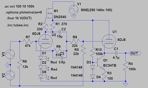

Would anything good happen for PSRR if one DC couples
the plate of U2 to the source node of M1? At the top end
of R1? Instead of powering U2 directly from B+ (with the
usual power ripples unrelated to the music signal...)
Don't think it would greatly affect constant currentness seen
by U1? But I'm not entirely free to play with tubesims right
now to confirm that theory. My lunch break is about over...

Its an unnecessary high voltage over the second triode so maybe a RC link could do.
The problem, as I see it, is that frequency response is not so good through the PF.
R, I understand... But C for what? Its OK U2's plate ripples,
as long as its in unity with the input signal(s)... I think its
called an augmented follower or something...
I realize its sort of cheating to augment the plate off only one
side of the source, but what the hey... Its better than power
supply noise... The cathode still follows the blended average.

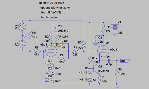

revintage said:Why not try it with 6DJ8/E88CC?
that would be nice - still i have a problem to find those DN fet's.... i thought to go with c4s as ccs but with this last schematic i think i can't do it with c4s ccs............
revintage said:The problem, as I see it, is that frequency response is not so good through the PF.
??? You lost me completely.
I knew what you ment!
With your solution and 100mV/100Hz ripple at the PSU you get ca 40uVrms at the output. With my conventional solution you get ca 35uVrms. Without anything at all, ripple is 3mVrms.
So yours win as you save two components.
This is the circuit with ripple at the PSU:

can you PLEASE (!) simulate the circuit that has the same ccs that you have used in your last schematic in the second stage, also in the first stage - so that i can use two exactly the same ccs's ... the ones i can build - DNxxxx i can't find in Delta Quadrant.... 😀
and please tell me how it will behave... is it good or better to go with the first few sch's.....
you are good with Spice...

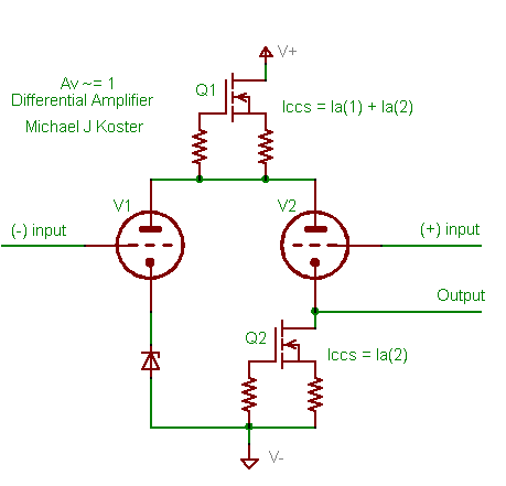

I thought eventually it would start looking like the ones in this
thread:
http://www.diyaudio.com/forums/showthread.php?postid=1546303#post1546303
But what's the problem with a diffamp again? You don't want
any gain at all?
Michael

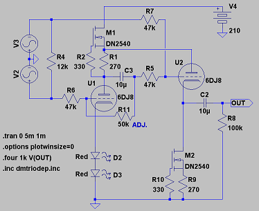

guys - here's what i will do...... those DN2540 i can use in many applications that use ccs's...... having that in my mind i will order those little guys (10 or 20 pieces) from Mouser like SY suggested and the matter is solved.....
we can use them ....
@Michael Koster - it is nothing wrong with the differential - i might still go with it.... it is looking nice - it is looking simetric, clean....
regarding the gain - for sure i do not need gain bigger than 1.... if it is less it will not be a problem but again i would not like to go lower than half of the oputput voltage i allready have at the WM8740 output..... so at the end i am looking to have at least 1V rms at the output of the dac.... not less than that..... it would make me even more happy if i could go close to 2Vrms output from the dac .....
Michael,
We already covered that one, as kenpeter already suggested it. The problem though is that it´s worthless due to severe THD!
But if you substitute the Zener with an unbypassed resistor things get a little better.
In the unrealistical event that you could have one CCS on top and one with half the current at each cathode this would be the winner😀 ! It works wonderfully in Spice but I doubt it will work IRL......
I adjusted and simplified it to work well IRL in post 43 but then you loose 6dB. Given the high output from a CD/DAC this just makes it better
