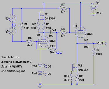

converting BAL to UNBAL using tubes and without transformers
How did you sim the DN2540 without an ".INC" command?
I'm fairly sure thats not a standard Linear Tech library part.
Where did you go to find the library with the DN2540?
How did you sim 6DJ8 (rather than NH6DJ8) without wiring
up heaters.. I see no terminals added for that purpose?
It has -6db loss because the other "half" shows up
hey kenpeter,
It´s your circuit that doesn´t work not mine, so take it easy!
You can E-mail me if you want some help with LTSpice.
Say thank you instead;) . Maybe you haven´t gotten so deep into LTSpice yet. ".four" command is fourier-analyze. You can check the figures under "View"/"Spice error log".
www.revintage.se/Draft14.asc
It´s when you bypass/or substitute with LEDs you get the severe THD!!!! Off coures I tried your schematic first and as I suspected it did not work to well. One of the reasons was that you bypassed the "unused" cathode to ground! But if you like 2%THD it´s OK.
About the added 12V you already have it for heating your 12AU7 so there are no extra parts!
And if you want a low-mu tube go for 6H30.
And for this circuit DN2540 or whatever you got at hand is good enough.

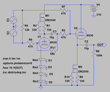

Sunrise: You are so right, it´s in the ballpark of 5mA/triode.
To keep kenpeter happy I simplified it a little more.
This time with a good lowmu tube at 10mA/triode and no negative supply.
Zout ca 800ohm, THD below 0,05%.

@kenpeter - "If low parts count is going to be a consideration here at all?"
yes - it is in consideration....but most of all what i would like is to have a tube out of that Wolfson dac. and not to loose to much voltage when doing that.... so i would like at the output of the dac to have a minimum od 1Vrms if possible.....
and quality - in my opinion WM8740 is a very nice dac that deserves to have a tube output that can match its quality....
@revintage - i like that 6H30 tube circuit better...... less complicated and with a nice tube in it too.....
so is it the one to go????
I like the 6H30 that is so neutral, some call it laid back......
C2 must be adjusted in circuit with load as it seems critical.

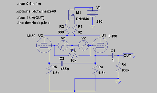

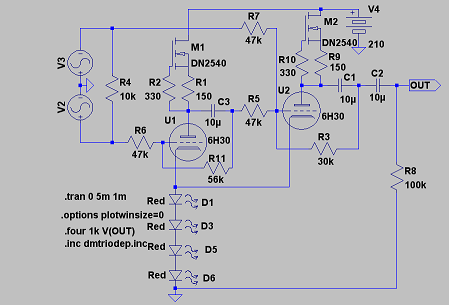

Thanks Tom,
Yet another approach. Although it got quite elaborate when you also had to take input offset and low Zout in account. Three (expensive!?) caps are need to make it work. THD will be excellent but this is due to heavy local feedback. But it looks nice!
