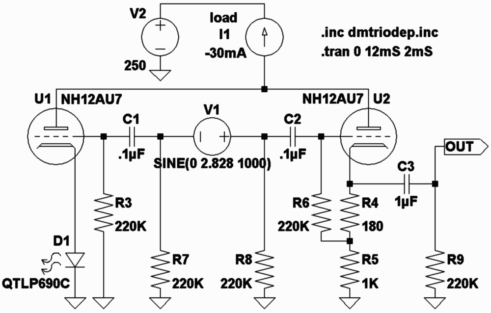

2VRMS nets you about 1VPP at the output, with real low impedance.
There's enough headroom at the input to drive that signal entirely
into either grid alone or together.... Plate swings no higher than
205V, even in the worst imbalance. Plenty of volts for the typical
CCS to function (assuming typical means 10M45S).

And I just discovered, if you bypass U1's cathode to ground
with a good cap (I simmed 47uF), the "missing half" of the
output signal then appears at U2's cathode. Netting 1.8VPP
I guess that means you could dumb down U1's cathode to
just a 180ohm and then bypass it, or perhaps some green
or blue LED alone would do about the same...

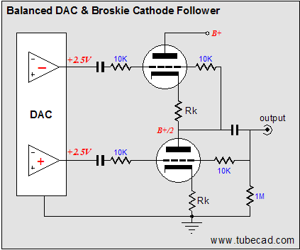

so - yesterday i was Googling a bit and found those two schematic from Mr. Broskie..... they are cathode followers and i think they just might work..... i will attach those sch in this post - hopefully this will not violate copyright because it is stated that the sch's are from Mr. Broskie......
what do you think guys related those two schematics... could they match the quality of the WM8740 dac .....?????? i really do not need gain in this stage - only conversion and a little bit of a twist to add some tube flare in the sound...... nothing more......

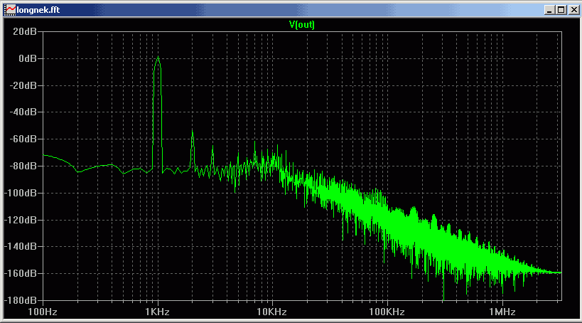

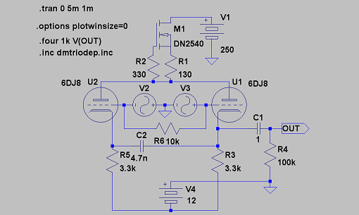

I adjusted kenpeters circuit, that suffered from severe THD, taking the DACs offset in account. I also change the tube to a better one.
Zout ca 1,5k. Well below 0,1% THD at max out from the DAC.
The filter between the cathodes had to be added to adjust a 2dB lift from 100kHz that I can not explain.

so this has been simulated according to WM8740 dac ?????
is this correct - according to the offset of the WM8740??
what is the gain of this circuit??
Gain is just below -6dB. So you get in the ballpark of 1Vrms.
Who needs 2Vrms and for what? Even poweramps usually needs only 0dBU.
Personally I prefer the semipro std -10dBU.
And yes, I checked the WM8740 spec. before I designing this.

revintage - please tell me what current of the ccs you took into a a simulation..... what is the current you intended tubes to work on??!
5-6mA per triode????
DN2540 alone maybe isn't the stiffest possible CCS,
but it'll do fine with a little power supply filtering.
I used 12AU7 rather than 6DJ8 for a reason. Because
2.828V Peak to Peak (2VRMS) would clip at the amp's
input and/or the CCS voltage limit (220V?) when the
input became unbalanced (grounded on either end).
Mu of 6DJ8 was too high, and ideal quiescent power
grid bias too close to the input signal level involved.
It has -6db loss because the other "half" shows up
below the other "unused" cathode. He hasn't yet
discovered that you can bypass that point to GND.
The missing -6db then re-appears at our intentional
output's cathode.
Havn't simmed Rev's mod yet, I'm not sure how his
driving signal works? What Spice is ".four"? I am too
new at LTSpice to know all command line tricks.
I see that getting rid of my "unacceptable" input cap
means adding an "acceptable" wholenother power
supply worth of extra parts, or perhaps a battery.
Battery lasts long for a fixed grid bias application,
its simple and quiet enough to be tempting.
Broskie's simplified circuit doesn't show the resistor
string to establish his grid biasing, nor his tricks to
get the PSRR to come out good. Broskie follower is
not as simple as drawn in that post. If low parts
count is going to be a consideration here at all?
You can't compare complexity without the supporting
components. Countless how many "simple" amps
(on paper) needed 15 different supply voltages....

revintage said:I adjusted kenpeters circuit, that suffered from severe THD, taking the DACs offset in account.
Its balanced, and DAC DC offset (from DAC GND?) isn't relevant
to this amp unless you also add a ground loop problem anyhow.
You are assuming it has a DC offset and no output caps? I am
not sure how common that is...
