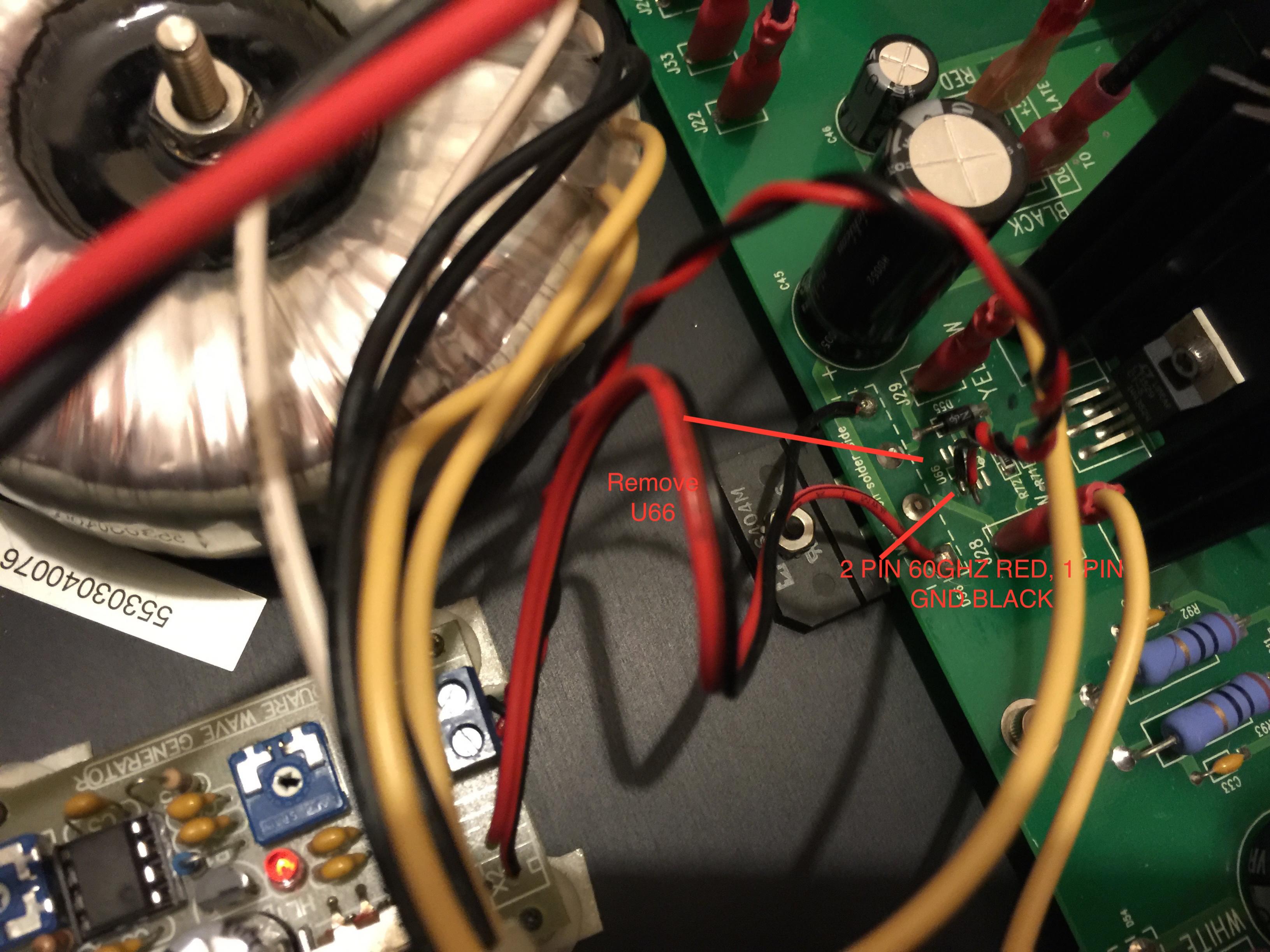

Hi, I Krell KRC-3 115V60Hz US model on how to revamp the EU 240V 50Hz. What do I have to do in order to operate. I do not want to pay too much money for chip tuning device is 20 years old. Thank you for your help
Earned run your Krell. I have the same problem and I appreciate you to comment as solucionaste.

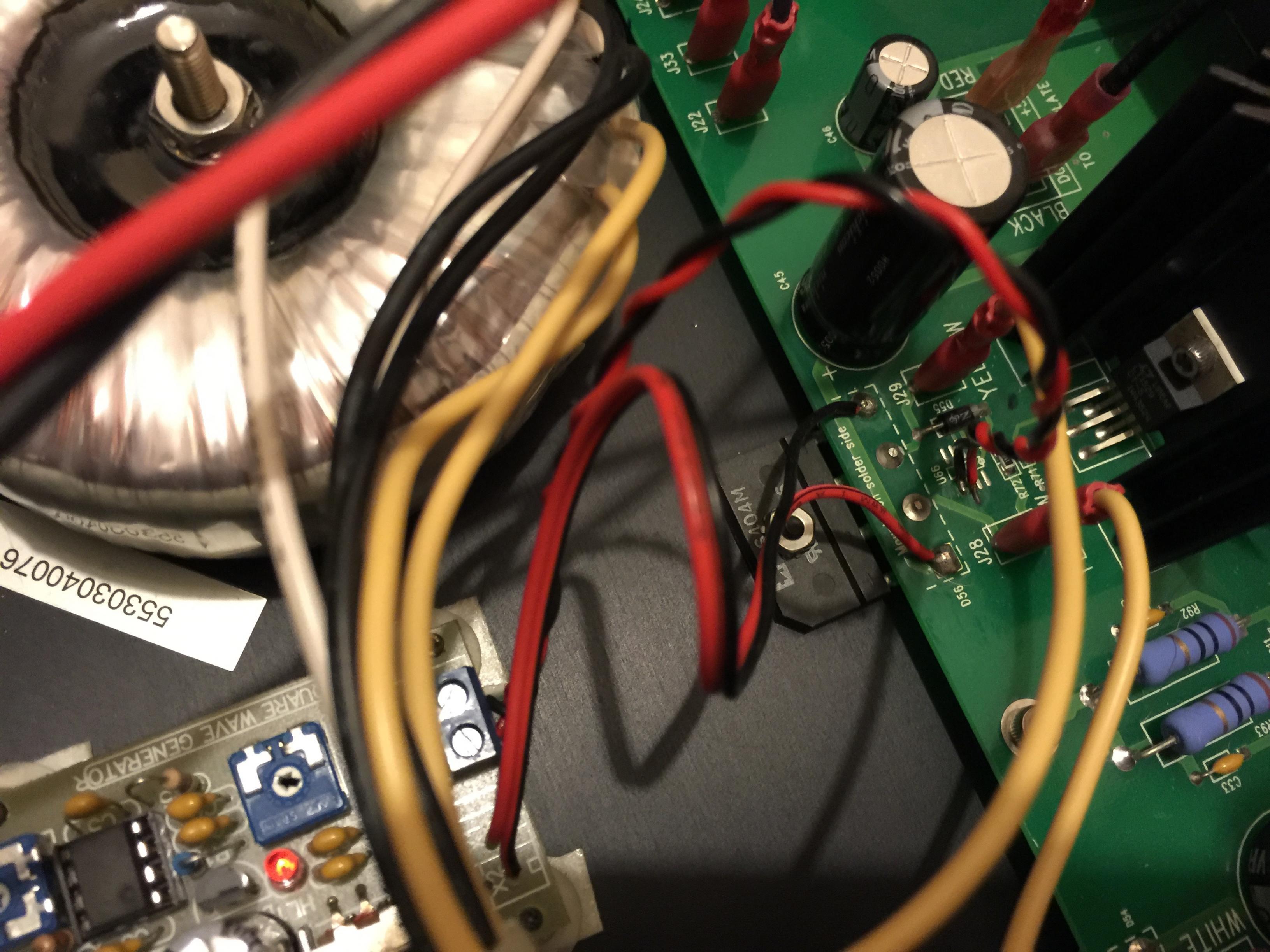

Anyone found the way to get Krell Showcase Processor working on 230/50HZ ? I have used a transformer to 110V but when power on, the unit said AC Line error. So it should be the frequency lock, right ?
Any help would be appreciated.
No, it was not mine, but I made it for a friend and it works !

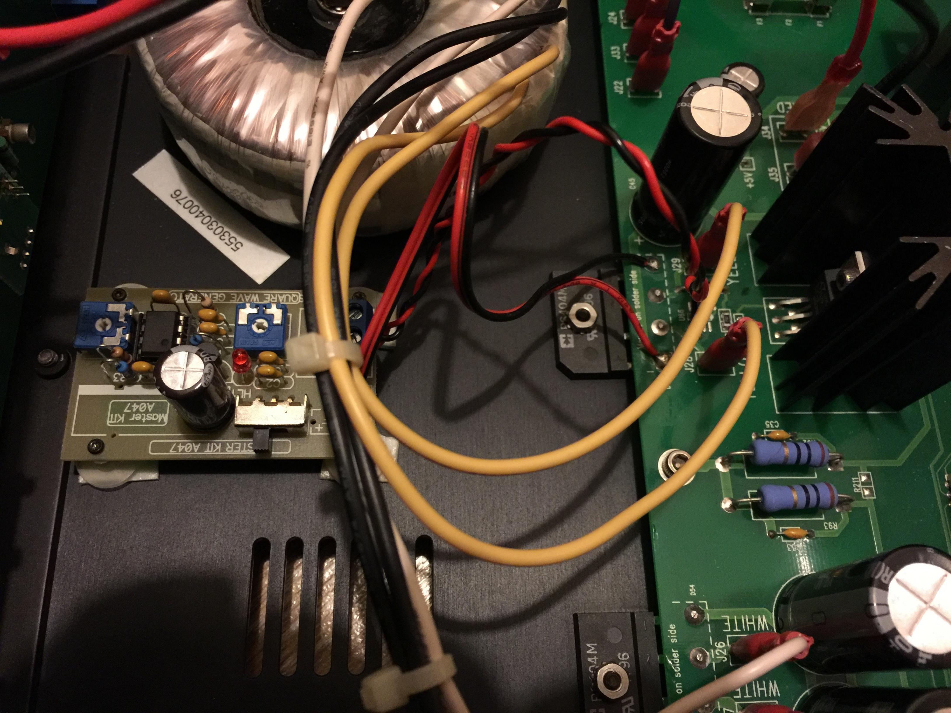

The Master kit A047 (square wave generator) where you can buy? a website?.
the kit is to recognize the 60HZ. but that changes must be made in the power supply to 240V?
It is supposed to come prepared to 110V
many thanks for your time.
It appears Krell are using a frequency detector to prevent users bypassing the profit margin of the local importer.
You need to change the voltage and change the frequency detector.

I've done burning my chip, all works now after couple of months research.
