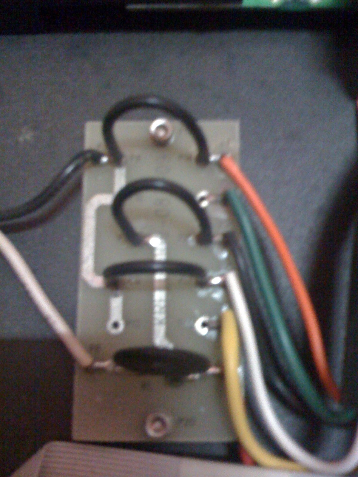

Left side is mains 220V or 110V, right side is the 2 sections of 110V which are now parallel,
black /orange is 1 part of the 110V section the other part is the red / white wire, in serie is : remove the lower smal black wire , the middle smal blackwire disconnect from the left side and connect the white wire with the the rightside black wire, now the to 110V sections are in serie
