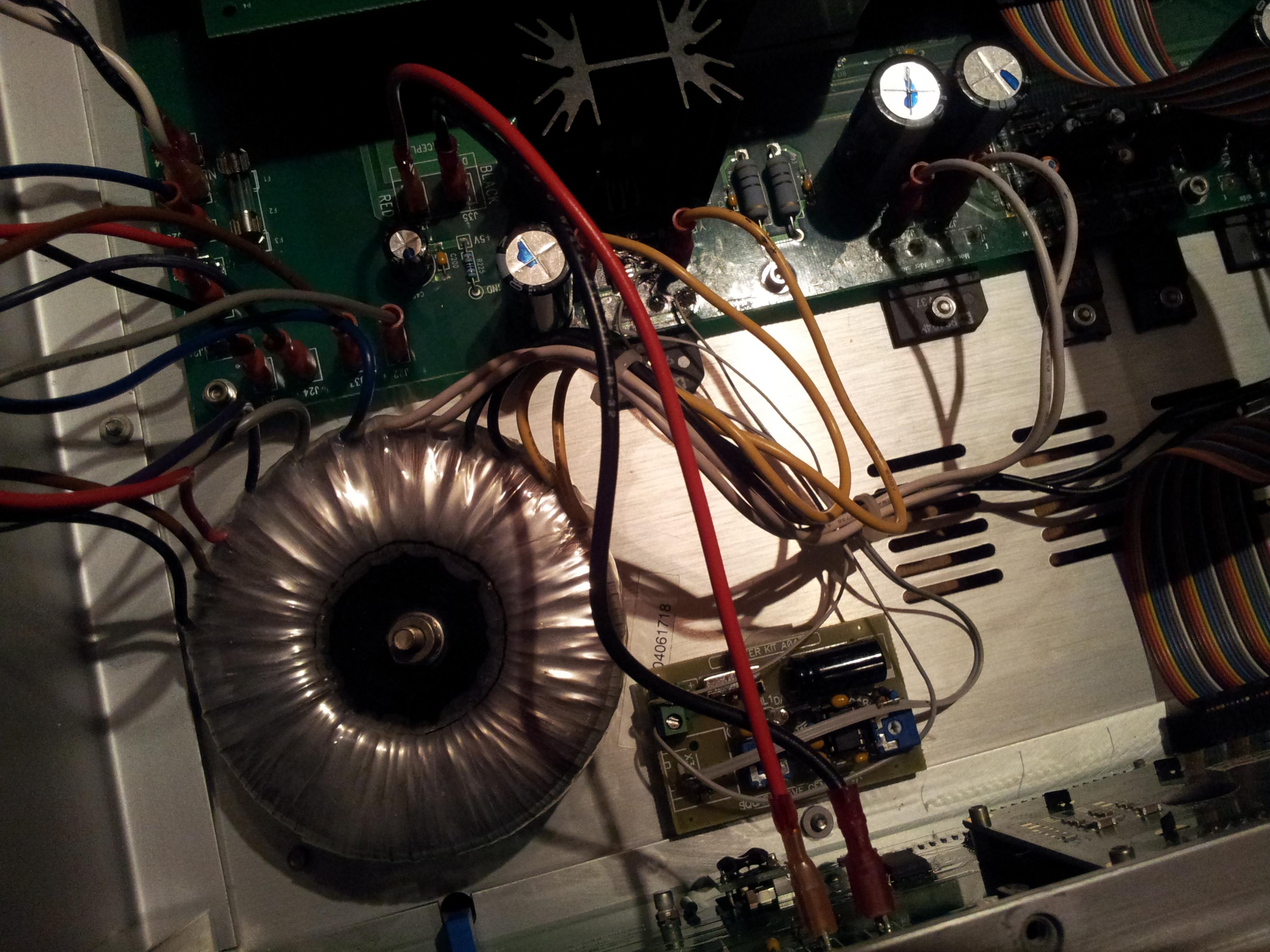

hello, I want to convert my krell hts 7.1 U.S. 120V/60Hz to do work in Europe 240V/50Hz.
toroidal transformer is:
part: TC0075-0013
cust: hts2
input: 2x0-100-120 volts
Fuse F1: 250v no amperage, dark gray
processor U1: motorola
MC68HC16Z1VFC16
OH35S
QQHDO126
U3: M114636
U4: M2146136
SWITCH:
SW1: 2
SW2: 1
SW3: 2
the back of the unit, next to the IEC power there 50/60hz
I read the whole post and I think I have to put the switch to 2-2-2 for 240V.
I have to do something else?
how we recognize a processor that works in 60hz to another who works in 50/60hz?
thank you for your help

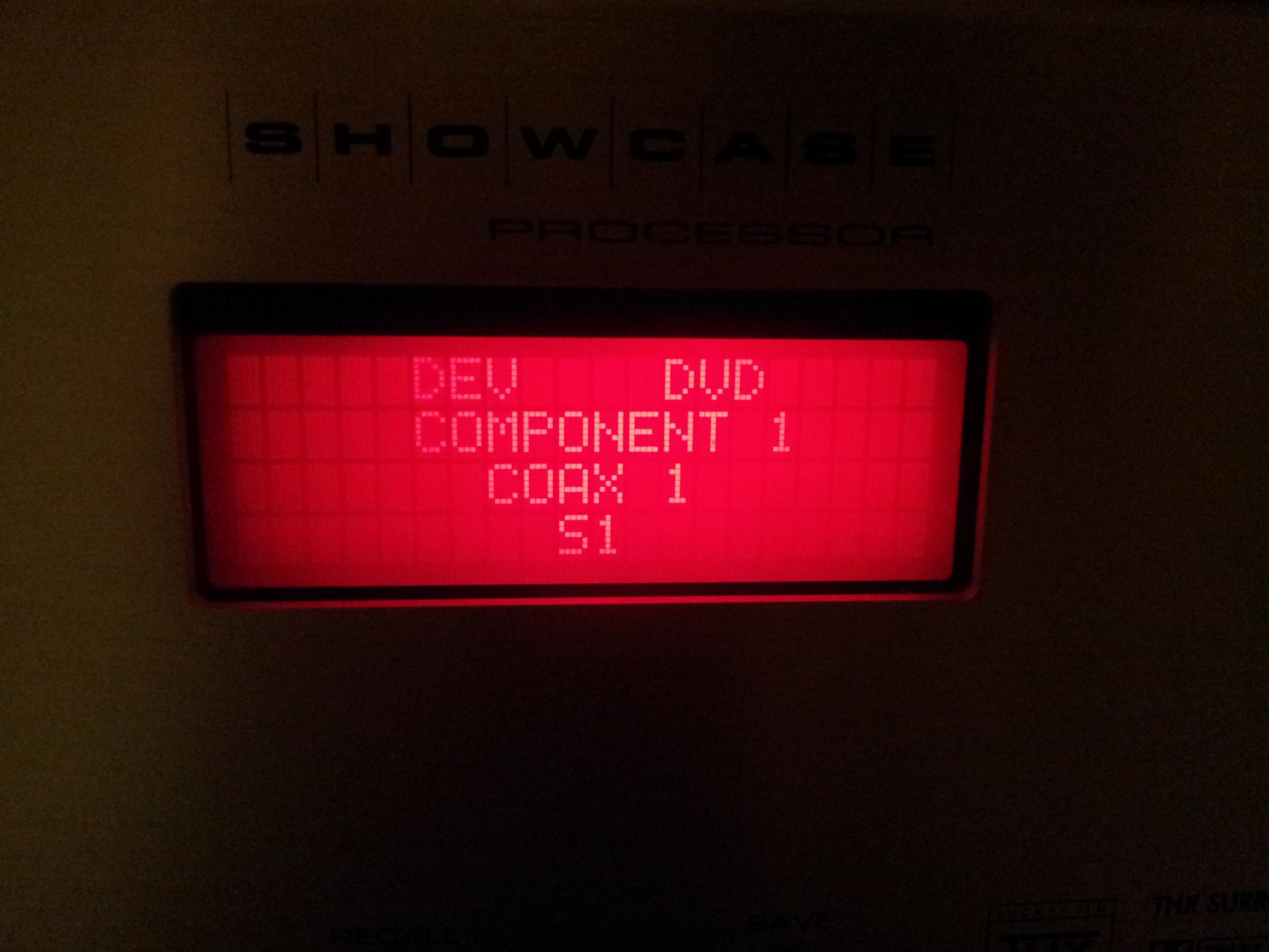

I have a problem.Could you help me?I have a KRELL 7.1 showcase processor,I bought from US,but I live in UK,so I can 't use,because the frequency 50Hz in UK,voltage 230V.
do you offer me any modify in Krell? upgrade kit,or build 60Hz clock signal generator?
Regards,sonyvaio2006

I can solve the problem of 60 Hz , krell good works 220v 50 hz, see photo.Hi can you help me to convert a 110 us to 220 european 50 hs ?

It might not be a voltage conversion that is the bigger obstacle.
Frequency may be your problem.
Feed 230Vac from a small (500 to 200VA) autoformer and see if the unit switches on.
If the correct feed voltage fails, then it's because they have soft/hardware detecting frequency and preventing power ON.
