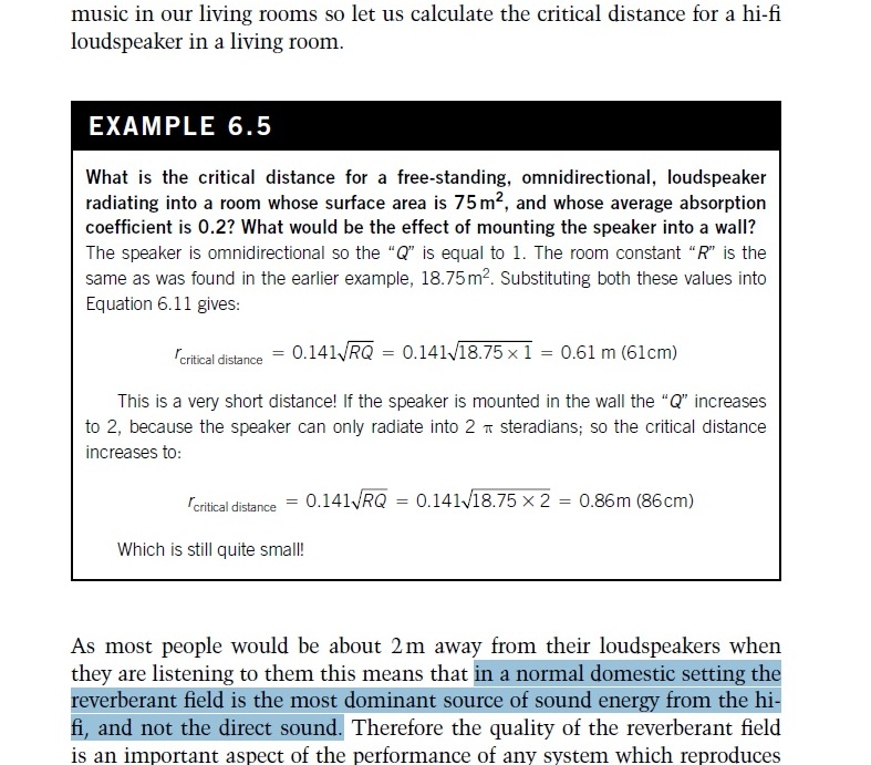

you need to have a minimum required ratio of reflected to direct sound. So the listening distance is imperative with omnis (and wide dispersion speakers). More than approx. twice the critical distance is no good.
I am not sure but I think that we can safely rely on a source like "Acoustics and Psychoacoustics" by Howard and Angus, 4th ed., Focal Press 2009, Chapter 6: "Hearing Music in Different Environments", relevant fragment is posted below
0.2 is a typical average absorption coefficient of a listening room (again according to Howard and Angus)

Yes ! According to Klippel [1], [2] there is an optimum. The optimum he describes for music is where the sound reflected in the room is 5dB higher than the direct sound. And how do you know where to sit then ?
a. You can hear it (at least with a constant directivity speaker) ! If you are too far out in the room, it does not sound good anymore. Try it yourself. I bet you will find the spot where the room starts to dominate too much.
b. 5dB more than the direct sound means "a bit less than twice the critical distance" (twice the critical distance equals 6dB).

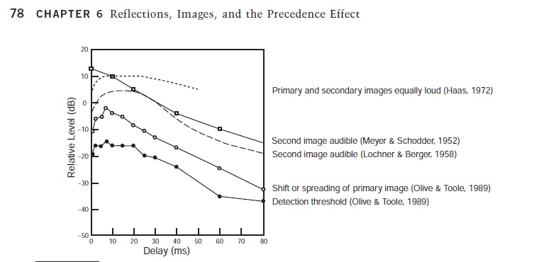

What was again the angle of the second image corresponding these levels ?
For some reason 1952 and 1958 results differ considerably especially below 20 ms ?
good question, I can't check it out now, I don't have Toole's book at hand
Meyer/Schodder's critera was "echo barely below audibility" wheras Lochner/Burger's criteria was "echo clearly audible". Both experiments are based on speech with a stereo base angle of 80°.
Blauert explains that test subjects in the Meyer/Schodder test probably confused echo with image shift. That's why the curve differs at smaller delays.
By the way, the labeling in Toole's book is reversed.
Blauert explains that test subjects in the Meyer/Schodder test confused echo with image shift.
in that case are You sure it wasn't quite the other way round?
because I find a requirement for a reflection to be 10 dB louder than the direct sound for an "image shift" to be experienced quite surprising, and that with speech! 😕
it looks very much like what You describe must be caused by something else than crossing beyond the critical distance in sensu stricto
Omni speakers are fairly untypical in the overall market. I'd guess the most typical midrange d.i. is 5 or 6 dB, rising to 10 at high frequencies, so the critical distance is a liitle farther out than quoted.
Whats really wrong with this quote is that they state that the reverberent field is stronger (likely true) and that it therefore dominates perception (not true!).
