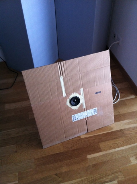

I did some tests with a tweeter to create a very high directivity, and it worked fine.
Baseballbat
Wierd. All of my tests on high directivity tweeters have lead to failure in terms of imaging. The tweeters become perceivable as sound sources, and symptoms of the interaural cross talk become unbearable too.
