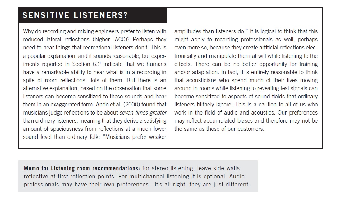

The "untrained" listener is usually (?) someone who does not listen intensely and concentrated to the music, and does not focus itself on stereo image, detail or anything.
for the purposes of the test such a listener is asked to focus on some aspects and to make comparisons
again I am with Linkwitz:
Unbiased listeners have no difficulty recognizing accurate sound reproduction, even with hearing damage or with hearing aids
This quote from Tom Danley is yet another example that omnis are widely misunderstood or not understood.
because simply not known, even by experts, and usually dismissed on basis of some theories and a very limited listening experience - casual or even worse - on an audio show, without any serious investigation, not to mention any attempts at optimization
The culprit is not the omni speakers themselves. It's the "trained" listener. As said by another person in this thread, the training we get in listening to loudspeakers is not that of true fidelity as that would require that we know what type of microphones and what the entire recording set-up is on every single recording we listen. It is instead an acquired personal bias toward one specific type of sounding speakers and a specific way to listen.
it is not just another person in the thread, the "professional bias" is Dr Floyd Toole's hypothesis:
I think that sums it up perfectly. Thanks for that.

Elias is 100% right, it is all perhaps about getting a low IACC in the first place, Dr Toole writes a lot about it in his book
You are very much welcome 🙂

I totally agree with you. Critical listening is a skill, as much as playing an instrument is a skill. There's a big difference between someone that has learned three chords and can struggle through a song, to someone that can play a whole set of covers in a bar, to someone like Jeff Beck who leaves other guitarists scratching their heads in wonder.Not sure if the wink means you are not serious, but I have to respectfully disagree with you here. The general level of the best DIY has reached an amazing point, but for every great project, there are tons of others out there that are really bad. Being an educated, trained listener takes years or critical listening AND learning from others to point out how and what to listen to.
But I included "testing" to weed out those who simply throw a few speakers in a box and stand back with pride. I do think most here are far beyond the "untrained listener" that Baseballbat mentions.
Of course, with all the computer programs and new test gear at our disposal now, there's still a chance people aren't listening. A group of friends built a studio in the '70s, real top tier stuff - 24 track 3M, Harrison board, UREI monitors... and one of them was totally frustrated that a guitar player we knew kept saying my recordings of him in the '60s, done with just a pair of 664s and a Sony tape deck, sounded better. Thing is, with only one knob, I spent hours on mic placement, listening, moving, listening, moving... and my engineer friend thought he could plop a Neumann in the room and make it sound good from the control room. (Natch, the fact that in the '60s he was playing a Les Paul with PAFs through a Tweed didn't hurt....
But I'm willing to give people the benefit of the doubt and assume that are listening more than they're reading graphs, and that they haven't damaged their ears too badly with all those power tools.
