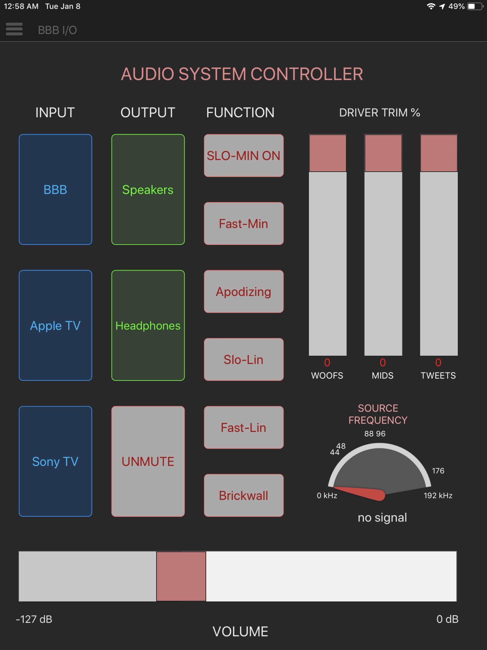

I'm definitely making progress here but must quit for now. However, the touchscreen slider interface that i'm using for volume control is difficult to 'hack' without the 'NetIO' interface from my iOS devices. One question is whether you would like to have such a mobile interface for your system? If not, then a 'louder' and 'softer' routine can be written and accessed using netcat. The touchscreen sliders, though, are nice! 🙂 If you are curious, below is a shot of my iPad controller screen that runs using NetIO. So if you wanted such a controller, I can leave the NetIO code intact. Again, all of the switching and routing and I2C is managed by the python program, which can execute system commands and kill processes as needed from within the script.
Information on NetIO is HERE. Documentation is not great but I have solved most of the issues by trial-and-error.
OK twluke - I hope your objectives will be met by the updated python program named DACserver.py that I placed on the GitHub page we have been using.
This program initializes your 9028/9038 DAC according to the register settings we have discussed. Then it continues to run and allows you to change certain registers. The code is most certainly NOT optimized because it is derived from a much more complicated program. For example, there are definitions with only one line. Also, the asyncore server and client are more complex than necessary. But importantly, they work on my system. I can't run sound with your settings, but I've confirmed all of the register manipulations. These manipulations are defined in the section: 'def handle_command'. The syntax of these brief commands is simple and you will have no trouble adding or deleting to suit your needs. To access these commands you need only open a second ssh socket and then use netcat to send text to the program. Example:
in the above example, 10.0.1.5 is the IP of my BBB, and 8193 is the port I selected from the range 8192-8195. Best if each TCP source uses a different port. After running the echo command, the volume register should be at 0x6e:
Here are the commands to which DACserver.py will respond:
'set volume XXX' - where XXX is from 0-127 (0 is very quiet but not mute; 127 is no attenuation)
'+' - increases volume by 10dB
'-' - decreases volume by 10dB
'freq' - reports the frequency of PCM
'apodize' - sets register 7 to apodizing, fast roll-off, linear phase filter with IIR @ 50K (0x82)
'slow-min' - sets register 7 to slow roll-off, minimum phase filter (0x62)
'fast-min' - sets register 7 to fast roll-off, minimum phase filter (0x42)
'slow-linear' - sets register 7 to slow roll-off, linear phase filter (0x22)
'fast-linear' - sets register 7 to fast roll-off, linear phase filter (0x02)
'brick' - sets register 7 to brick wall filter (0xe2)
Again, all register 7 settings use the 50k IIR setting. Of course one could modify IIR independently using an additional variable to remember the desired FIR filter.
You will see that there is a 'def police()' line followed by various commands. This is something that you may not need, but I suggest that you use it at least at first. This routine checks that the DAC is in stereo mode, and if for any reason it has been knocked out of stereo mode it will restore ALL of the initialization register settings. This is done every 0.3 seconds. For systems that use balanced amps, this can help prevent accidents. There may be a better register to monitor than number 15, and that can be easily changed. For my system, I monitor register 15. The 'police()' function also can catch any disruption in I2C serial communication. That is usually not the worst thing in the world, but requires a cold re-boot. However, I automatically kill whatever source program is running on the BBB, so that when the DAC comes back online after re-boot it doesn't get any input until all registers are ready. Those lines are commented-out, but are there for your modification if you wish.
Finally, even for non-programmers like myself, Python is easy enough to work in so that the BBB's GPIO and command-line functions can be manipulated, and 'handle commands' can be customized for different uses. I gave you an (inactive) example of how you can select the output of a player - I used Squeezelite - in order to secondarily manipulate the PCM in ALSA. ALSA LADSPA filters can create a crossover, an EQ, etc. by placement in unique pathways between the rendering program and the output pins. So I have made specialized ALSA pathways using custom plugs for each mode of system operation, and can switch among them using simple commands like 'os.system(command-line function)'. [hint: sometimes os.system commands are a bit slow and need to be followed by a brief sleep command.]
I hope it will be easy for you to refine and customize the 'handle commands'. Any questions or comments, please let me know! And if you decide to use NetIO with a mobile device as a controller (Android or iOS), I can help you there too... Another possibility might be something like an SSH tunnel from your mac, but I have no experience with that. Perhaps keyboard macros incorporating SSH to the BBB could simplify things.
Frank

Yes, you are certainly on the right track!
Suggestions:
1. delete the new 'global ...' lines. Those specify variables and you are not using any new variables.
2. I suggest that the first option in the 'handle_command' use 'if' (as you have it) but that the others use 'elif'. I see that my GitHub code wasn't that way but now I changed it.
3. I suggest that the logic statements be changed from 'line.startswith' to 'line =='. Only the 'set volume' option needs 'startswith'.
4. By all means transfer the code to your GitHub page!
As you gain comfort with the modifications, please begin thinking about what will be your favorite way to control the DAC. For example, try the 'echo' commands FROM YOUR MAC!
They work, right? Do you ever use the OS X 'Automator' program? You can program your Mac keyboard to execute a shell script. So, you could change volume on the DAC simply by pressing certain keys on the Mac. That's just one possible way of creating a TCP connection to the BBB...
Best,
Frank
Clarification: Try the 'echo' commands from your Mac's terminal application, without logging into the BBB...
Any TCP connection via ports 8192-8195 can control the DAC merely by sending text strings (the 'line' variable) to trigger an action. You simply match what you send to the string in the 'elif' lines. This begins the following indented code lines with whatever you want the BBB and the DAC to do. It can be a single I2C write, or it can be many lines of configuration changes for anything the BBB can control: player programs, GPIO, ALSA, etc.
