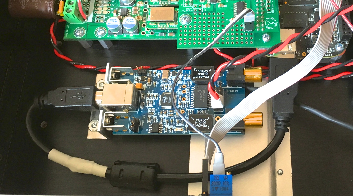

Here is a brief report on control of Toslink/USB inputs in my BBB-based system. Used for video sources, this is the last of my personal objectives for this system. I think it opens doors to expand the role of BBB/Hermes/Cronus into more general applications than those based on MPD or Squeezelite.
Hardware: I found an inexpensive ($35) and capable two-way converter to produce USB from either I2S or SPDIF. The 'miniStreamer' is based on the TE7022L USB streaming controller, and integrates well with Twisted Pear Toslink modules and an Otto-II. The max sample rate is 96kHz for both the Toslink->SPDIF converters and the miniStreamer. Together with an Otto-II they are working very well with Botic and the BBB/Hermes/Cronus setup to provide low latency crossover filtering for audio originating in my 'smart TV' or AppleTV.
Configuration: The miniStreamer board can apparently accept either consumer-level or TTL-level SPDIF signal. I configured my Toslink modules for TTL-level output. Power to the miniStreamer can come from the USB port or external supply, I chose external at 5.25 volts. This requires that the board's power jumper be left open. Also, the board should be used in 'master' configuration - another jumper setting. The firmware sets I2S as the default interface and this must be changed each time the miniStreamer is powered-up. [Thanks to @GDO for the tip!] Simply execute:

The Otto-II is off (OE=HIGH) unless one of the 'TV' inputs is selected - this is simple GPIO control through GPIO pin 8_9 for OE, and pin 8_7 for S. I'm still tinkering with the NetIO control code and will update the GitHub sources when I've ironed out a few little details.

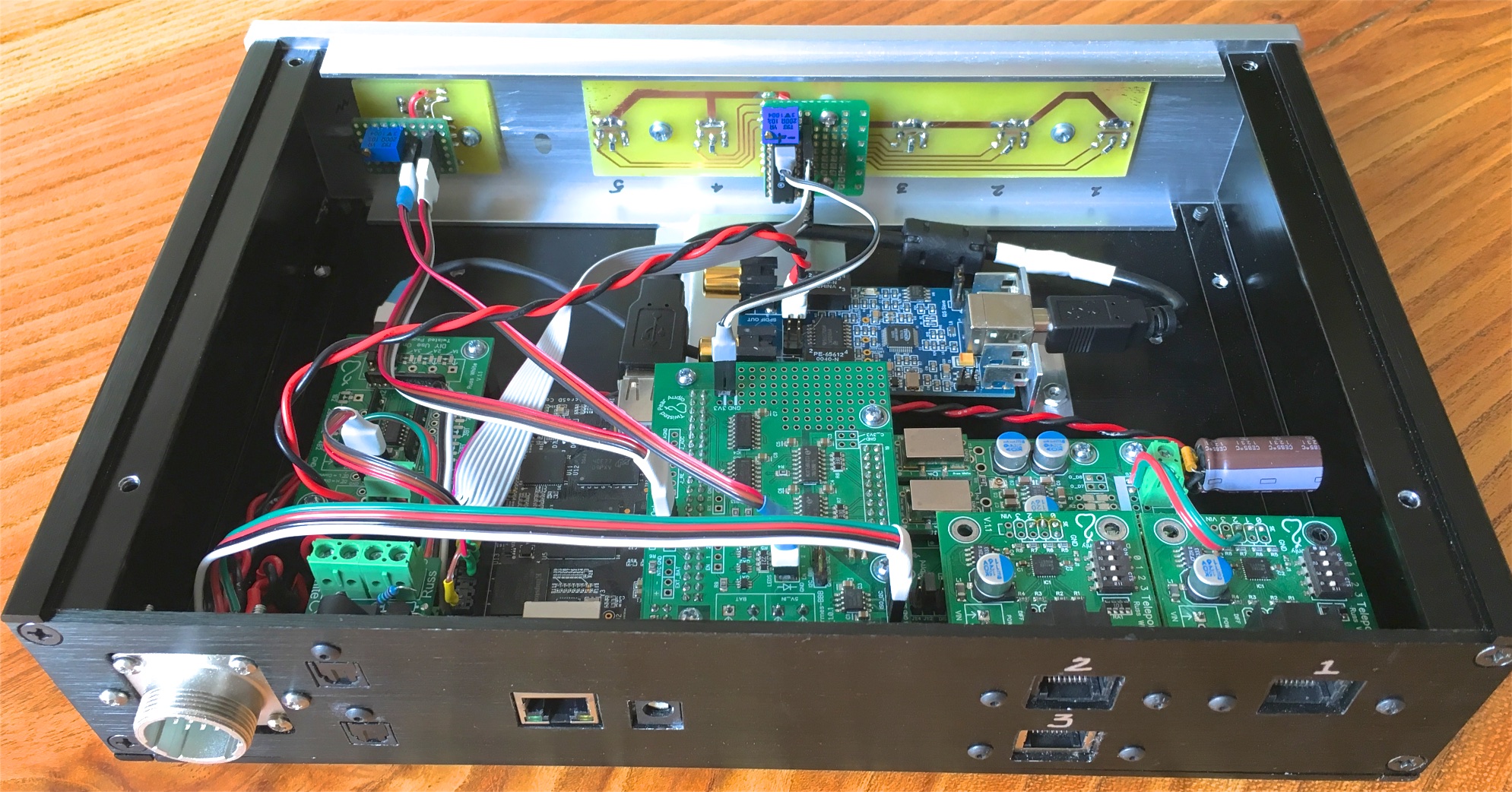

Layout: I attached photos showing the miniStreamer in place. It sits partially above an aluminum plate covering the LiPO battery. I spliced the USB cable rather than hassle with buying a short one. To keep connections short, the Otto-II is positioned close to the GPIO header of the BBB and the Teleporters sandwich the output end of Cronus (direct soldered with silver wire). With the boards so tight, the airspace gets cluttered with wires! The decoupling caps on the power input to Cronus helped during testing (when Cronus I2S output connections were not ideal) so I left them. That power travels ~4 feet to reach the big multi-plug on the back panel.

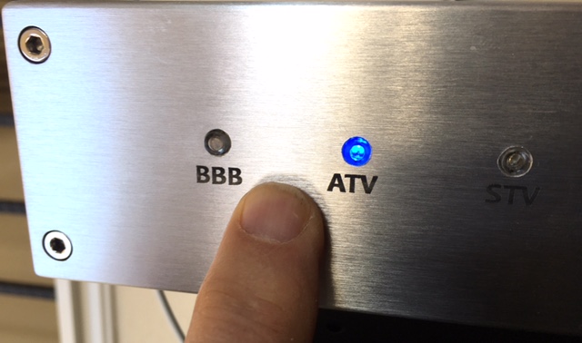

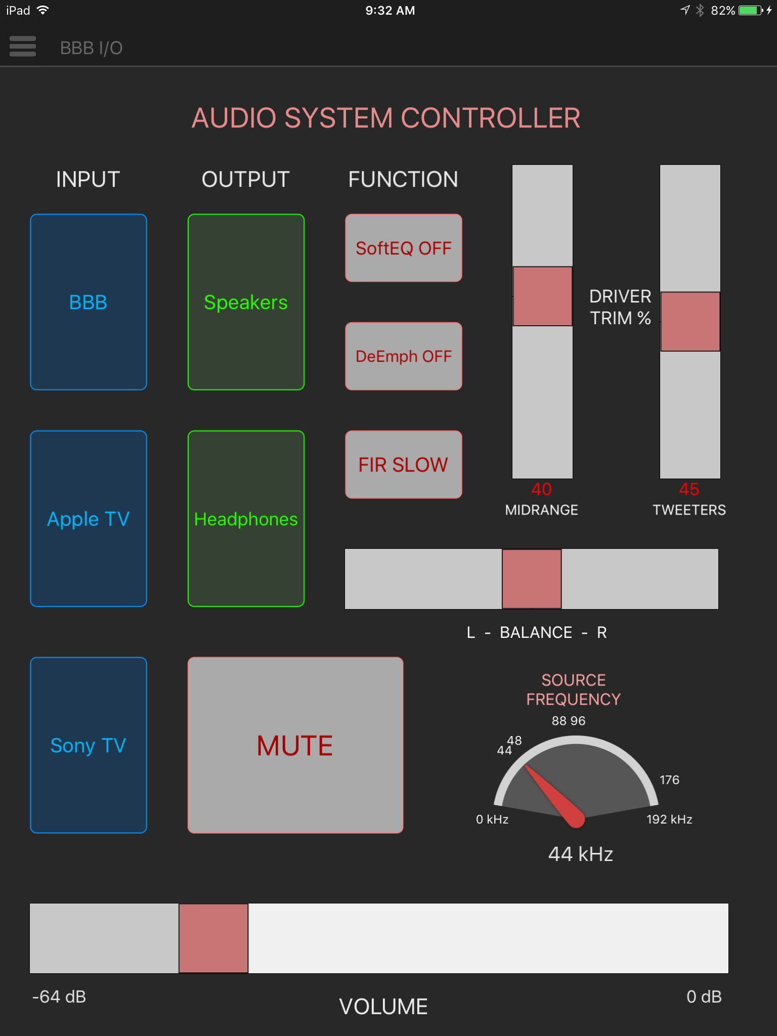

I added buttons for these functions to the remote. On devices with smaller screens, I'll have to add a second page to hold these and any additional controls. The button labels change to indicate the status of the es9018 registers.
