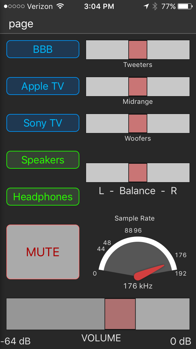

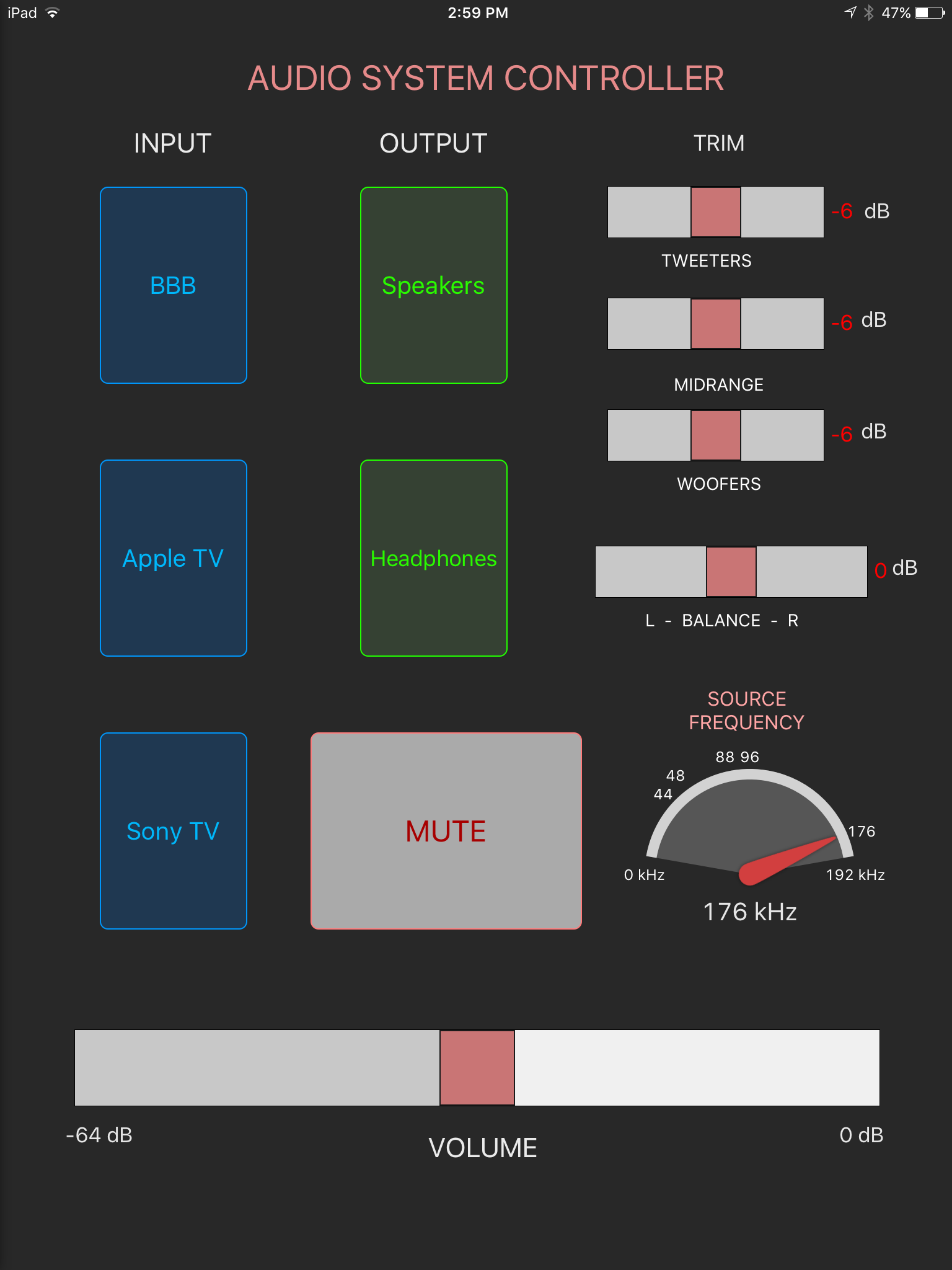

I have been pounding away with Python and now have a very decent remote system controller running on my iPad. In terms of the BBB, it uses a combination of GPIO controls/interrupts, I2C from both shell and python scripts, and the NetIO system using a python TCP server on the BBB. There are a couple of inputs (spdif sources) that must await Botic 6, but with luck they will incorporate easily. I hope to run them through the BBB rather than directly to one BuffaloIIIse because the BBB is also running a 3-way non-resampling LADSPA crossover. This explains the ability to trim each stereo Buffalo to shape the driver responses. While i was at it - making an old-school preamp at 48 bits - I threw in a left/right balance control. :joker:

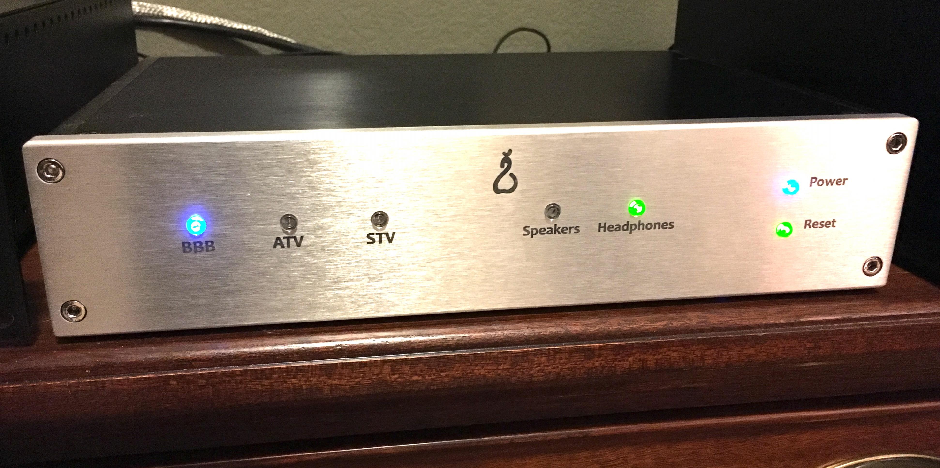

Several posts back are photos of the DACs and unfinished BBB case. I'm updating just to show the finished (2.5"X11") BBB faceplate with momentary buttons for 'manual' control (via GPIO). The buttons launch the same scripts as the input/output buttons in the tablet controller. My favorite little gizmo? the sample rate "speedometer"! 😀 At 176kHz it was playing vintage Brubeck.
The code to integrate the system all works but is a bit rough because I am not a programmer! I would like to have it reviewed by somebody knowledgable in Python. Best to optimize it, because it is now using subprocess calls with shell=True. I will post when that process is complete. If others will use the code, better to adhere to 'best practices' as much as possible. It is my intention to make all of this freely available because, when you start digging, the NetIO documentation is pretty sketchy.
Thanks @Kaskade. There is plenty of room for expanding these methods and making them suit others' individual systems. One thing that occurs to me is expanding the server to listen on more than one TCP port. For example, Squeezelite can be controlled from several sources at once. It would be nice if each could have volume control via TCP. ...but first I will work on cleaning up the existing Python code for sharing...
I showed the python controller script to a friend with significant Python saavy. He felt the code was good to share with the caveat that the TCP ports it opens are not very secure. I use wired internet for my BBB, so i have no qualms considering my other firewalls. I doubt that the "keys to the palace" can be found loaded into our Audio BBBs, but I would think about network security if I used this script via wifi in a crowded digital environment! 😉
I have moved to GitHub to distribute code: https://github.com/francolargo/BBB-audio/tree/master
The server that runs on the BBB is 'netio_server.py' and the controller file to upload to a Netio account is 'BBB_iPad'. I am not done tinkering and learning so I will keep the GitHub code up to date, with descriptions and comments here. I'd like an iPhone version that can run concurrently but its priority is low right now.

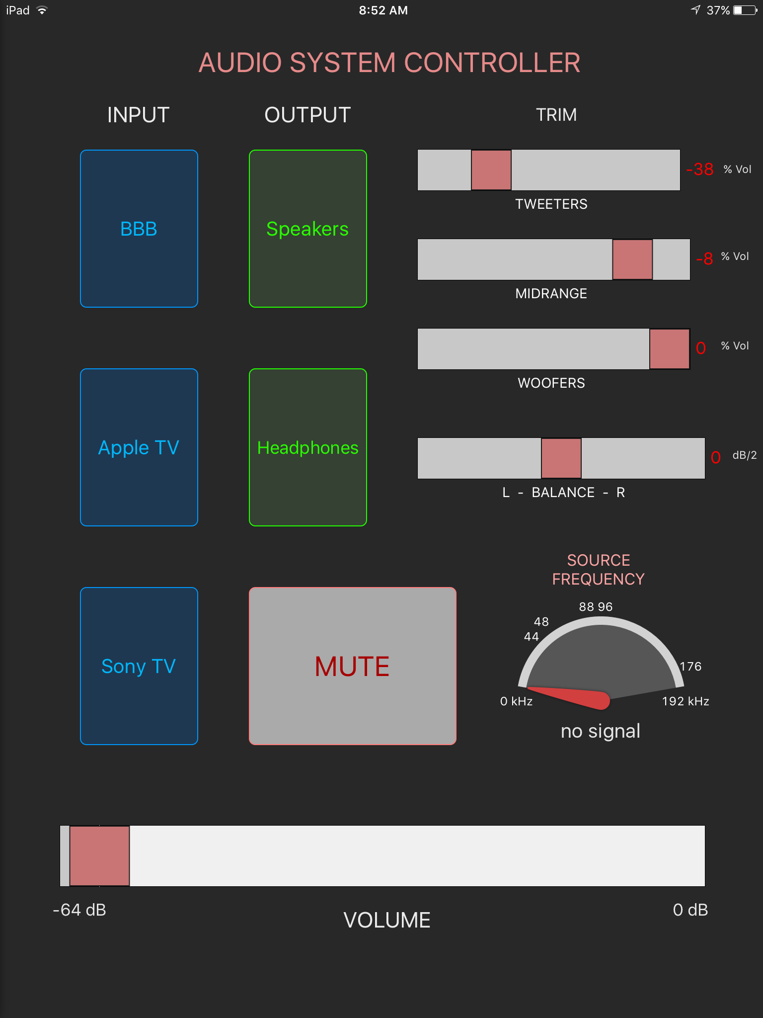

I have been testing and tweaking my 'preamp' functions in the Netio remote control for BBB/Botic. I find that the individual level adjustments for tweeters, midrange, and woofers are very convenient! I frequently make small adjustments to please the ear. Thus, on the remote control screen I made those trim sliders larger for easier access (example photo below). In addition I improved their function. Previously, each trim slider attenuated via an individual DAC master volume register, using absolute volume units of .5 dB. Things got messy at low overall volume settings where negative numbers sent to the es9018 are treated as positive.
Now the trim functions work as a fixed percentage of attenuation from the master volume setting for each of the DACs, so a master volume value of 0 (-64 dB) has no trim applied. This is now in the python script that is available on GitHub: https://github.com/francolargo/BBB-audio/blob/master/netio_server.py
...just a reminder: this remains a 'work in progress'...

Are you able to share some details on how you power up the bbb and reset it? Do you have power and reset buttons in place?
I'm also curious to learn which tactile switches with button caps you use? Or do you not use any because you are remotely controlling the device?
My bbb is still in my dac in dev mode, so the WAF factor isn't very high but i'm contemplating how i can integrate the bbb nicely in my chassis whilst still allowing to see the status of the device.
My thinking is that i would need:
- bbb pwr led
- bbb pw button
- bbb reset button
- hermes enable led
Looking forward to your thoughts!

Greetings, and I'm glad to offer whatever experience might help.
A quick overview - my build involves 3 DACs so it was most practical to separate the BBB/Hermes/Cronus from the DACs using the Teleporter modules. I also hoped to incorporate inputs from optical SPDIF appliances - that objective is waiting for further advances in the Botic system. In this context, I chose to include 'manual' controls on the chassis in addition to the software-based controls. If you look at the small chassis pictured in post #23, each of the momentary buttons is also an LED. [source] The LED function is independent of the switch function.
Each of the 4 functions you indicated are easy to implement. The power and reset momentary buttons are simply wired into the appropriate .1" headers on Hermes (they are labeled J_P_SW and J_RST respectively). The LED indicators are fed by the EN and "1" LED driver connections. This setup requires no special software - Russ, Brian and Miero did the work for us! 🙂
As for power, I do have separate switches on the AC inputs to the built-in power 2A switched and 5v linear supplies for the BBB and Cronus. Sometimes I like to power the BBB even when the DACs are not in use - convenient for development work etc. The NetIO remote control is not capable of powering up the BBB, so the 'manual' power button is useful.
Convenient though the lit momentary switches are to use, they are a bit of a pain to wire up because their contacts don't easily fit 0.1" perf board spacing. If you look farther back in this thread you will see the mounting boards I etched in order to make the front panel switches work cleanly. I'm sure that simpler options exist. The 10mm-thick front panel required to be milled in order for the switches to protrude an optimal amount. BTW, the front panel lettering was laser etched at a trophy shop.
Feel free to ask more questions, try out ideas, etc. ...and post pictures! 😀

  • You mention "The LED indicators are fed by the EN and "1" LED driver connections": do you mean that you've soldered these leds to those places where normally the row of four green leds go on the Hermes? Or have you found separate header locations for these?
On Hermes I simply desoldered the two on-board LEDs and installed pin headers. Then ran the wire out to the front panel. The advantage of using the Hermes on-board connections is that most LEDs will draw too much current if connected directly to the BBB header, which is controlling when they are lit. But the EN and 1-3 sources are obviously safe. [My experience running LEDs via other BBB pins generated posts 2-5 in this thread.]
  • You also mention that you have separate AC switches for both the BBB and Cronus. This makes sense, but I assume these only serve to bluntly cut AC power away from the power supplies? Once AC power is being fed to the power supplies I assume you can use your 'normal' power button connected to Hermes to power up the BBB?
Correct. When all is off, energizing the 5v power supply to the BBB also starts the boot cycle. Occasionally, when testing new settings, I find that a simple reset doesn't fully recycle the system and a cold restart is needed. So having both reset and power buttons has helped me.
