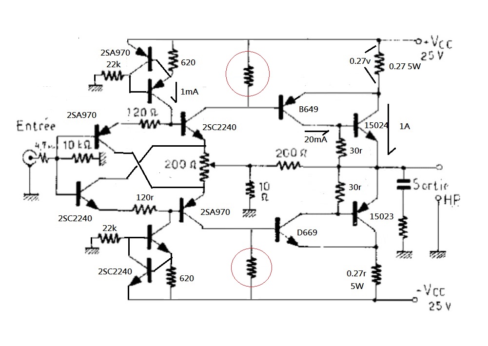

I constructed several Class AB amps before but never construct a real Class A amp, it is because Class A amp needed big heatsinks and high volume of power supply caps stop me.
Now I start planning to construct a 20W Class A amp, I want to use a pair of TO-3 power transistor 15023/15024(I have stock) per channel.
The reference Amp are Musical Fidelity A1 and Jean Hiraga 20W, I prefer Jean Hiraga amp more.
The Class-A Amplifier Site - Hiraga 20W Class-A
I want the amp with temp stable and balance in performance. For the Jean Hiraga schematic, I changed the 9v zener diodes to a transistor current source, I think it is more easy to matching 2 channels difference than using zener diodes, I changed the thermal resistor control to a Vbe multiplier and install it near the power transistor to compensate the temp.
I don't know how to use those simulation software, please help me and advice if the above change is suitable or having good ideas to construct the amp.

The VBE multipliers is a very bad idea. You are reducing the open loop gain heavily without really gaining something.
Ok, I got your meaning. I will remove the VBE multiplier and change back to resistors.
I saw there is a thermal resistor in the schematic and I saw one Class A amp project which attach a thermal resistor to the output MOSFET, I though this a kind of thermo control, so that raise this idea of using a Class AB amp VBE multiplier here.
Thanks,
