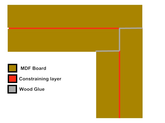

To be clear, I'm not talking about building a box then adding something inside. I'm on about the actual construction of the box itself... The whole thing would be made from 2 layers of MDF with the goo in between them. At least that's what worked the first time around. The actual constraining layer was something like 1/16" thick.
A visual might help here...
The thumbnail shows how I was thinking of building and corner joining the box...
- constrained layer damping with MDF and Ply
