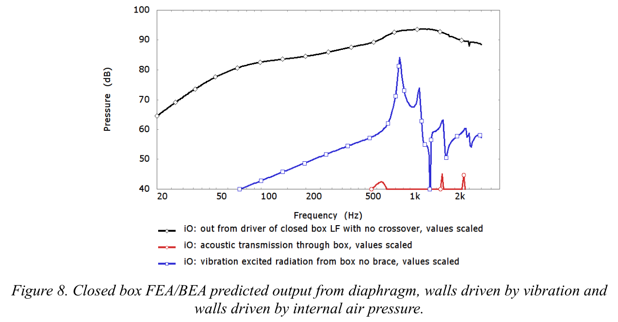

My recall is that I read it in posts by "Speaker dave", his bio says he worked for KEF so makes sense it's in that white paper.
Not sure if he was still at KEF for the LS50, but he's definitely made a lot of posts about damping cabinets & decoupling drivers.
Anyhow, I skimmed the LS50 whitepaper again, and it does cover this well. Their sims indicate that you can ignore air pressure effects until you've decoupled the driver. Example attached. Worth a (re-)read.
I overstated.
I think it's a fair point to raise and at least check.
Art didn't claim any absolute measurements, used for comparison.

Earl says the fundamental mode dominates, Art comments that this was not necessarily the case, to his own surprise.
I dimly recall a claim that the Newtonian reaction force of the driver was the main cause of vibrations rather than the air pressure in the enclosure.
I don't recall the author except that it was someone with some credibility, which is why I took note of their claim.
Anyone remember the thread or author?

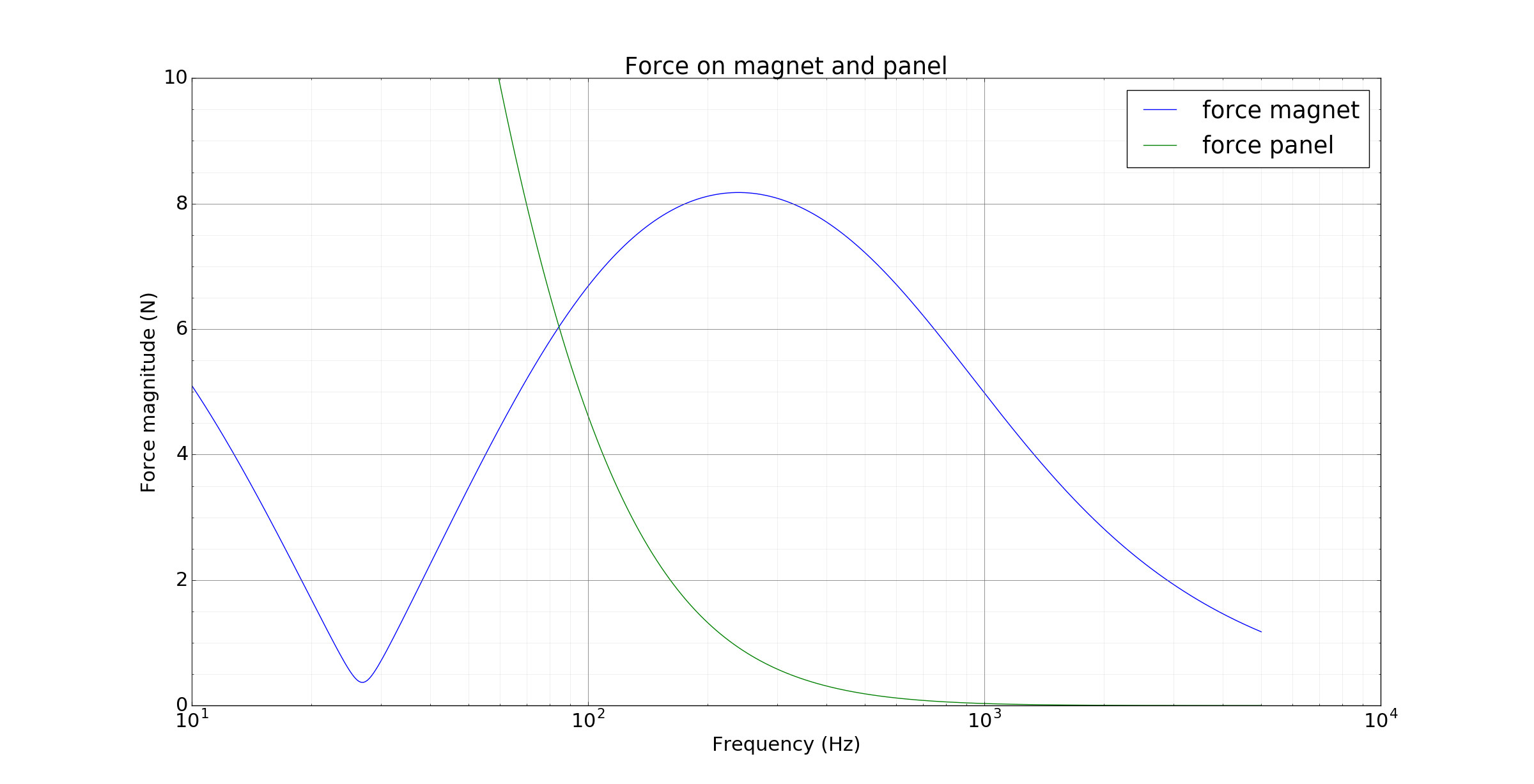

I don't know about people but just about every FE simulation of a speaker cabinet which includes the internal air pressure (it is often dropped) will show it to be small-to-negligible at the frequencies of the lowest cabinet modes compared to the forces from the driver hammering on the baffle. The figure below is from some working notes for a subwoofer with a small sealed cabinet which has perhaps the largest internal forces relative to the forces from the magnet. The resonances start at around 500 Hz but are shifted mainly higher in frequency by various design modifications. The lowest pair of resonances (2 symmetrical modes) are not really driven and would radiate weakly to the listener even if they were. It is the mode above which is the nasty one.
BTW speaker dave has worked at plenty of speaker companies but is US based and I don't think he has worked at KEF here in the UK. Andrew Jones used to work at KEF and has posted here about cabinet vibration.
Placing particles on panels to reveal standing wave patterns is of limited practical use. As mentioned by someone above, Earl I think, the lowest and most problematic modes tend to involve the whole speaker bending and not higher order panel vibrations. These obviously do occur but normally at frequencies sufficiently high and weakly driven and/or radiating that they are not a practical problem. An exception might be something like a large thin walled cabinet with no bracing so one cannot be absolute about it.
