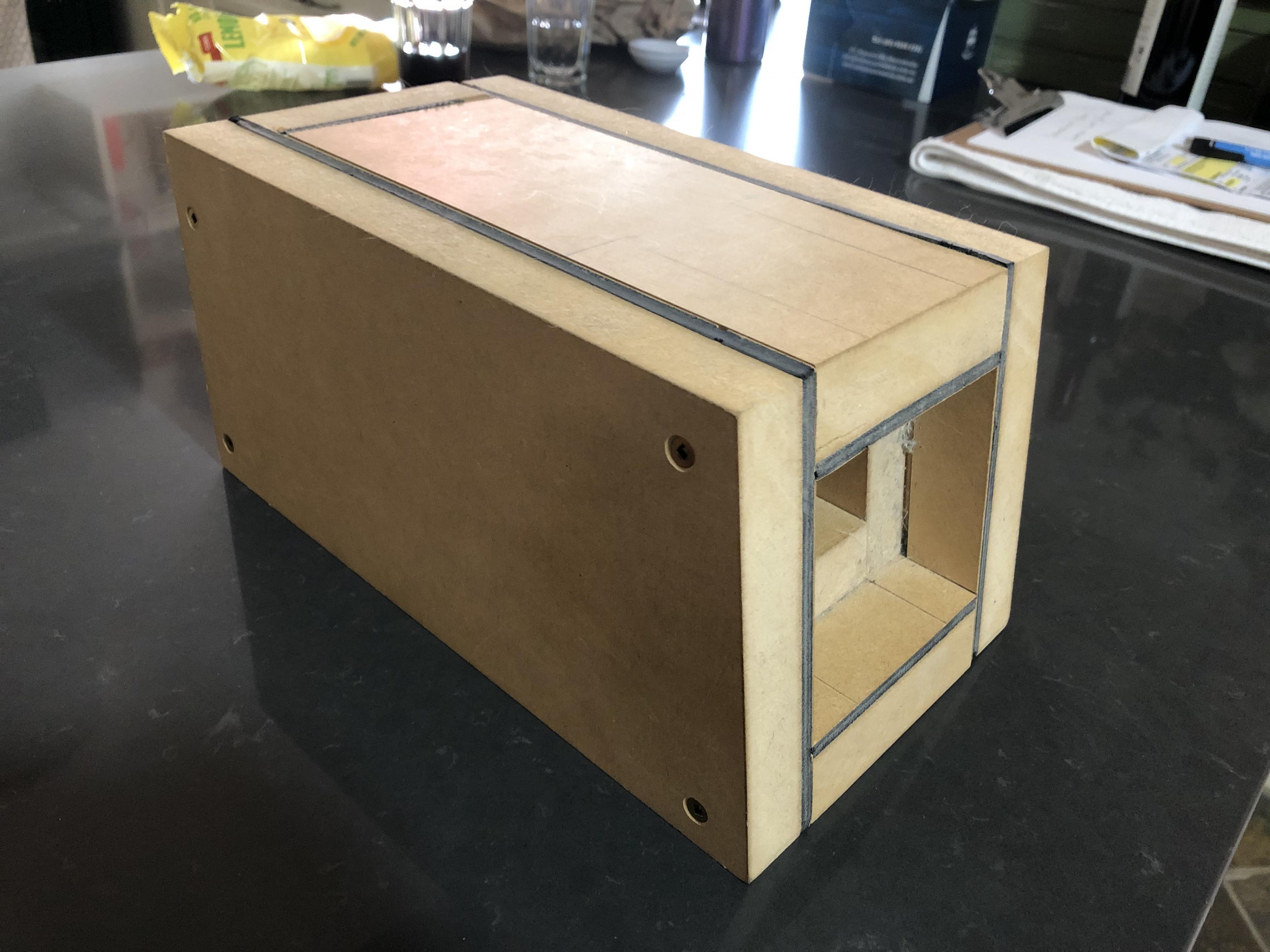

3-way active, time aligned, constrained layer constructionThanks for the tip on thickness, I'll look at the trowel. I assume it would be finest tooth trowel I could find? Obviously my tile trowels won't fly!
No, I'll be doing a constrained layer. I'll start with typical construction as in the pic, and compare MDF vs various grades and thicknesses of ply (also taking suggestions on what else to use), then I'll move on to lining damping material on the walls (can't remember what I have but it was a top performer over at diyma when they did this sort of experiment), then coating the inside with AcoustX and mix of caulk and glass microspheres, and lastly some constrained layer stuff. When I do CSL I want to check both wall construction and bracing and see how they differ.
Many of the issues discussed in this thread were addressed in the above build report. The even distribution of the damping layer is solved by a heavy duty press and extrusion approach as detailed in post #13 of the link. I put together a mini-me model (below) to illustrate the fitting of the panels to achieve a box-within-a-box construction. Interestingly, the damping layer is still compliant after 8 years. I have never succeeded in pulling even the smallest panel sample apart. The split in the mdf is due to a screw holding the panels. There are no screws in the actual build. Even though I have built many enclosures since, this is my favourite and best performing. It was a challenging build.

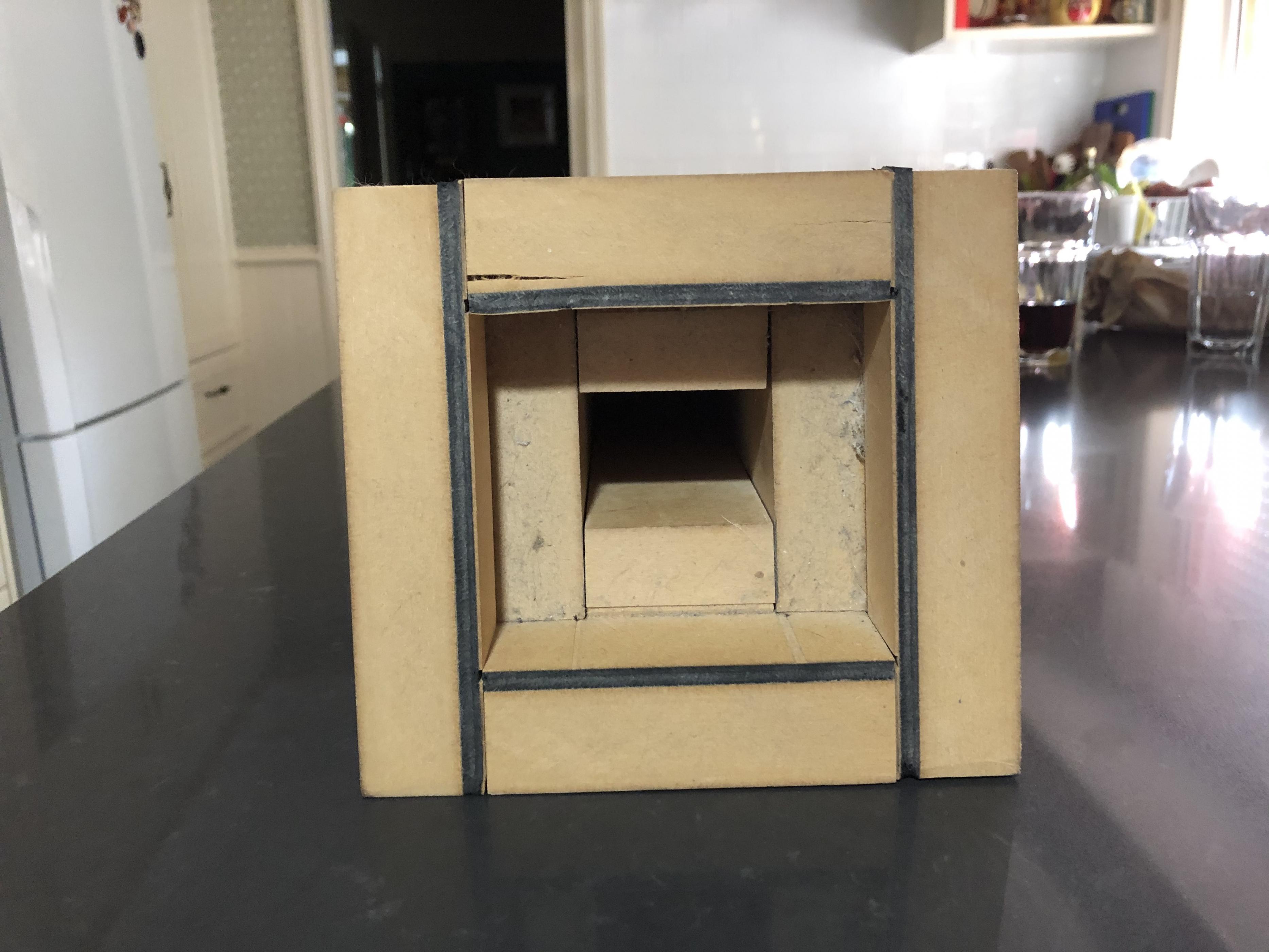

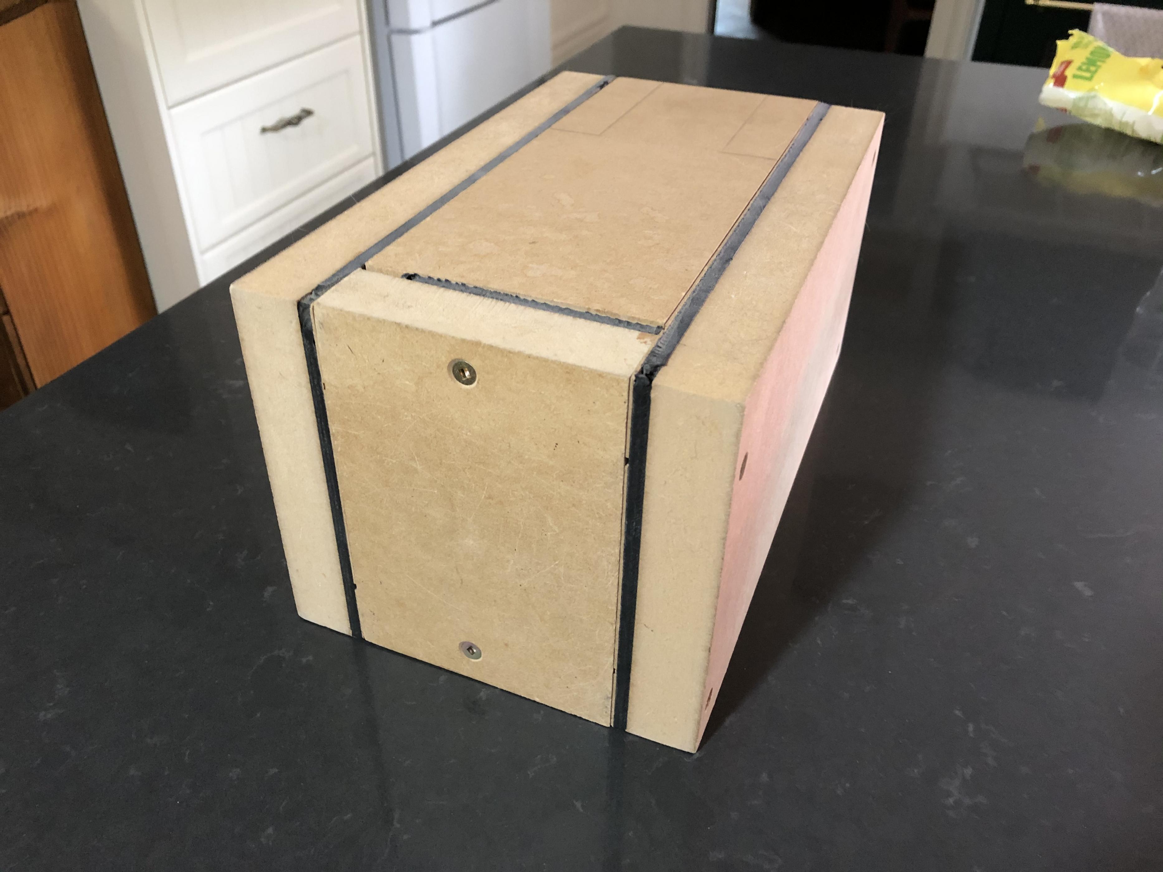

When I did the constrained layer build in 1979, I pre-cut the panels to size and positioned them before mounting into my cabinets. To get the silicone layer even I used a small grouting trowel, then placed strips of 1/8" plastic at the corners while clamping and curing, to keep the thickness I wanted. Finally I assembled the cabinets by gluing, using a joining technique much like yours. The overall wall thickness was 1 1/8" and they weighed a ton.
There is a picture in one of my earlier posts. It was pretty ordinary looking, as speakers go, but yeah, like you said... best result. The sound from them was pretty amazing.
For this new build I'm contemplating a very similar construction. 2 X 3/8 mdf with a 1/8" silicone or decidamp layer between.
