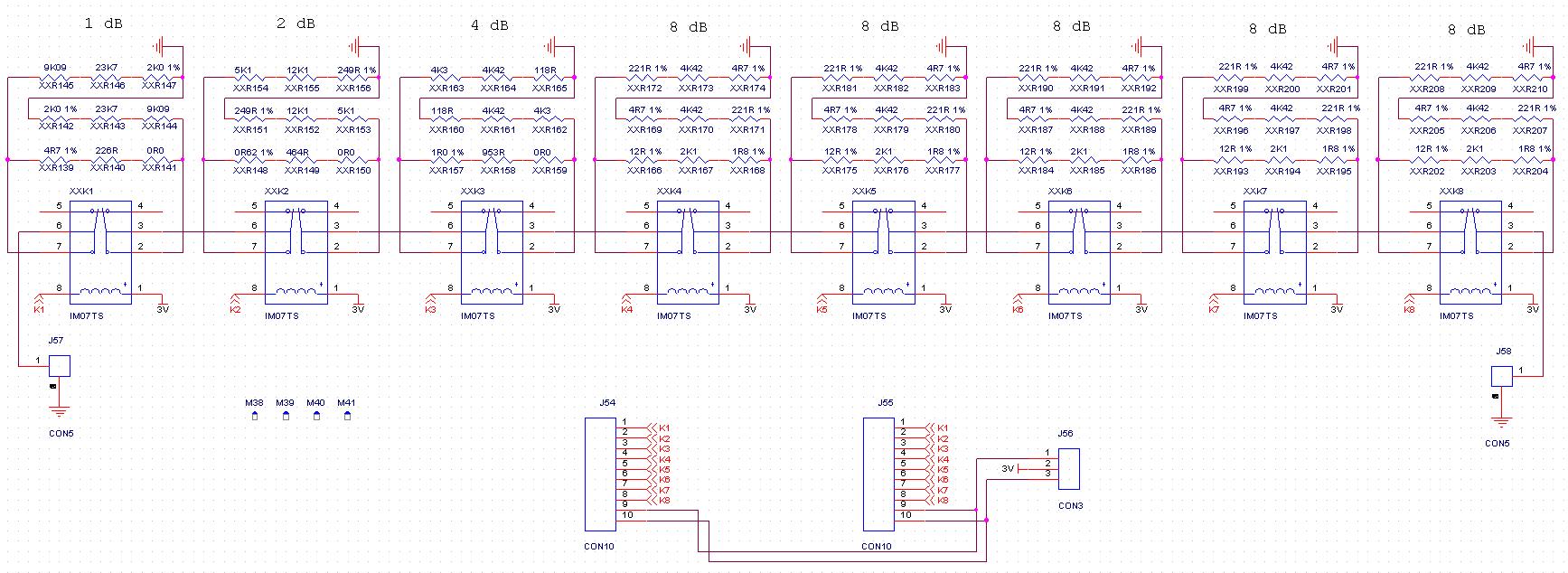

Took some modems apart at work, before they were thrown out.
Got 6 nice omron G6A relays from them. Had a look what to do with them and bingo 😀
Replaced the alps blue pot with motor in my preamp, still just as a test. Works great, think details have improved.
Next job will be a new controller pcb with relays integrated.
Have some clicks during switching now and then. Any switching order possible to prevent these ??? I now just step 1dB by setting the new value.
Guido

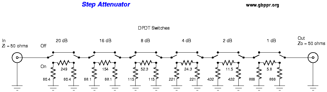

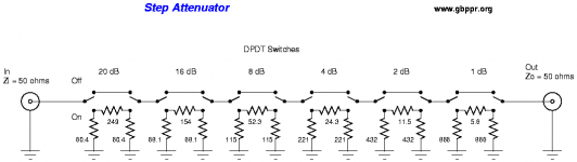

For completeness:
If BOTH ends must be constant, for at least 90 years there has been a standard plan, like the attached.
The plans in this thread give-up the constant Z both-ends to get *half* the number of switch actions. In audio we can usually do that. Gain (impedance changes) is cheap.
This particular plan is valued for 50 Ohms. Scaling to another standard is trivial.
> if I want Constant source impedance....,if I want to Constant output impedance,
For completeness:
thanks for you sharing.would you please share how to calulate if both ends constant for the 100K/50K?
