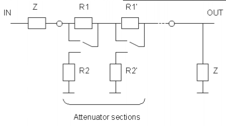

Brian Guralnick said:I want to exactly reproduce the device on the right side of my illustration. The image on the left is missing 1 resistor & it supposed to illustrate how the original schematic works in post #1 of this thread.
Brian,
it is incorrect in your drawing. Essentially inside the attenuator resistors are switched to the ground as well, providing for a "lower" part of the "pot". So in essence for any given attenuation you can replace the lot with just two resistors, same as you can do for a normal pot. My circuit will work OK without the precise load, just in this case the input impedance and precision of steps, especially for small attenuation values, will be affected.
Cheers
x-pro.

But I did not invent the attenuator myself: I was triggered by the design of a thick film hybrid that was available in these days. It took me some time today to find it back, but I still did have some samples in a drawer. It was the CDG4469 from Topaz Semiconductor. This hybrid contains a single channel 256 position attenuator. Each step is 0.5dB, so it has a 127.5dB range. If I remember correctly it uses DMOS switches and calibrated thick film resistors. I used to have a databook of Topaz, but some 5 years ago I dumped some shelves of databooks, since everything is on Internet now. Why waste space? Regret, regret.
Topaz does not exist anymore, and nothing can be found back on the web about their products. So, if someone has a datasheet left, I would appreciate. Anyway, the production date on the hybrid is 8652, i.e. week 52 of the year 1986. This means the whole idea of the log attenuator is already quite old.
A bit more searching in some old piles of paper even revealed how I calculated the resistors in the chain. The datasheet of the CDG4469 only showed a basic diagram how the thing was build, but (of course) no resistor values were given. I had to derive the formulas myself. I will not show the complete calculation, but at the end of the page it shows:
If K=gain of one section, expressed as a value between 0 and 1, and Z is the typical impedance of the circuit, then the series resistor to the next section R1= (Z/K)-Z and the shunt resistor to the ground of that section, R2=(Z*K/(1-K))+Z.
Example: Z=1000 (1kOhm) and K=0.5 (-6dB), then R1=1000 and R2=2000. The source impedance that starts the ladder is 1000 and the load impedance should be 1000.
Take note, that even with all pass switches closed and all shunt switches open, the gain is still -6dB, i.e. 6dB attenuation, just because of the load impedance loading the source impedance. This kind of circuits does not have 0dB pass gain. One -6dB section in combination with proper source and load impedance gives -12dB if activated and -6dB if not activated.
One last remark about the CDG4469: it used the L-type attenuator sections for all but the most significant bit, the 64dB section used a T- or PI- attenuator, probably because otherwise the ratio between R1 and R2 would become too big for a thick film circuit. The characteristic Z of the CDG4469 was 650 Ohms.

Hi Steven,
thanks for the information. I was somewhat suspicious that this circuit is (as usually the case with something that simple), a forgotten old idea 🙂 . On the other hand I am quite happy that in this case there is no possible problems in using it now. Just as well I'm no longer working for Creek 😉 .

Well, I sat & thought, thought some more. In actually, both yours and my circuit would end up doing the same, except, mine is 2x the stuff. It would be like putting 2 log pots back-back, the only gain would be the perfect mute & maybe, some difference in load effect in the above 10Mhz range. I guess I would be better off adding 1 last relay for the full mute.
Thanks for beign patient & answering my questions. I've managed my battery powered attenuator PCB layout to conform to 4 different POT methods, including this 1. It's done just by changing the value, location, & orientation of the SMD resistors. If you want a few blank PCBs, email me privately.
Now, to play with the equasions in promethius' earlier post.

Hi Brian,
There is no need to use such accurate resistors. Normal 1% resistors will do. Suppose an MSB of 32dB, then 1% resistors make an error of approx 0.2dB maximum, which is probably less than your LSB, that will be 1dB or maybe 0.5dB. So 1% resistors keep the volume control still nicely monotonic. 🙂

Oops, I wish I'd seen AMT-freak's post earlier... I derived all the formulas by hand for this... 🙄 Oh well. Just a word of caution: I believe the formulas on Steven's diagrams are incorrect. Please double-check before you use them.
