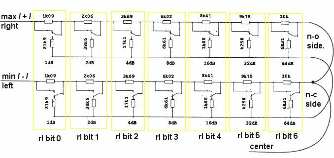

Ok, I've adapted this pot to simulate a true single-channel pot. Now, any output load & any input load is usable. Also, a volume of 0 is now - (infinity) db. 127 will be -0.000000 db.
I've boxed the DPDT relays. The top half is wired to the n-o (normally open) side, and the bottom is on the n-c (normally closed).
I know it's double the resistors & double the switches, but, I want an authentic emulation of a real logarithmic pot.
Will it emulate correctly?
My circuit in a first message IS a correct emulation of a log pot. If you want a balanced version you wire two in parallel - one for "hot", one for "cold" input and take two outputs as well. Your idea on that diagram is not quite clear to me 🙂 . However it would make sense (and I've done it in production) to wire the relays in "max" attenuation position when there is no power to the relays (opposite to what is shown on the diagram from the magazine).
x-pro
This is what my circuit does. I wired 2 of your pot's, back-to-back, 1 upside down, in parallel, taking the attenuation point from the middle.
(To make it clear, I'm not talking about XLR Balanced, from here on in, Im talking about a single, mono, 1 channel pot.)
Your pot only emulates the left hand side of a log pot, this is why it needs an output load. See attached illustration, hope my art isn't too bad & I got it right.

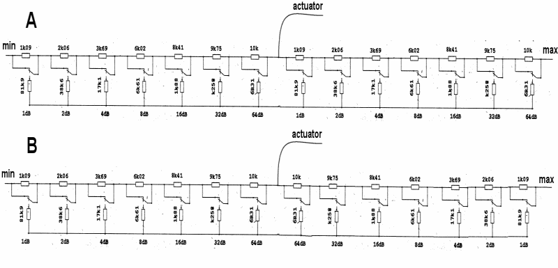

x-pro, when using your exact schemtaic, what values of resistors should I use if I wanted to add a 0.5dB step? I'd want to add an eigth bit for more precision, and since most logic can be found in eight bit versions, it'd be a waste to ignore that extra bit.
OK, which 1 is correct?
A, or B.
It is understood that the switch positions on the right hand side of the Actuator are inverted to the ones on the left, changing the same -db # switch on each side at the same time as 1 bit.
Also, now, only the ' Min / Actuator / Max ' make up the 3 external conections available on a normal pot. The bottom trace is only internal now.
Right???
My battery powered attenuator is identicle to the 'B' version in my last post, I'm only missing the bottom trace with it's resistors. I'm adding that bottom trace & it's resistors right now. Version 'B' seems to visualize correctly for me.
My goal is to make a log attenuator with -128db attenuation in 256 x 0.5db steps.
