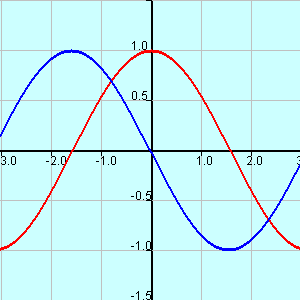

blue line = sine wave representing odd symmetry
red line = cosine wave representing even symmetry
It`s fundamentally about symmetry and time.
It´s hard to comprehend the inner nature of things from explanations, where terms like "eliminate", "reject" and "cancel" are used to describe physical processes. You can possibly cancel your wedding or air flight, but in physics, nothing can be eliminated, rejected or canceled. Likewise, once arisen, distortions will stay in the system. Conversion is a possibility, though, at the price of higher complex distortion; now, you may like the sound better that way, but that´s not a subject to discussion.
The symmetry of the output signal waveform reflects its harmonic content as a consequence of function symmetry f(x), which is an important nonlinearity measure. By an odd function f(x), points of even symmetry in the input waveform become points of odd symmetry in the output waveform. In other words, an odd function f(x) converts symmetric input waves into asymmetric output waves resulting in an absence of even order harmonics. It´s exactly what balanced topologies do, obviously originated in the two-input / two-phase operation, causing the time error.
Tubes really shine in this regard (as well), displaying a nearly ideal function f(x), (only in single-ended mode), due to a small time difference between input and output (and a fast response to a change in the signal), giving a peerless sound stage. Despite of that, the impairment effects of balanced operation are unmistakable.
So it is pure trigonometry, not depending on device technology.

The mathematical function f(x) can have even, odd or neither even nor odd symmetry with respect to the y-axis. A mathematical function is the very best way to express and explain device transfer function linearity, or in this case, to show a difference between the single-ended and balanced function.
