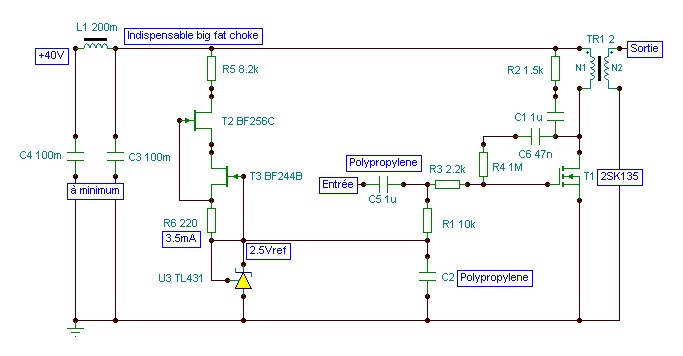

Hiraga`s nice Nemesis. Transconductance amplifier with good V-I proportionality. Effective and gentle CLC filtering, here active current source for less ripple at the sensitive gate.
C3 = 100 mF
C4 = 100 mF
Are nice and big really compatible ?
The amp called "single-ended push-pull" in post #97.
I think SEPP refers to another topology. This amplifier
has often been called "balanced single-ended", a phrase
I first saw used by Bel Canto describing one of their
amplifiers.

apply a test curent source across the load terminals - the voltage change divided by the current is the impedance
in LTspice this can display the .AC analysis plot in Ohms with a phase - use current source AC = 1 A even if the circuit wouldn't handle 1 A - spice linearizes the circuit and isn't really "simulating" in .AC analysis, just plugging the frequency sweep into the Laplace small signal linear model at the operating point
need a good transformer model to capture its bandwidth limitations
