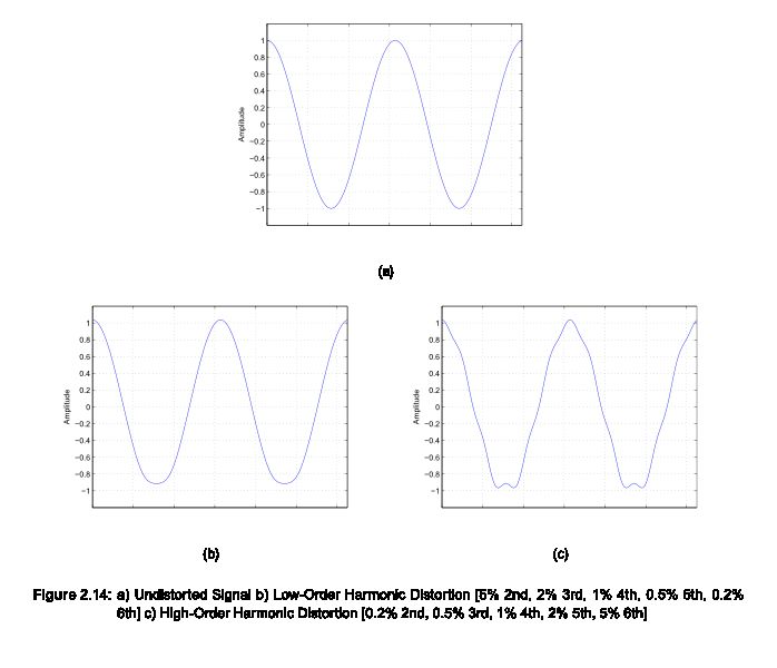

Same THD level in fig. (b) and (c)
We can expect seriously clipped waveforms from the blameless amplifiers due to a high content of high- and odd-order harmonics.

ANY clipped waveform has a high content of harmonics.
If you by "high content of harmonics" mean high content of harmonic distortion products, then that content in fig. (b) and (c) is the same, yet the waveform in fig. (b) is not clipped, showing that clipped waveforms do not necessarily have a "high content of harmonics".
Your reasoning is in error. What is shows is that waveforms can have a harmonic content without being clipped. Which is opposite to what you say. It is also something that is trivial and well known. Still no point?
jan
We can expect seriously clipped waveforms from the blameless amplifiers due to a high content of high- and odd-order harmonics...
...the caption is correct...
Then if the caption is correct, you aren't. The waveforms have enormously different harmonic content. And since, experimentally, "blameless" amps don't show waveforms like that, your hypothesis is falsified. That's the point at which the honest practitioner says, "Oops!" and tosses his hypothesis into the trash.

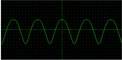

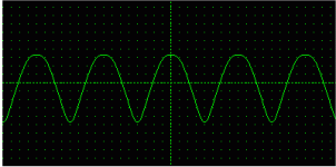

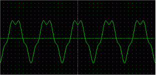

WuYit's B and C seem to be the same even order products. In my tinkerings , hooking output stages to electric range calrods , I have seen these non-linearities in the voltage stage (VAS). To make the point , he left out what a odd order non-linearity looks like.
Generated with this applet : Guitar Distortion 101
(below 1) = H2 added to fundamental. (WuYit's B)
(below 2) = H2 and 4 (WuYit's C)
(below 3) = H3 (odd)
A clipping output stage usually does not just contribute these lower order components. A "sagging" OPS with insufficient current gain will , by loading the VAS. (done this with my CRO and calrods). Switching distortion and clipping are rich in higher order products. It is real interesting to see what TMC does to each of these shortcomings in a blameless. 🙂
